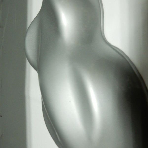

Here's a silver. The description says it's a silver metallic high gloss, but the image doesn't show that.
Plan is to do the Blue for the cab hood and north of the body line and again at the lower part. Similar to what Dustin has. The silver would go down the middle.
What do you all think?

I like it. I'm a big fan of silver and grey.

I like that Blue and silver.

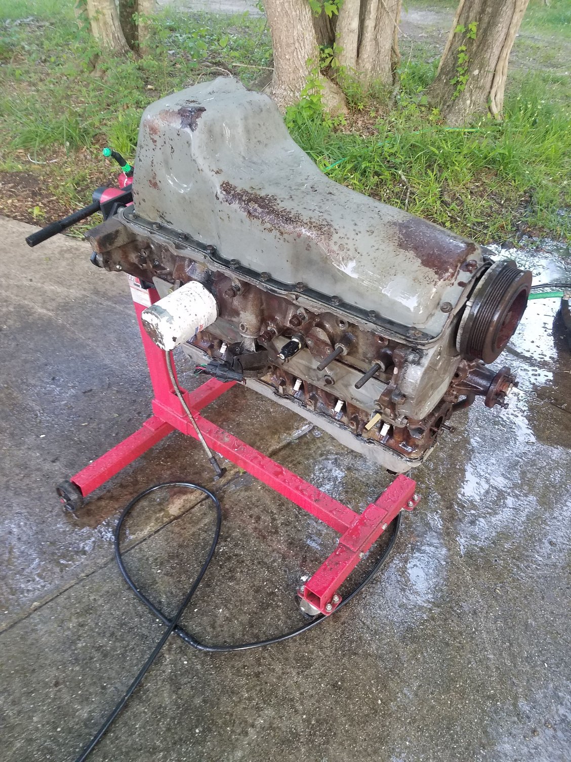

Well final got the engine degreased. I used about 4 cans of oven cleaner on it, plan on pulling the valve cover to do rocker arms, and oil pan to clean that and reseal it.
