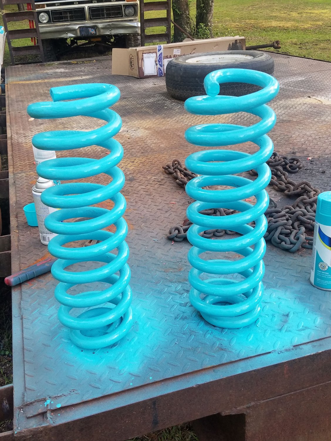

Got some paint on the springs tonight... see how long they stay pretty like that.

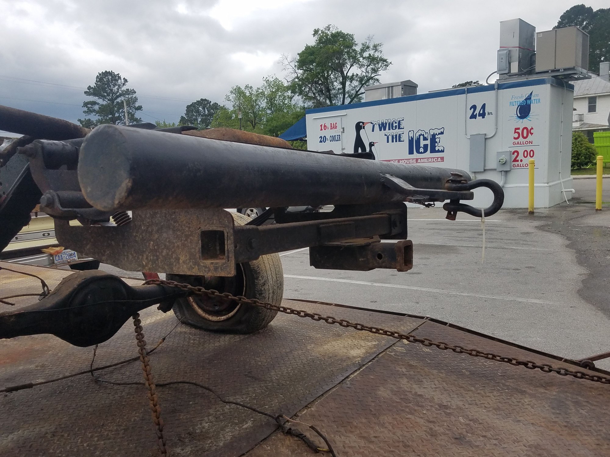

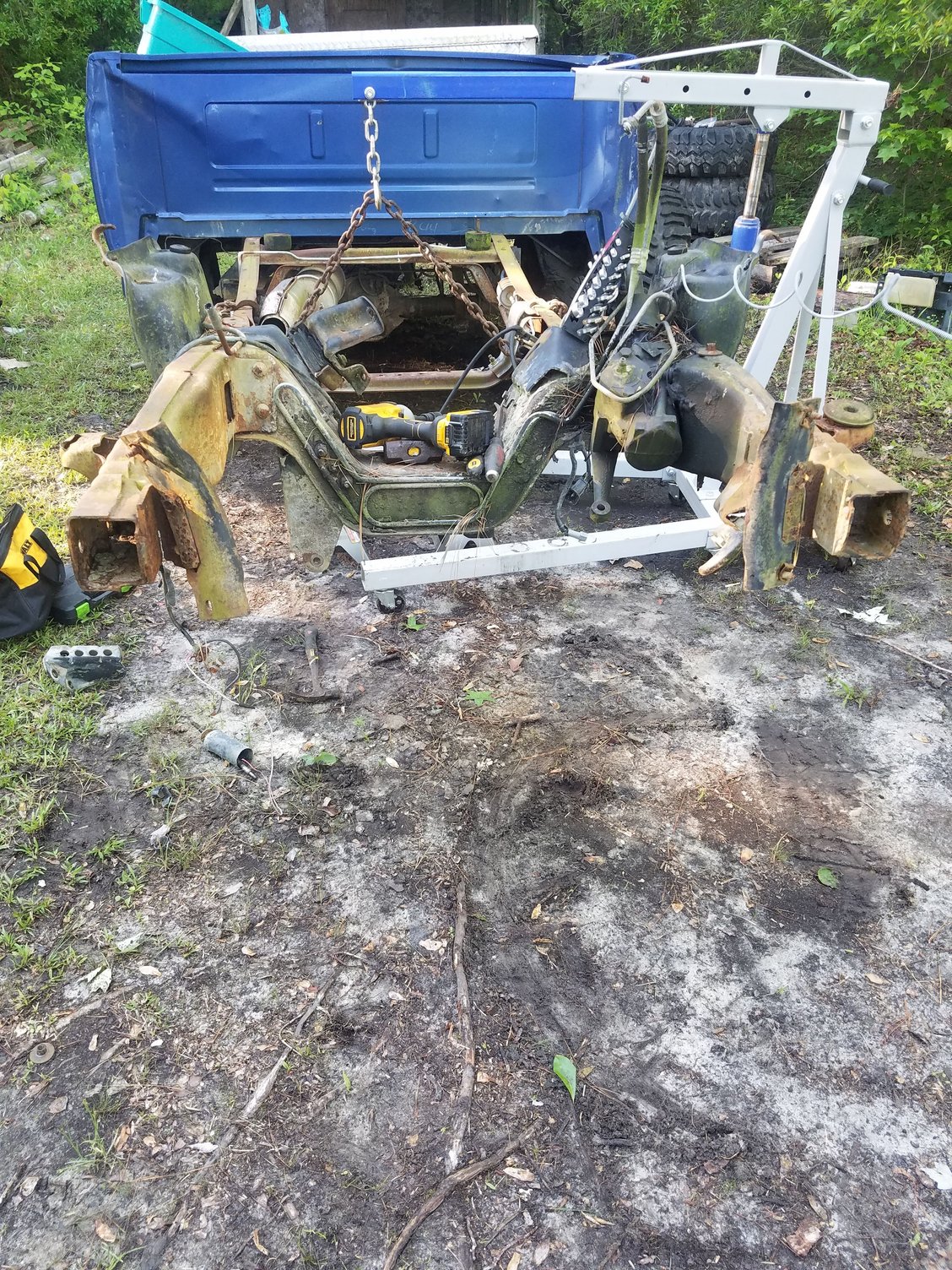

It doesn't look like that anymore... I have de axled it.
Also I believe this tube bumper is going to make it in the 96, I believe it will make a nice pull bumper.

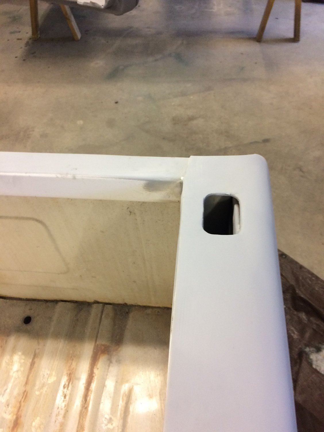

also: here is the bed corner that james and Kurt worked hard to reinforce. All cleaned and sanded. Almost ready for color.

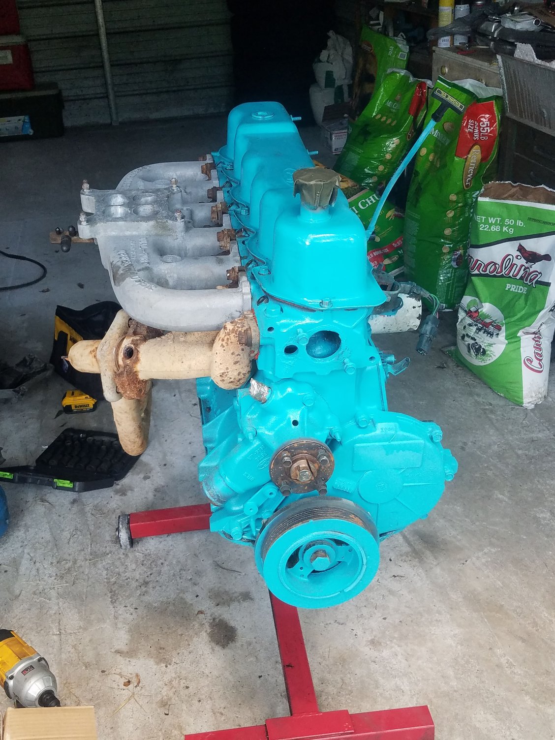

well today I sat out to do the SAS, but ended up not getting far do to finding out the 4" lift springs weren't truly 4". I'm guessing 1.5" level springs. So I ordered a set of deavers 5" super Flex springs for it, I'm the mean time the axle is in place just need to get the new springs in a punch a few holes in the frame for radius arm mounts. So I started putting the motor back together.
so here is a few pics of progress, and the springs I ordered.
