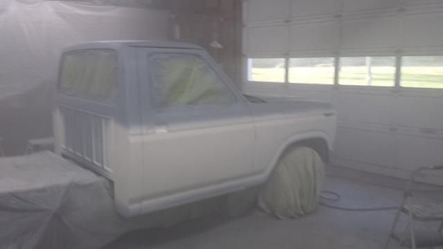

WE HAVE PAINT
Still a little fogy from over spray.
It was a long day 3:30am start and lights went off at 7pm only stopping for breakfast and run the trash to the dump.
This all almost did not happen. When eating breakfast I heard a loud pop followed by a loud hiss.
Went running out to my garage to find the 3/4" pipe blew out of the air dryer that leads to the air system piping around my garage. It is a compression type fitting so an easy fix but 80 gallons of air @ 180 psi blew a lot of dirt around. Good thing I was still sanding so was not too bad.

More paint!
Sorry the pictures are not too good it was hot and I wanted to get out and I am hurting from 2 days of painting.
It has a little dirt on the hood. I had the air hose leaking half way thru the last coat and had to throw the hose outside to fix it and the door opener shook the dirt down.
It is now baking as it must be 90* in there!
Got done just in time as the wind is kicking up and starting to rain.
Tomorrow I will pull the rest of the paper off and see about prepping & maybe painting the bumpers. I did not want to do them before I had a safe place to put them and now I can put them on the truck.
I also need to get another gallon of red paint for the bed, it took the full gallon just on the cab already told the banker I need $200+ for it.

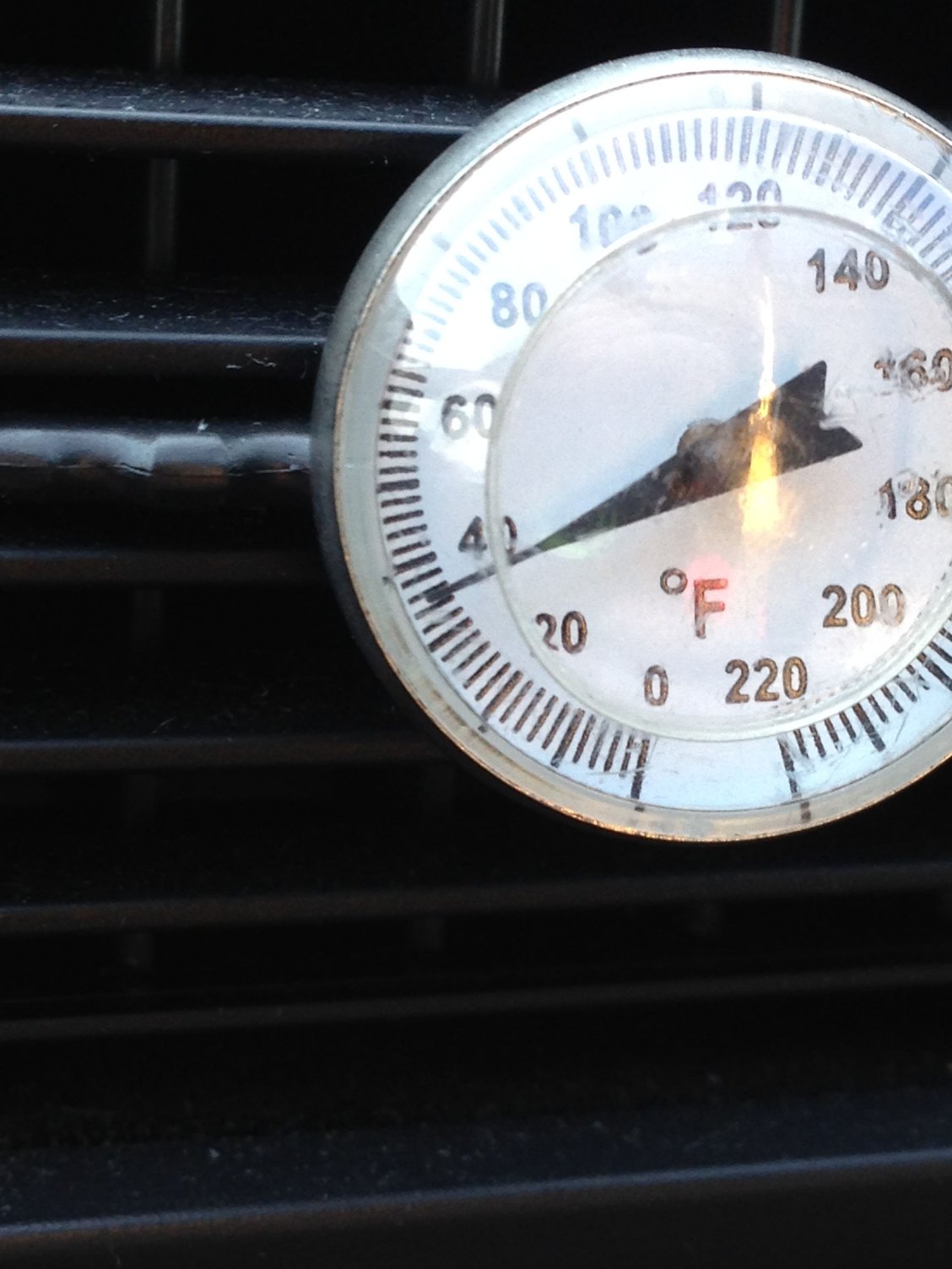

Replaced the oriface tube in the mustang today and refilled the system hoping itd fix my ac system and get it to stop tripping the overpressure valve. Turns out the oriface tube was my problem the whole time since replacing the compressor 2 summers ago. Now its blowing cold again. Cant complain that it blows 35* on an 87* day
Brilliant Result!

Originally Posted by Ug666
Brilliant Result!
agreed... all black car ac is a must in hot summer sun...
