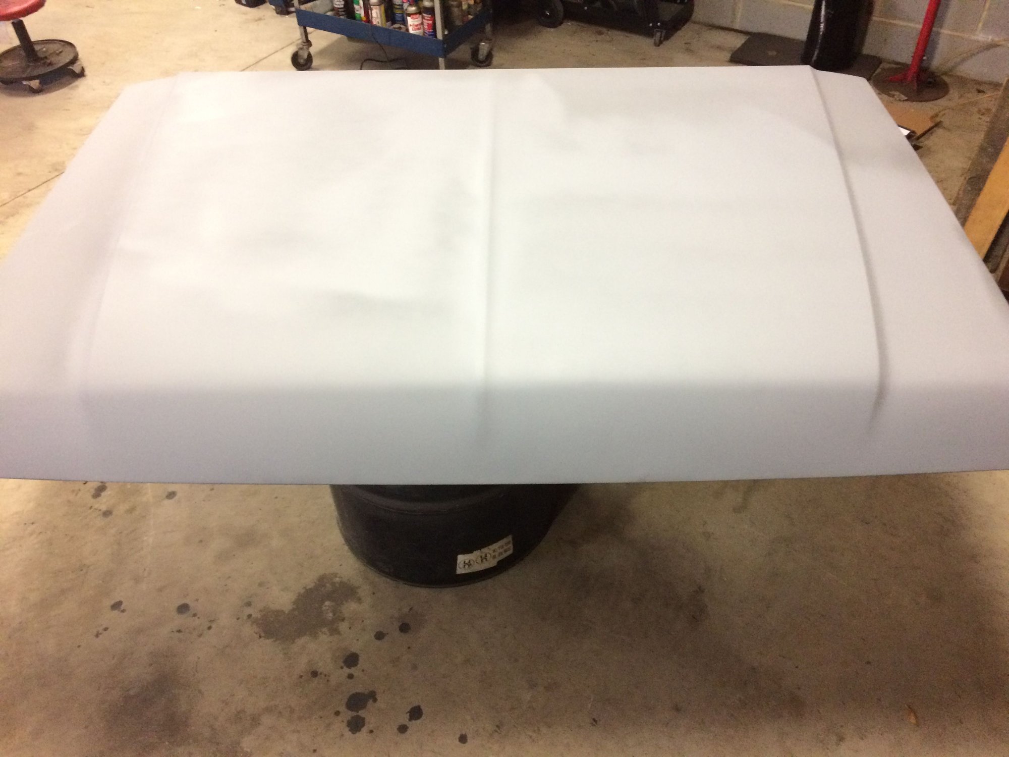

YESSSS I think I have east wood disc's arriving today so that was the plan of attack for the roof. I'm going to keep going on the cab until I'm happy. I'm not a perfectionist and this is the first time trying body work, but it's relaxing and I'm really enjoying it, particularly when it comes out looking good. Like the bed for the most part. I'll get it all blocked to 320. I hope anyway, I'm getting ansy to start spraying some color.
I'm using a 2k primer that I believe is high build. Sands great. I think, like you said, it went on dry on the hood, so I'm not sure if I have to redo that. Right after spraying it was covered in 'dust' of some kind. I've done about 3 coats of primer on everything with block sanding each one.

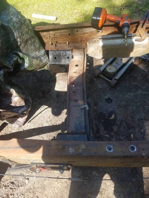

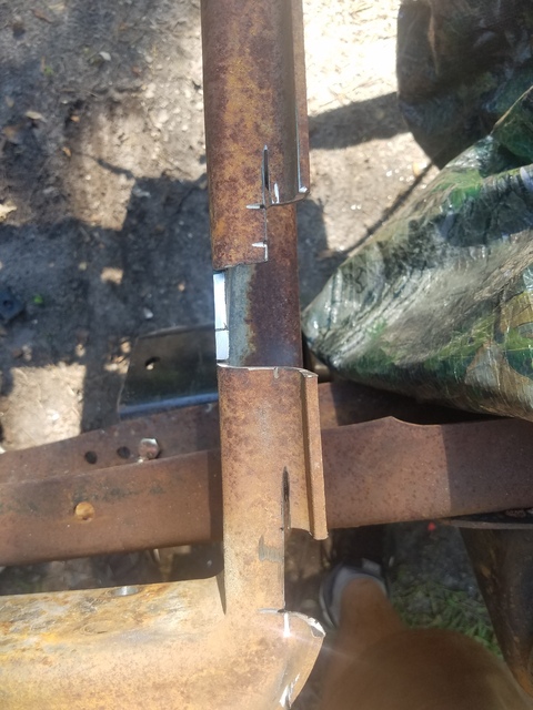

Well I got the transmission crossmember trimmed, and bolted in today. Hope to have the transmission in, and maybe even set the cab on this weekend maybe...

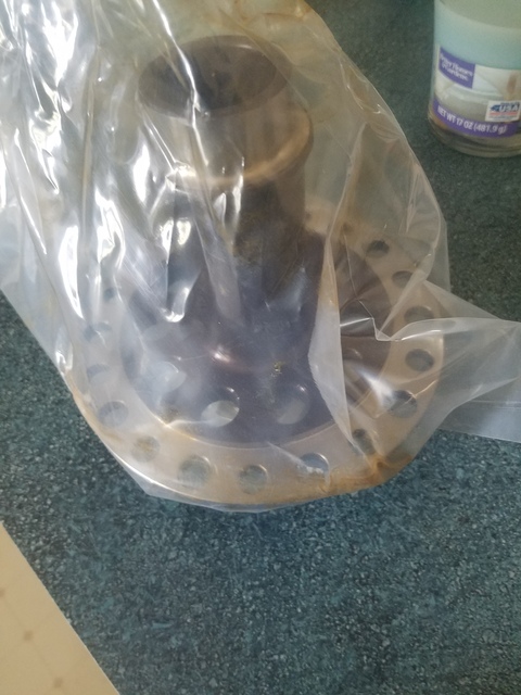

Got a little bit more done tonight, didn't really take many pics though. Got the heater/ac blower box off the firewall. Also painted it to match the truck. Just need to scrounge up a couple pieces of metal to cover those holes now.
Also took the 9" apart. Got to pic up some new bearings for the spool tomorrow then I'll be ready to putit back together.

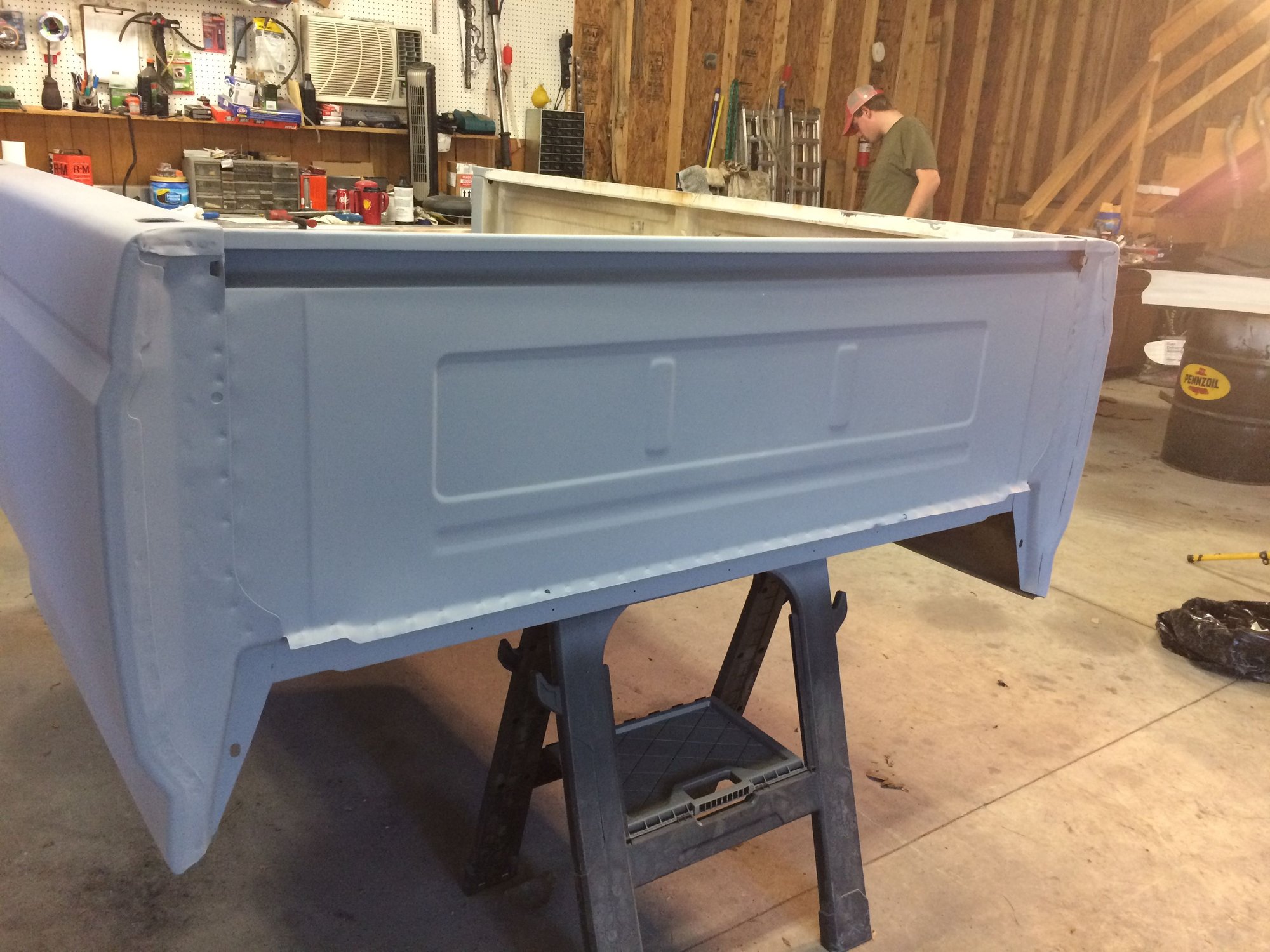

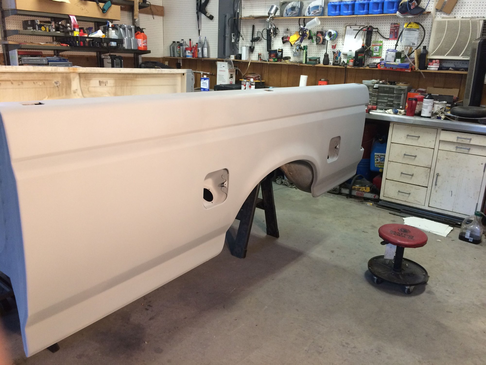

Spent a couple hours hand sanding the tail gate with 120 on the block to see how bad it really looks. Besides the dents I knew about I only found one or two more minor dings. The bed and gate were in really much better shape than the cab of this project. Also the grunge/dirt worked great as a guide coat.

Josh, that bed looks great!
