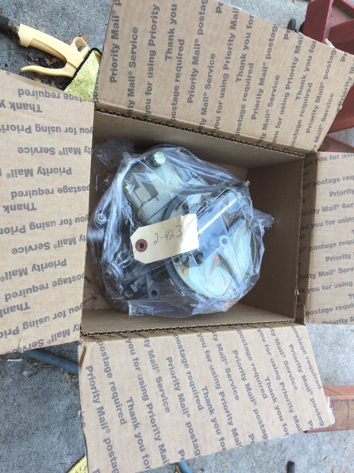

So this box randomly showed up today....
Depending how far I get with the chevy this weekend maybe I can put these to work.
I wish parts would randomly show up at my house, especially if they fit my truck!!!

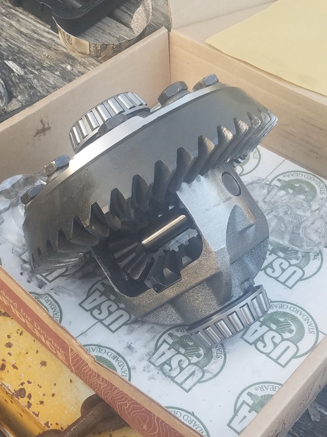

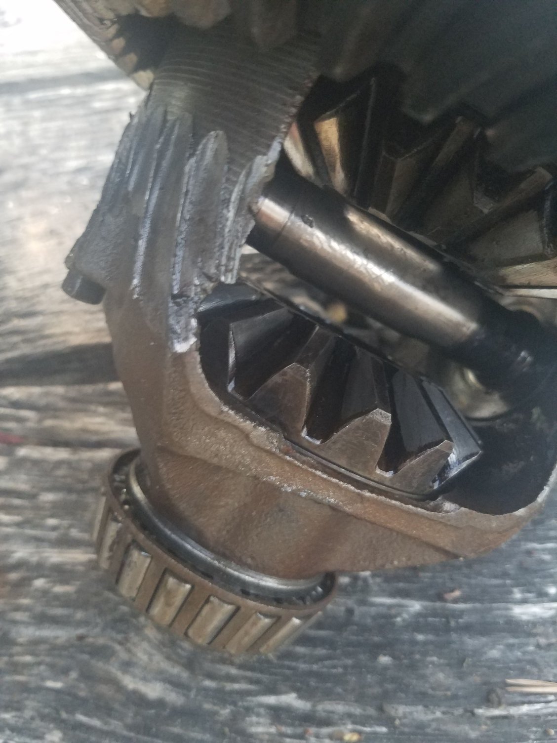

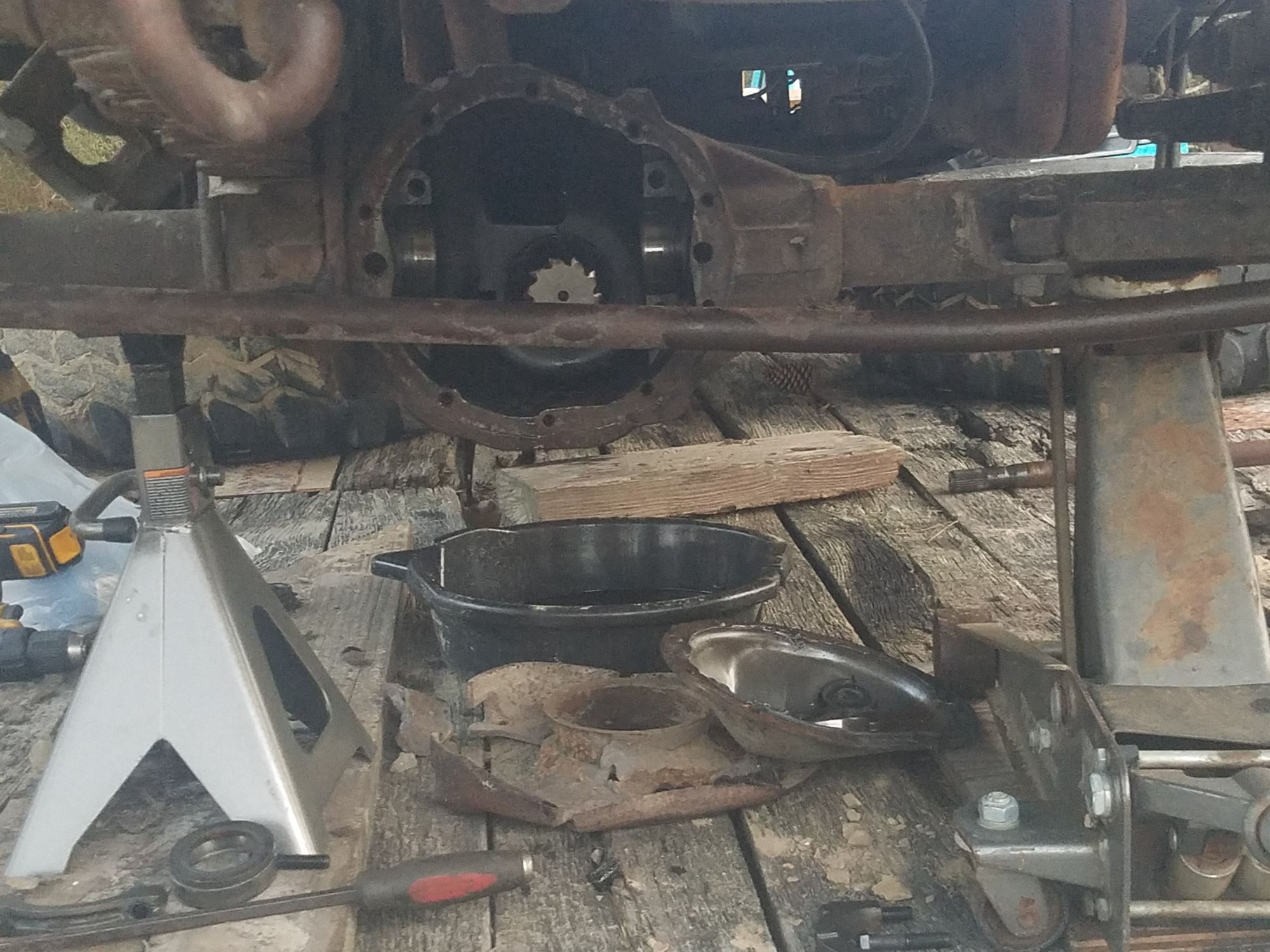

Well started pulling the chevy apart last night for a spider gear/carrier swap.
Got the new carrier setup, and bolted back in Then slapped the cover on it. Got to pickup some axle U joints back in it then re assemble it.

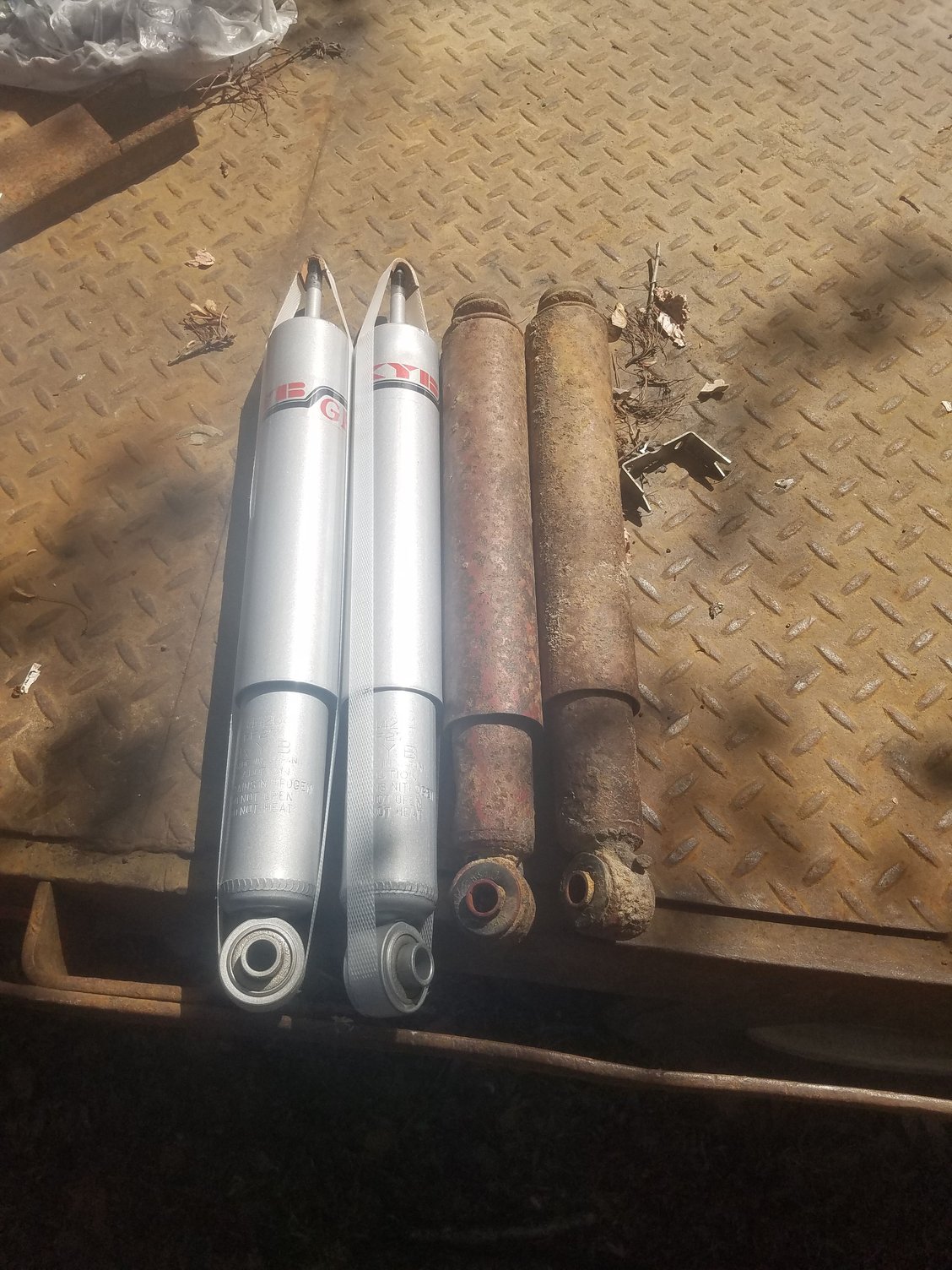

Then I switched over to Ol' Blue and tackled the rear shocks that were pushing 30 years old. I picked up a set of KYB shocks at a steal so tossed them on the rear end.

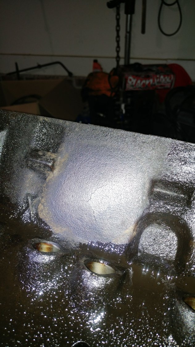

Well I did a little more looking at the block tonight, and noticed a bulge in the block in the water jacket area. Used some brake cleaner and wire brush to clean it up. No need to take the block to the machine shop to check for cracks, and definitely not to have any work done to the block, it's destined to be a planter in the yard, it's driving days are over. Still had fun and learned a lot tearing it down however so not a total loss.
clear cracking and a bulge in the water jacket area. This is a known problem with 400 blocks made at the Michigan Casting Center prior to March 2nd, 1977. This block has the MCC marking and date code of 6C16, March 16th, 1976.
