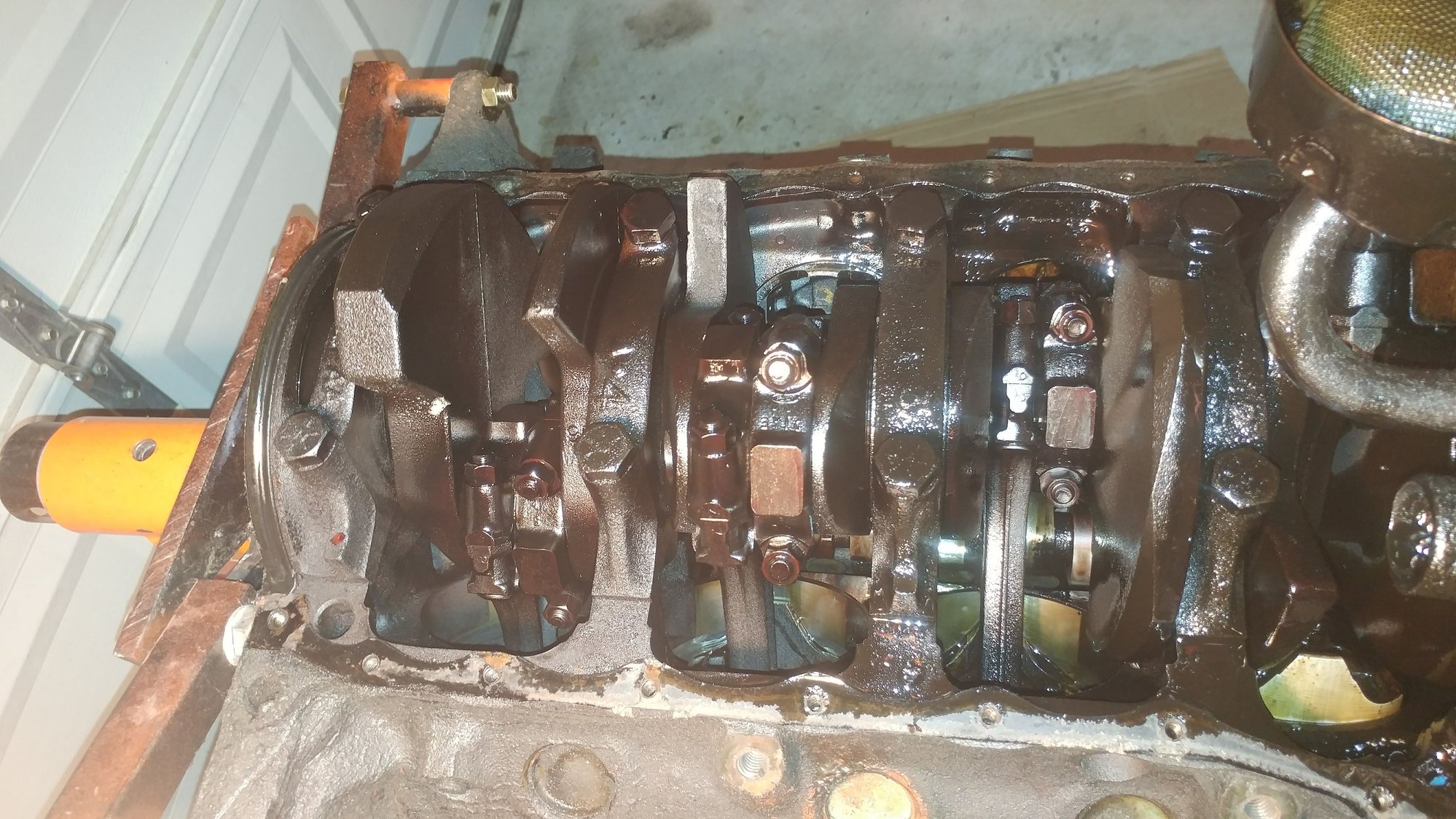

Got a bit more done today on the new 400. Got it on the engine stand and took the oil pan off. Believe it or not, there was actual oil in that motor, just never made it to the top end apparently.
And if I didn't mention it before, the crank turns easily and everything appears to be moving well. Haven't seen any damage or gouging in anything, although a couple push rods were bent, but that's it.

Yeah the bottom end looks a lot better than the heads did when you pulled off the valve covers.

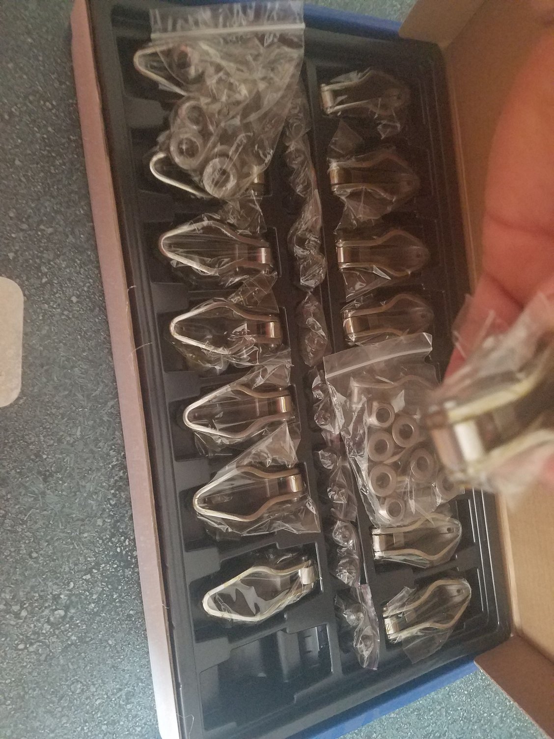

So this box randomly showed up today....
Depending how far I get with the chevy this weekend maybe I can put these to work.

Hey 77 Mud is that Comp Cams Magnum roller rockers? They look familiar.

They are PRW rockers, figured going with a roller, and a little higher ratio will free up a little extra ponies out of this engine.
