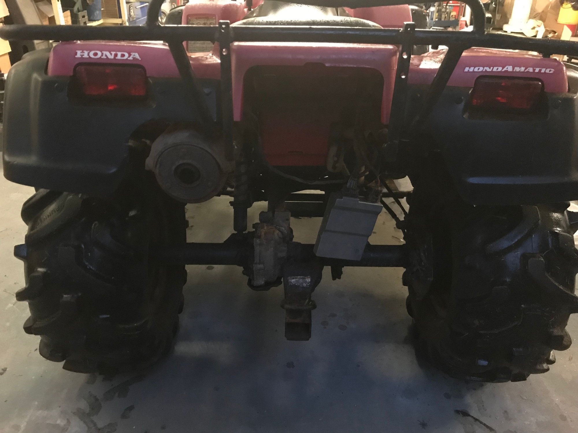

New project showed up on Saturday evening. Dustin’s influence rubbed off. 02 Foreman Rubicon 500cc
and its getting torn torn apart some.

It may not be a looker, but it's gonna be a runner.😎

From ad
Some shots of the new project quad.

So the first parts order has shipped. A couple of front axle shafts, hand brake cable, and a sensor for the transmission shifting issue. Hopefully the transmission issue is only the sensor. Guess I will find out Monday. This weekend, I've been asked to replace the mains on a 955 Cat engine that spun one. Hoping that goes smoothly.
