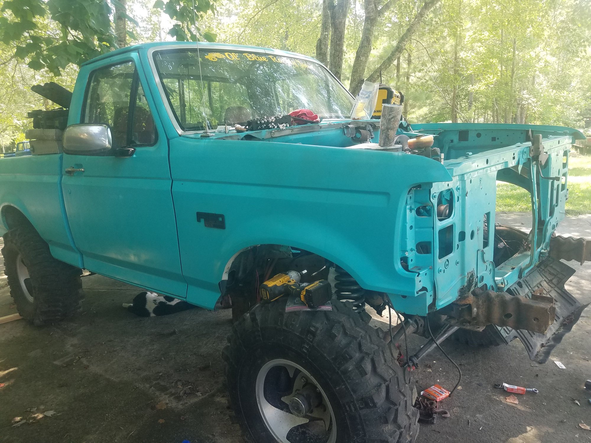

You guys have been busy, me I been lazy!
Back on the 7th I got home from work by 10:30am and was not too hot so got some work done.
Started the truck and moved it out so not to get covered in body work dust. I love how smooth this 300 runs.
Brake pedal still goes to the floor but does stop so will need to look into that some day.
I used a grinder with 36 grit disc to take the hood down to metal and prep it for a skim coat of filler. The skim coat of filler is needed because when I took the skin off the frame I put little bend marks in the skin.
It also had an area that I straighten that needed a little more filler & shaping so I did that first then the skim coat.
Skim coat is on no sanding yet.
Then I removed the tail gate and started stripping it of paint & rust using a Eastwood gray disc made for this. I still have more to do with a smaller disc then will treat the gate with the acid I have for this.
Oh I also picked up another gal of primer & thinner and body filler. Should have everything but paint to get it to paint stage.
I got to get my butt out to the garage and get this finished.

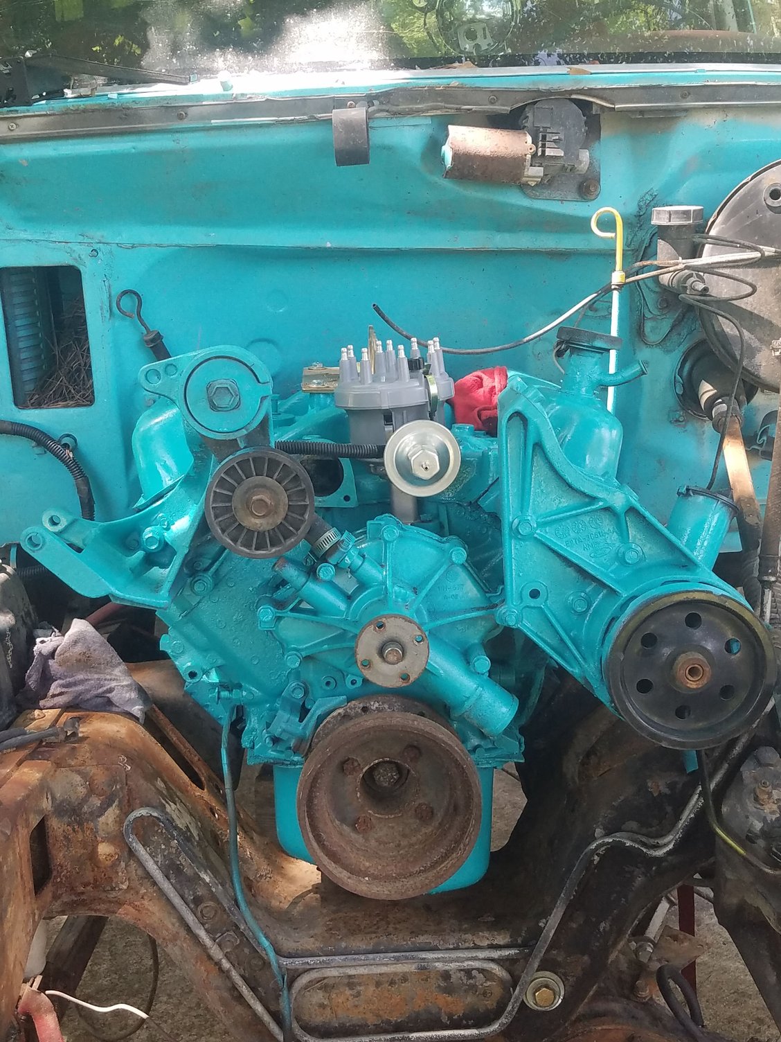

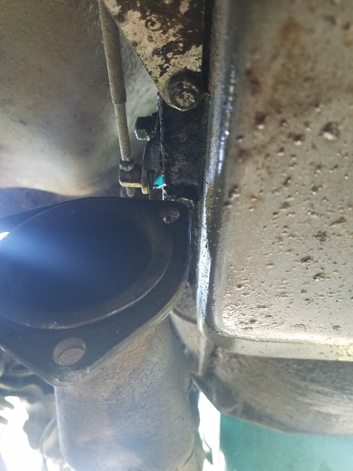

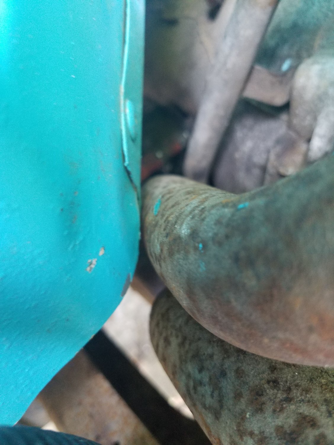

Little slack updating but I did do a little to the 96 over the weekend.
I got the engine set in place and bolted down and to the transmission/torque converter.
Then Sunday I got the the headers bolted on it, temp sensor, and oil pressure lines hooked up.
Ended up "massaging" the firewall a little to get the passenger side to fit right.
I'm going to try and heat/bend the driver side a bit at the collector because it's a bit close to the transmission.
I'm currently waiting on a order to show up from rock auto. Radiator hoses, thermostat/housing. Spark plugs, wires, and some new universal joints. That's supposed to show tomorrow so I'll get on that this weekend. First um gonna throw fresh oil in it and filter on it, then I'm gonna spin the oil pump a few times just to get everything lubed before I try to start it up.

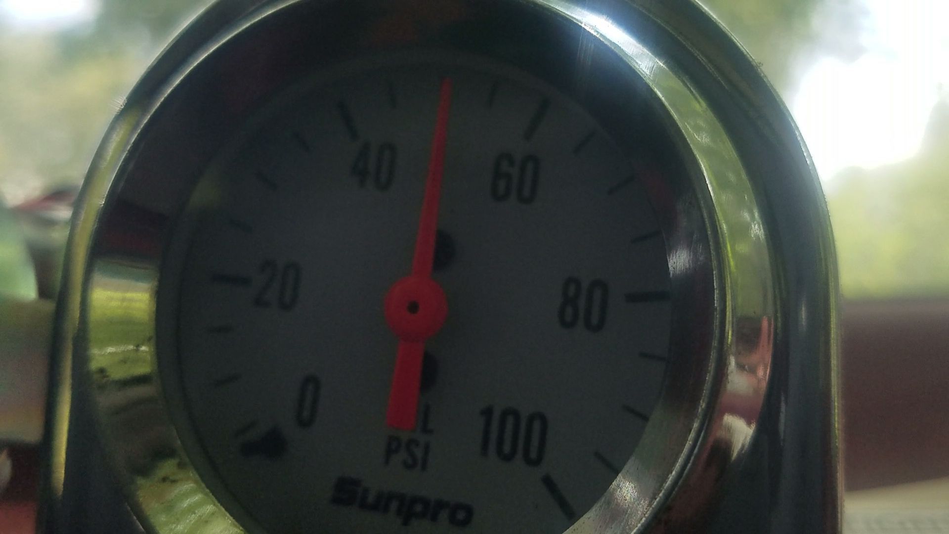

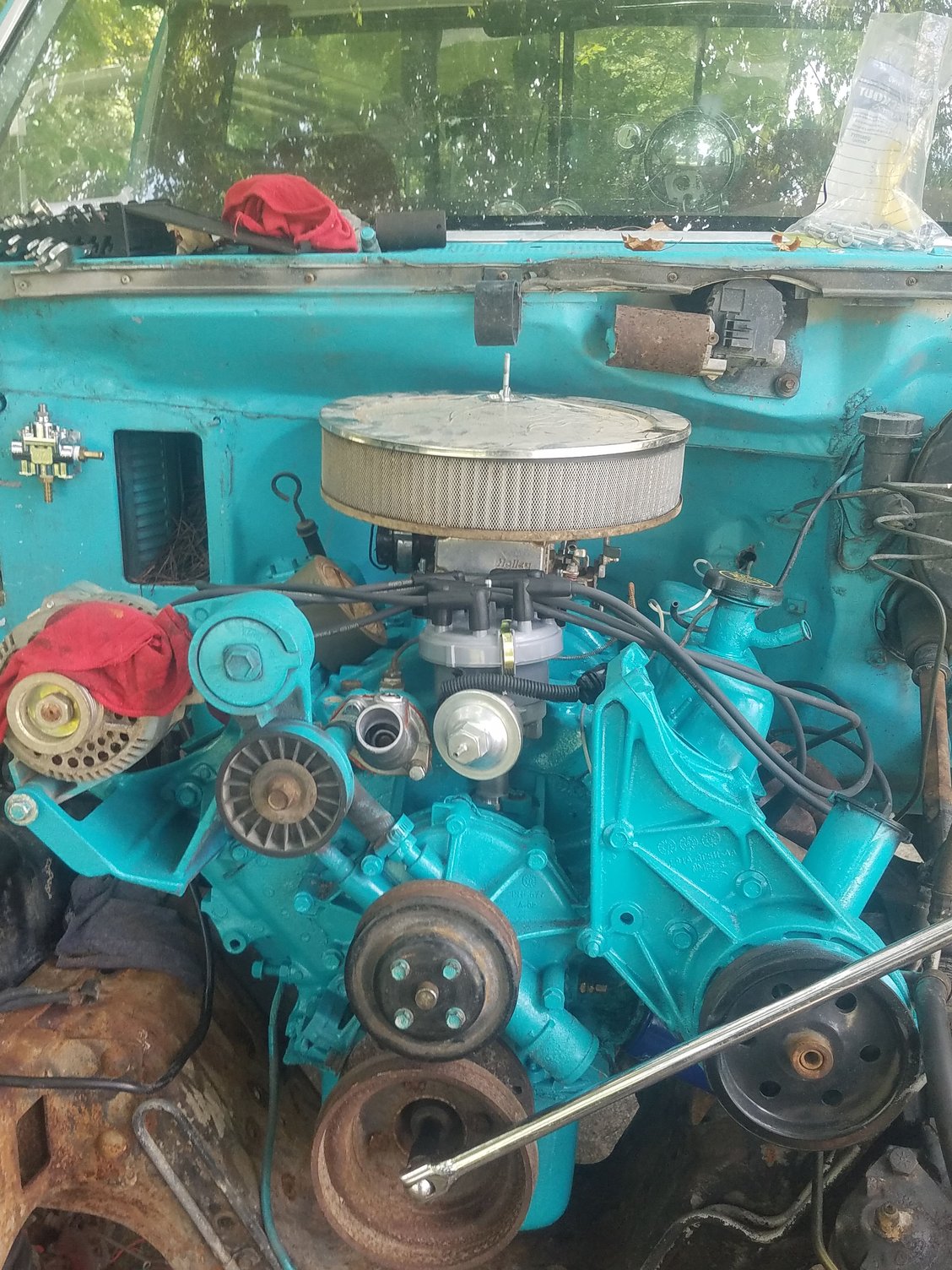

Did a little more today on the 96, but it got to miserable so I gave up for the day. I got the oil pump reprimed and spun the engine a few times to get everything lubed up before attempting to start it.
This was using the impact to prime the pump.
Got carb bolted on, new spark plugs in, spark plug wires on, and set. Then thermostat on and ready to go. So i started hanging the fenders again so I can get this thing going.
