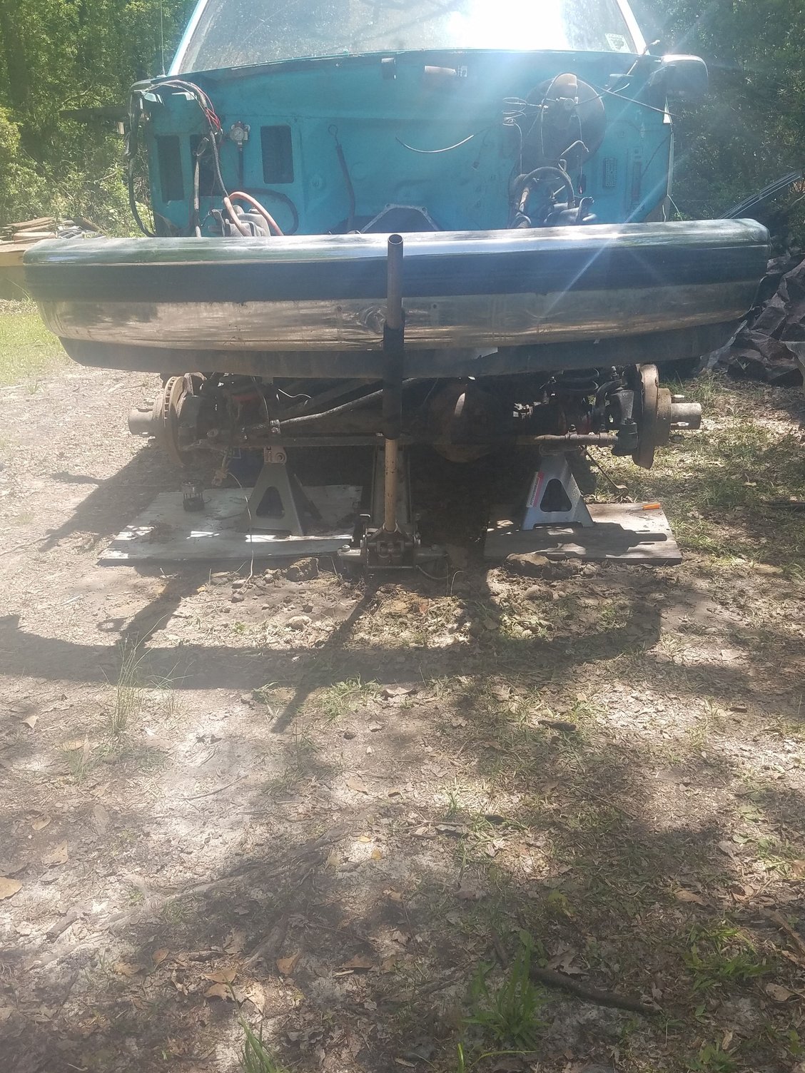

This is going back in.
Swapping the 300 for a 351.
The current situation is now this...

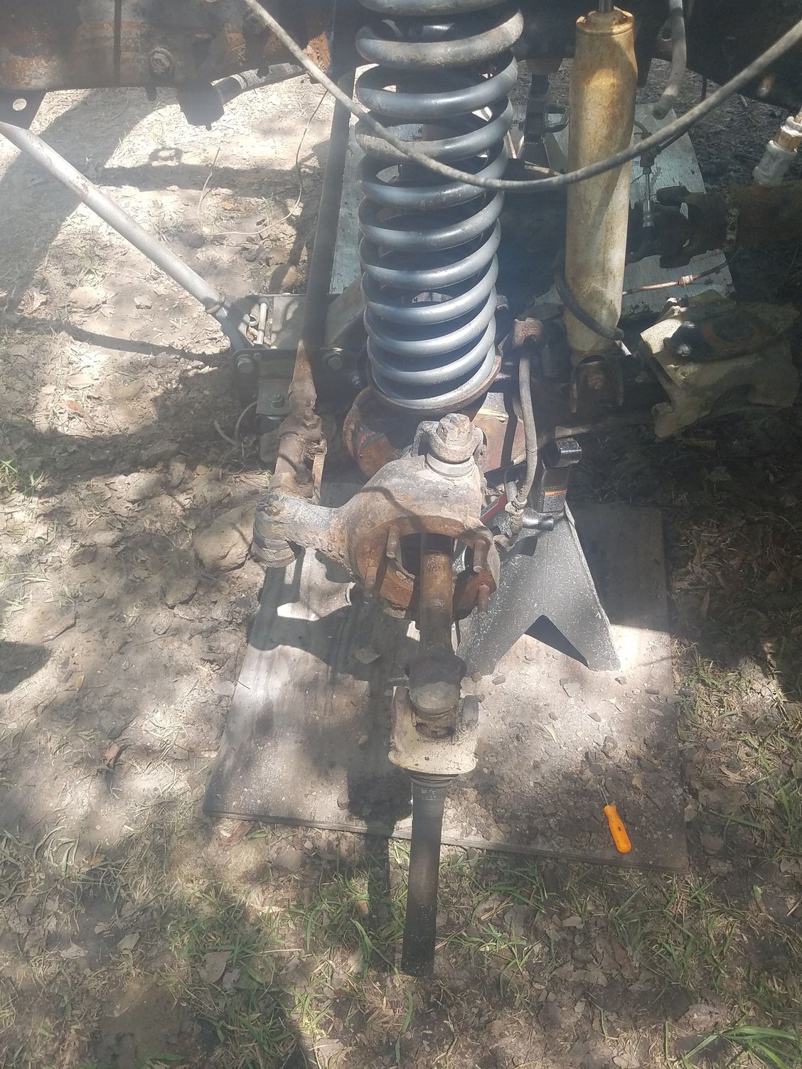

Going to re gear the front, new axle joints, and ball joints.

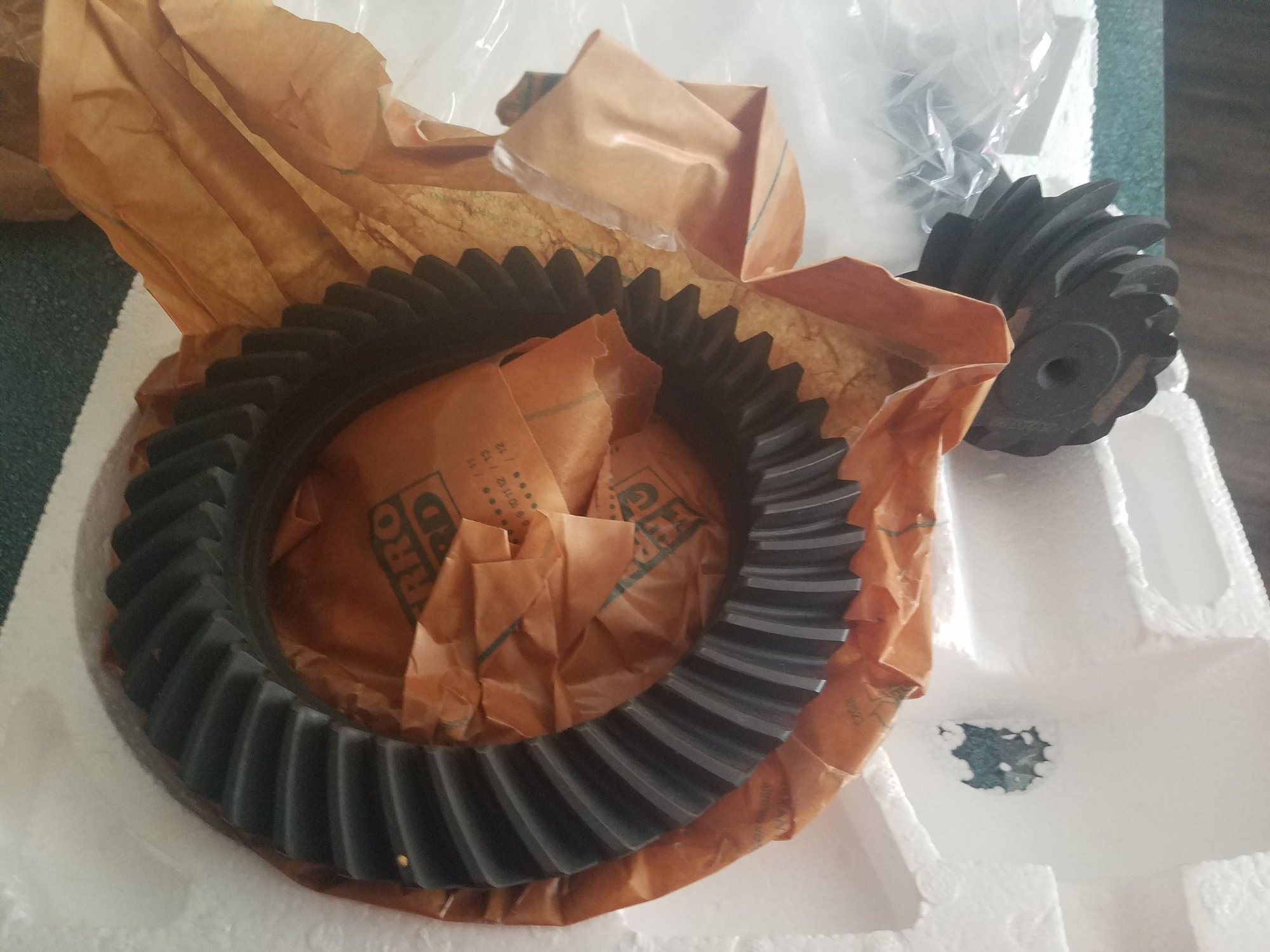

Unfortunately I realized Summits website is wrong and I ended up with a ring and pinion that won't work with my carrier, of course they aren't wanting to take credit for it. So I'm waiting for a call back on that now. Goingto order another R&P Monday morning, a "thick" set so I can use my current carrier.

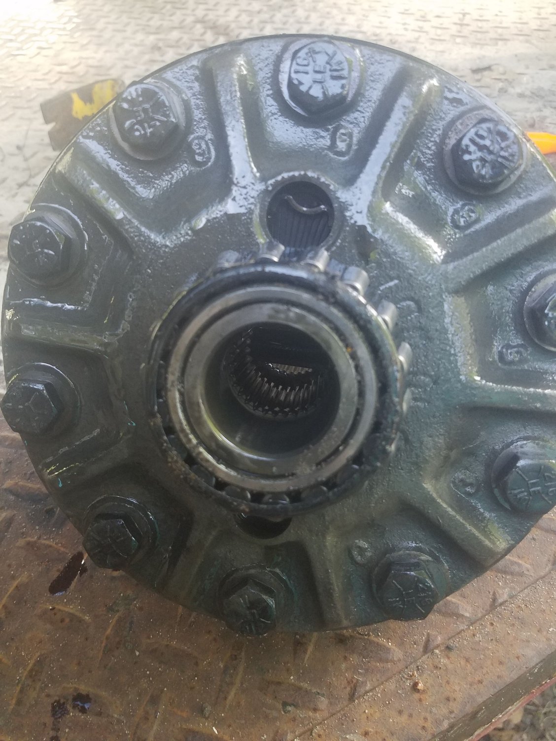

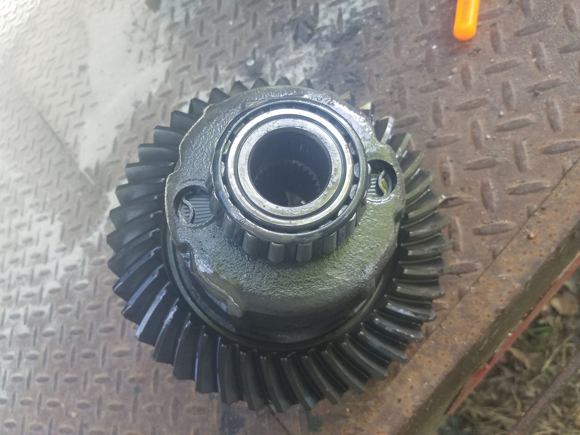

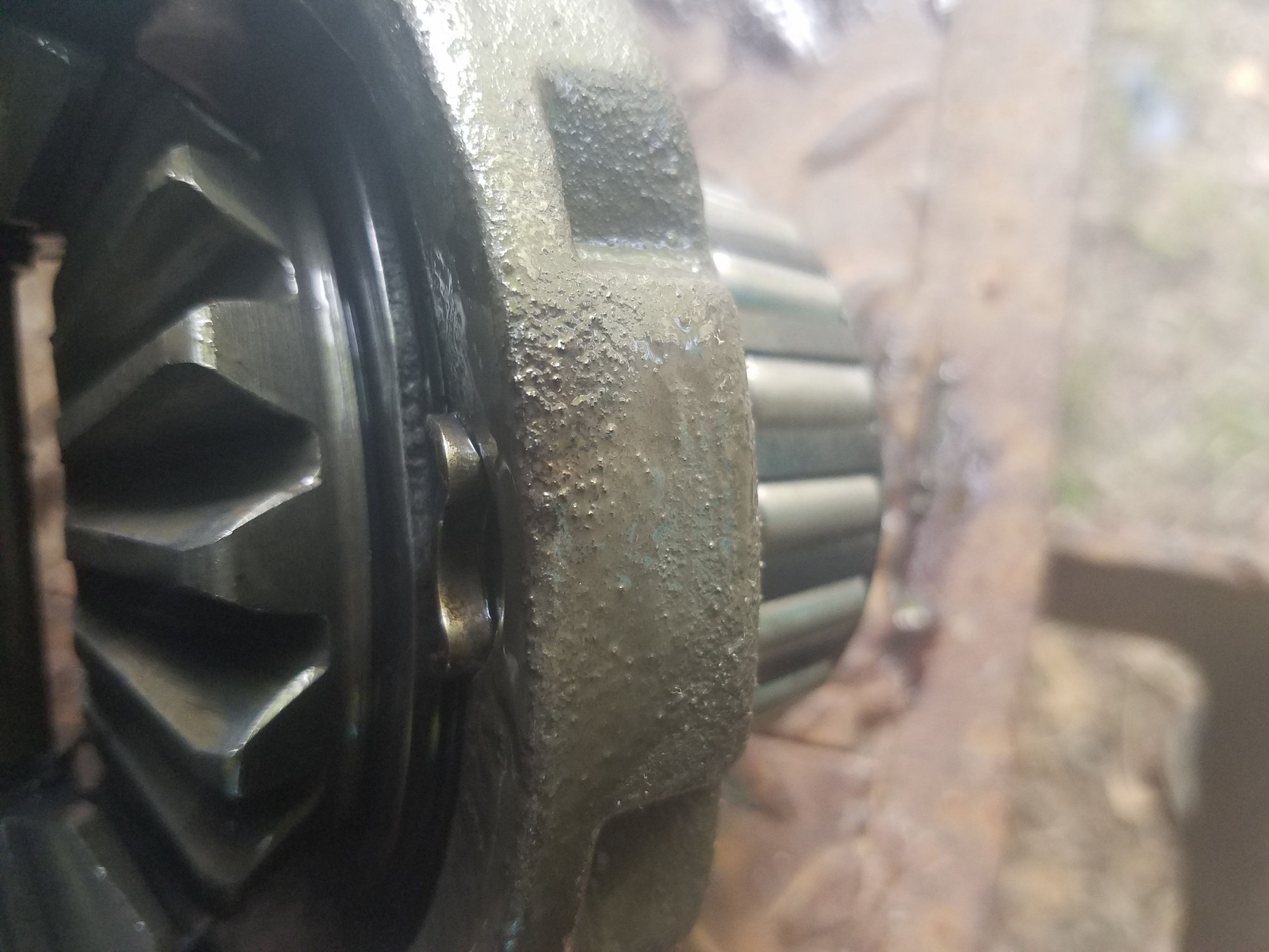

The reason I don't just buy a new carrier is because whenI opened up the front axle I found this.
Turns out my $350 rolling 78 chassis that I scrapped after stripping the axles from and selling the lift had a $250 Trac lok unit in it.

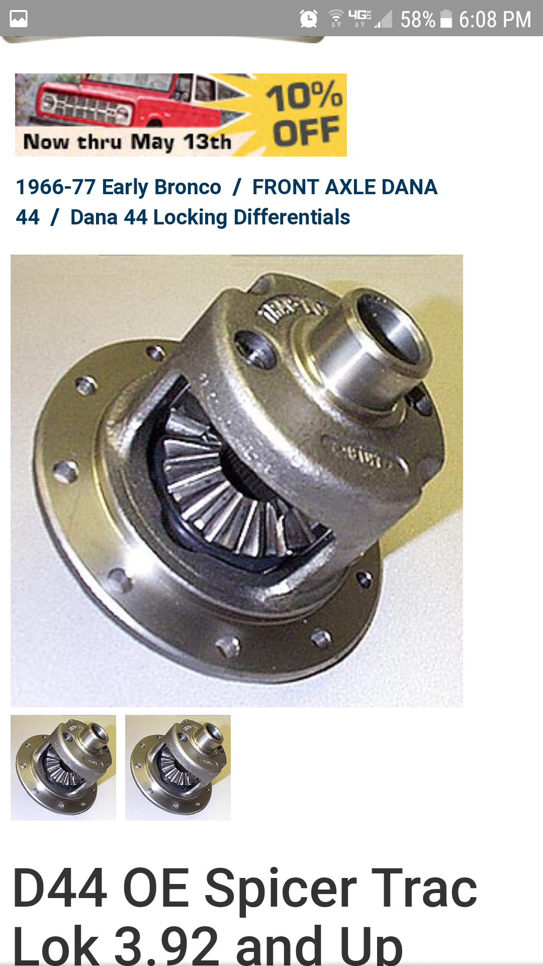

What years was the factory Trac lok an option, never seen a truck optioned with that.
I honestly don't know, not even sure it is factory. The axles were out of a 78 though.

Well after the gear/carrier issue I sent one set back to Summit, then I ordered a slightly different setup. Those showed up yesterday, hopefully I can get a chance to get them setup Sunday.
