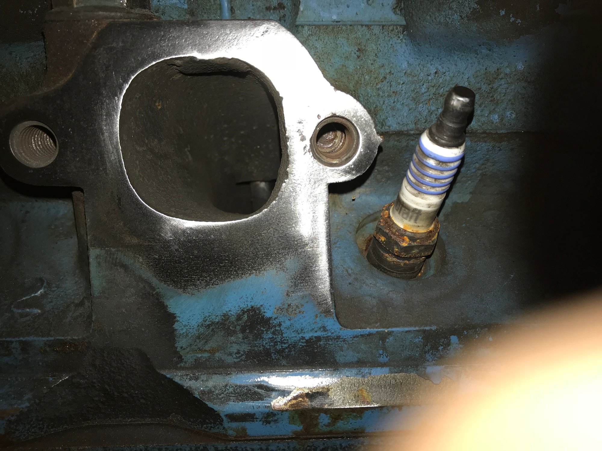

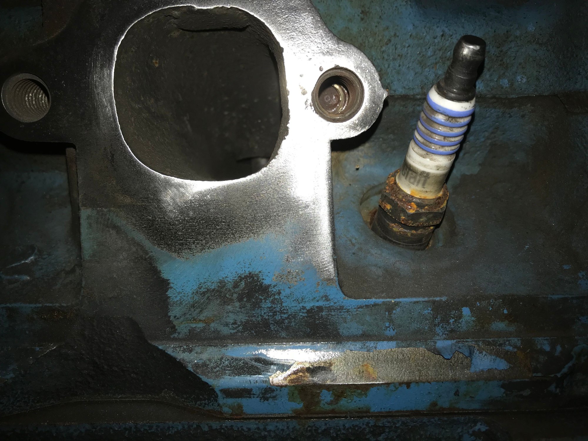

Got the ports on the engine cleaned up. Noticed the strange threads, possibly helicoil on one side.

I have seen that on the end ports outside bolts but not inboard.

Originally Posted by Benztechnc
Sounds like a full day there Dave.
I'd say your right on the HeliCoil.!

passenger side, port furthest forward. Think it was a factory thing?
Mornen fellers!
never been a big fan of them, particularly in situations like this where I’ve been fighting exhaust leaks from day 1!

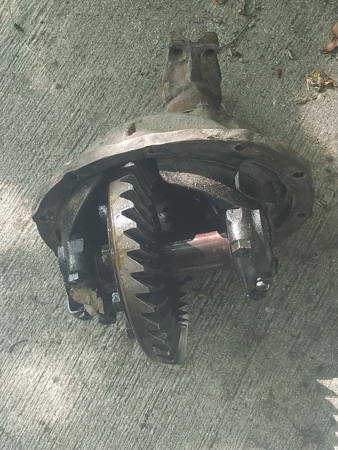

So I got off work this morning and began working on the truck. I got the front back together and on its own weight again.
Then I started tearing the rear axle down for its re gear.
Of course Fred was there to supervise.
Don't know if factory or not I just remember seeing them on the outer most bolt holes.
Than again it was a long time ago and I am old and can be a little of CRS!
As long as a bolt goes in or maybe a threaded stud as the hole does not look to deep and don't want to bottom out the bolt and not seal the port, you should be good.
Is that a spool in the rear? Does not look like a normal carrier is why I ask.

Yes it is a full spool that I put in when I originally built the truck.
