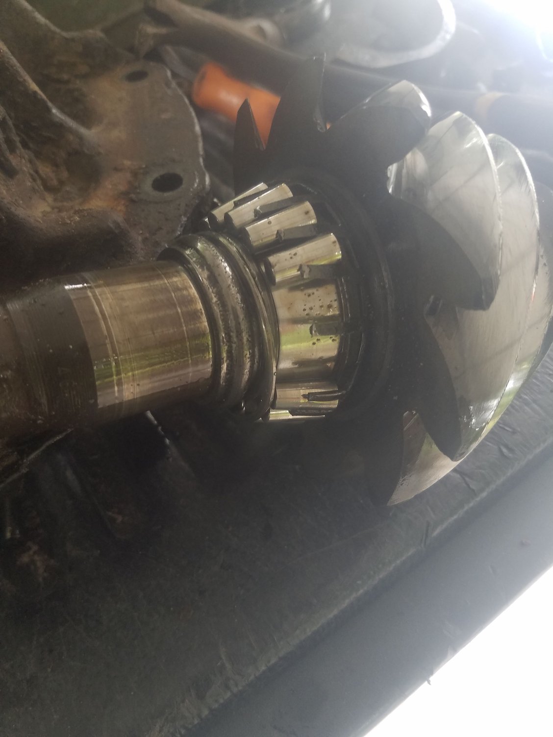

Well yesterday afternoon I pulled the 9" third member apart and got it regeared. The middle pinion bearing fell apart when I pulled it apart, luckily a 9" has 3.

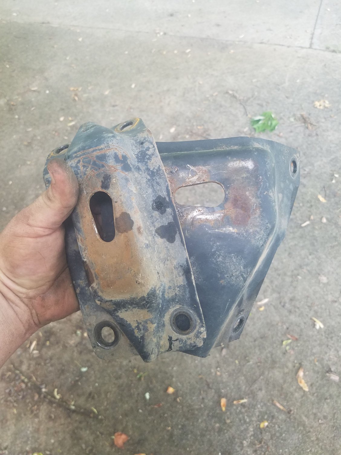

I got it bolted in and axles back in yesterday. This morning I put the tires and all back on and off the Jack stands. I then unbolted the the 300 mounts, and got the 351w engine mounts bolted in before it started raining.
I'm about ready to start bolting a engine in the truck, maybe next weekend if weather isn't to bad.
