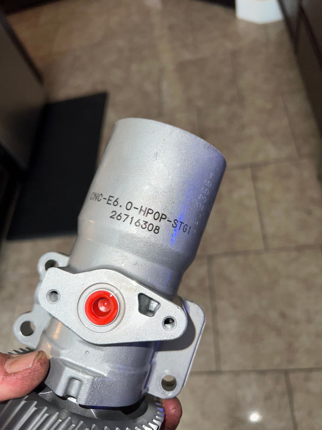

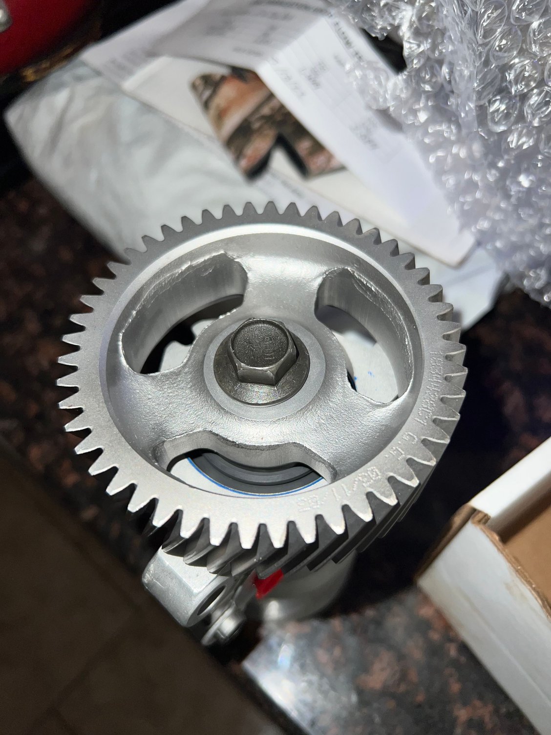

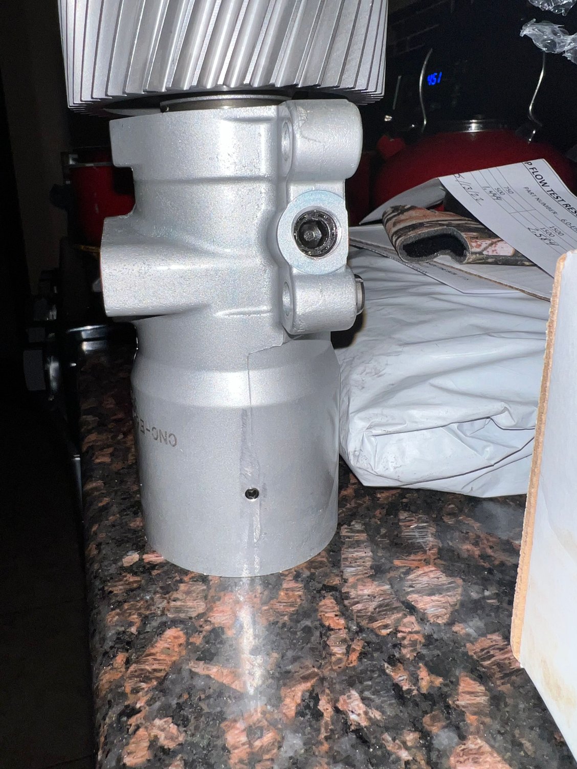

CNC Fab HPOP stage 1
Notice the plug instead of ball and there is a dowel that keeps the internals from spinning.

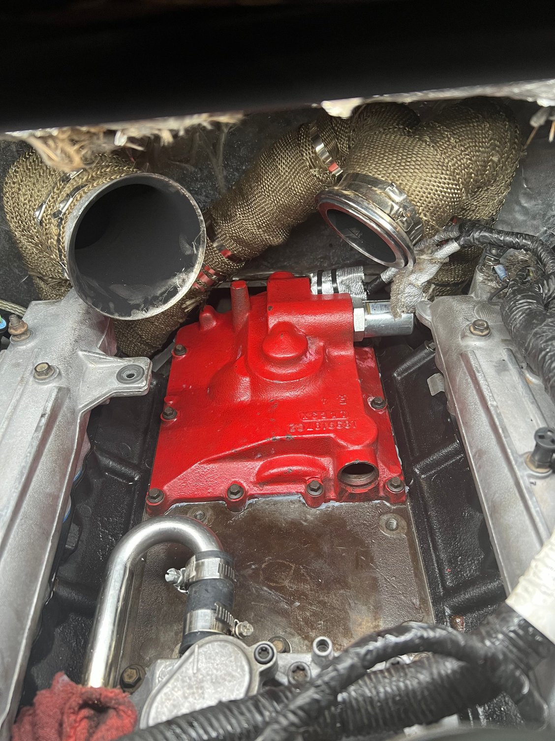

New HPOP in its home

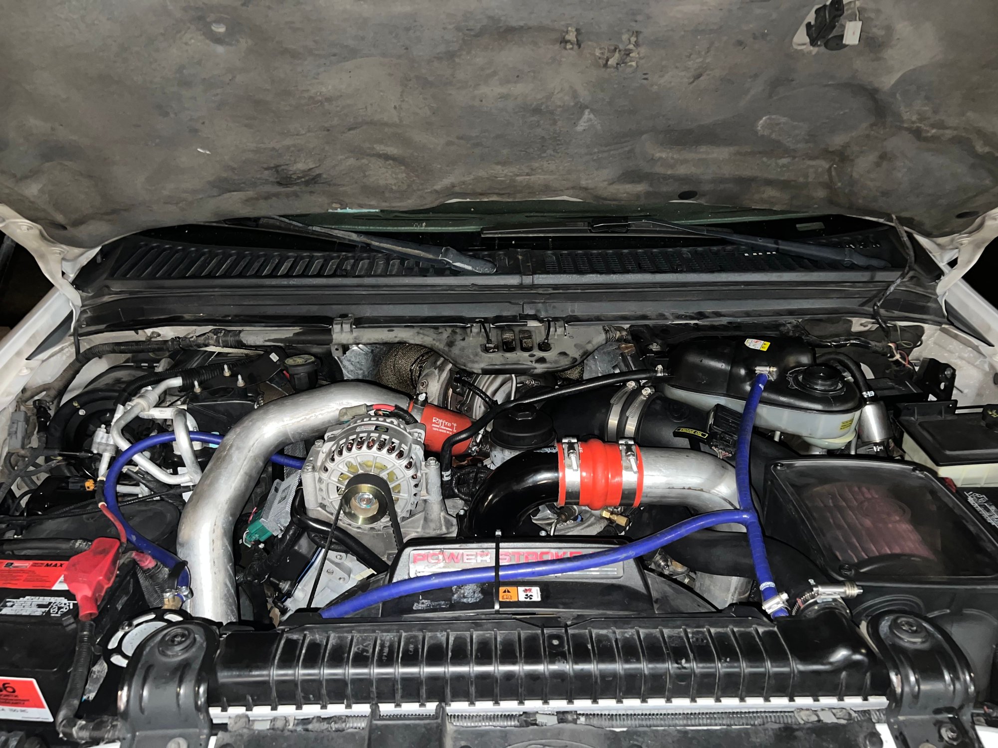

It’s back together
It lives again! Fires up a bit faster too, especially with that 6.4 starter.

@blicharski1989: Did you actually use exhaust manifold gaskets? I'm thinking about whether I should install some, or rather go without as the last 16 years.
I used gaskets for peace of mind. I had no leaks previously but didn’t want to risk an exhaust manifold leak.

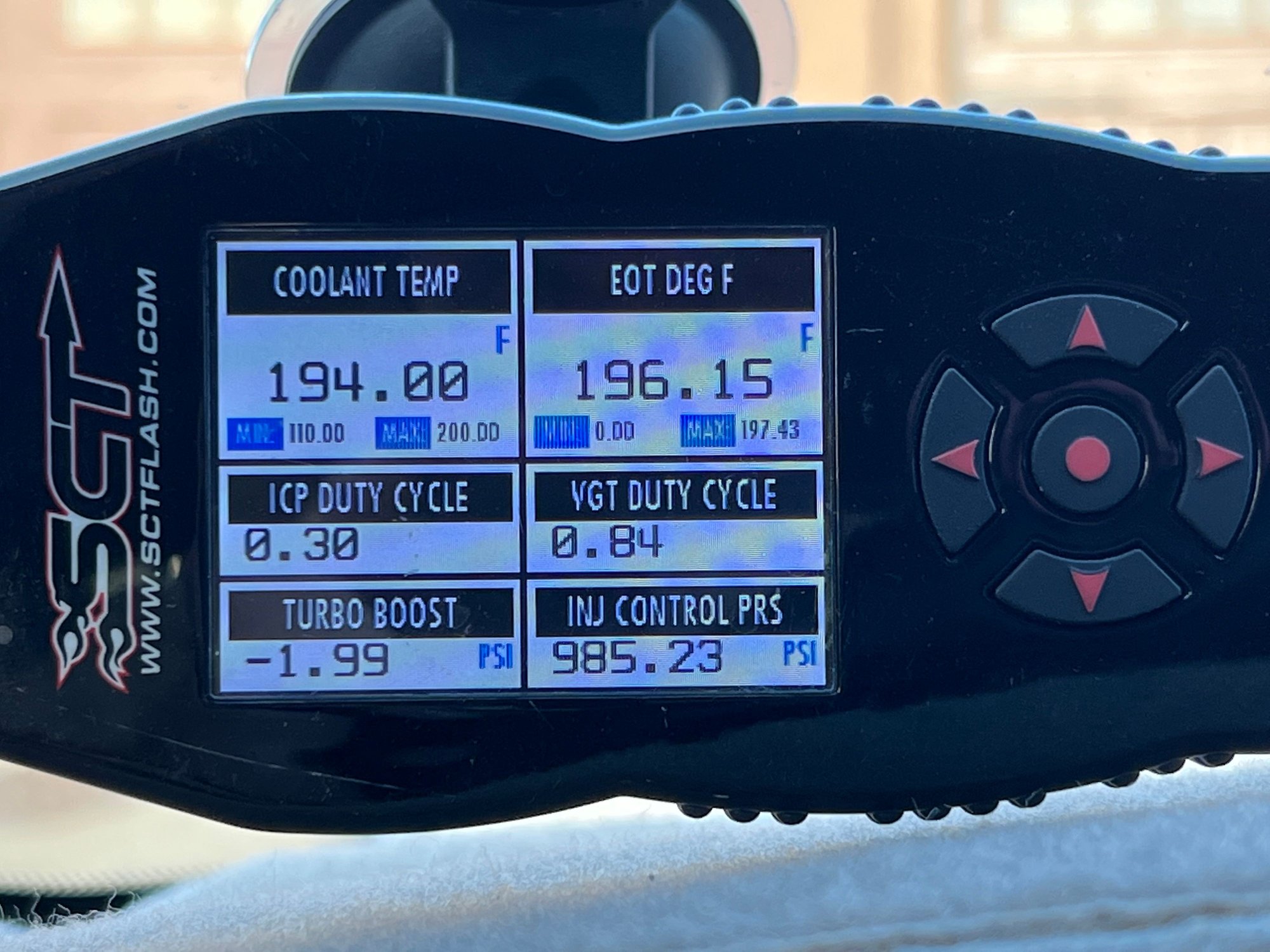

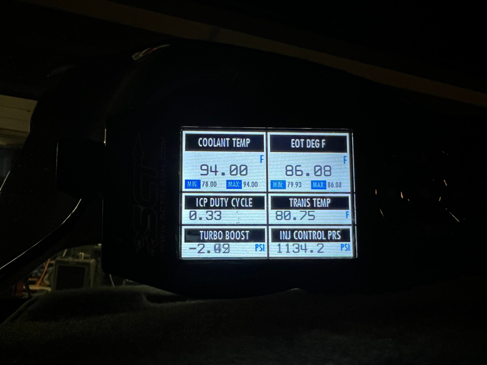

Overall she’s running strong. Don’t mind the idle IPR % these tunes I have seem to run the injection pressure at idle around 1000 instead of 640 like it was stock. Mild 35hp tow tune. No leaks evening is happy. Starts right up. Bottom end grunt feels a little softer with the colt cam stage 2. I may need to do a VGT relearn in my 2003 if it hasn’t gone through it’s cycle yet.

A few observations the pump makes about the same pressure but at a lower IPR %. The old motor craft reman would go 3500-3600 at 85% the new one is around 75-78% WOT
