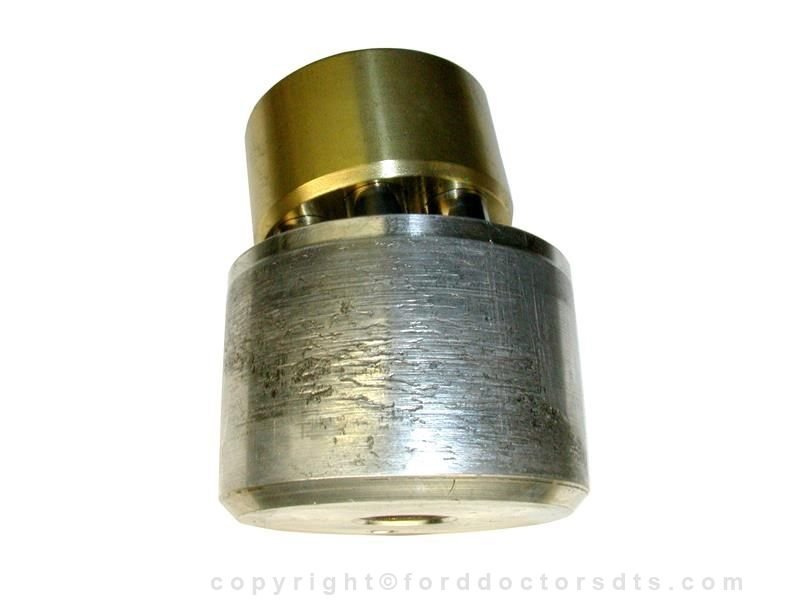

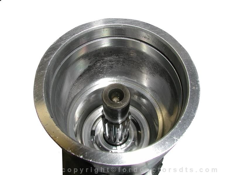

The common failures of the early HPOP that I have read about:
Housing weakness (back plate wear-out)
Swash plate issues (a light press fit is intended to hold the swash plate in place but apparently they can spin and cause failure).
Rotating cylinder cracking.
Wasn't the issue with rotating also the cause if the spit out BB?

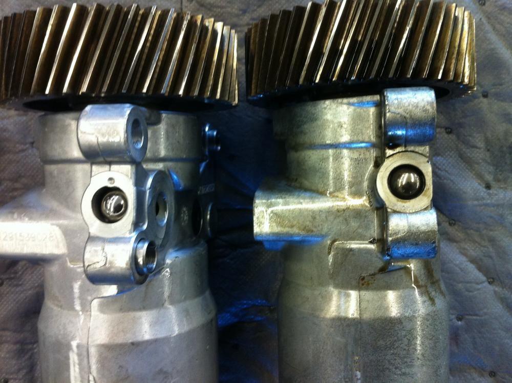

what’s weird is super duty service had a video where he showed two remanned motorcraft pumps. One had the BB and the other had been tapped for a plug.what’s the purpose of the port? To alleviate trapped air?
Old May 25, 2022 | 09:02 PM
  #448
TooManyToys.'s Avatar
TooManyToys.
Joined: Dec 2014
Posts: 17,838
Likes: 3,143
From: Jersey Shore
Some of the aftermarket companies go for a tapped plug to insure it stays blocked. Others have staked them, as mine is. I think it may just be to close where a drill had made a port in the casting.
Hartwig is doing what I wanted to do, take an '03 apart. But in the two years I've been looking at eBay and Facebook for a cheap one, they all have been more money than I want to invest.
There are actually different castings/configurations. I had a short discussion with someone who knows them and one day planned to get back to him. Some of the images I've grabbed.
