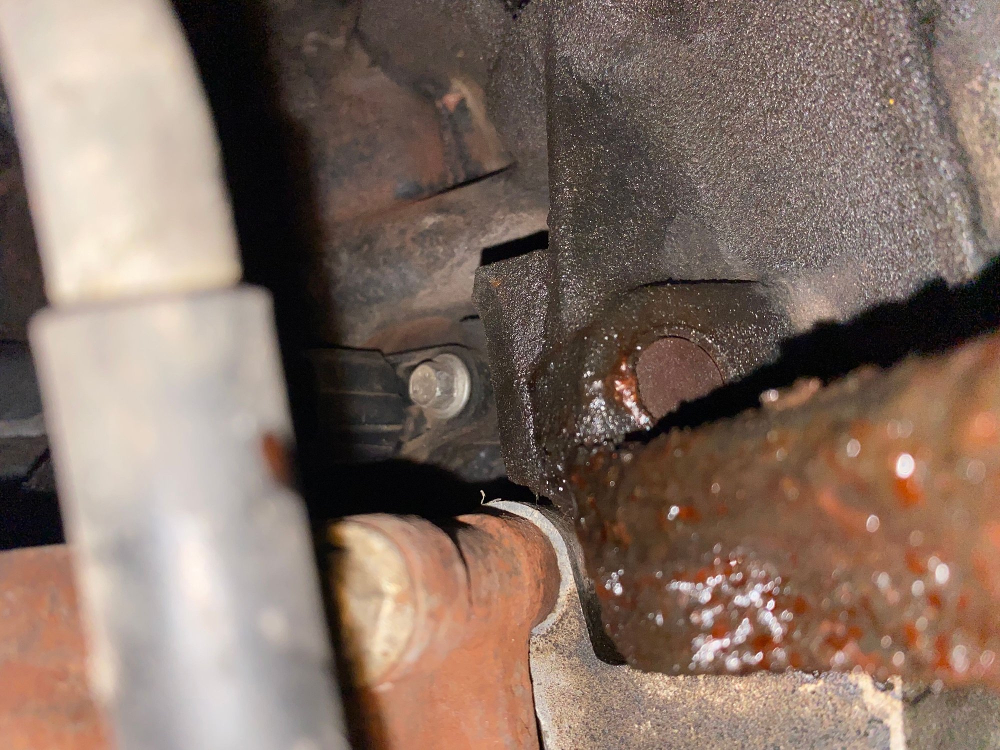

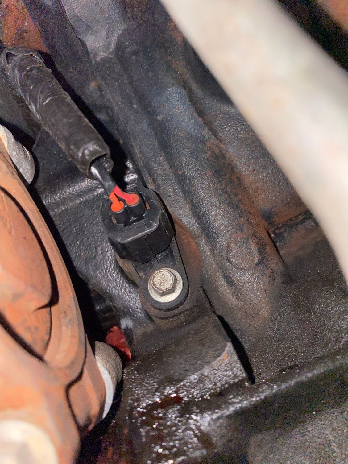

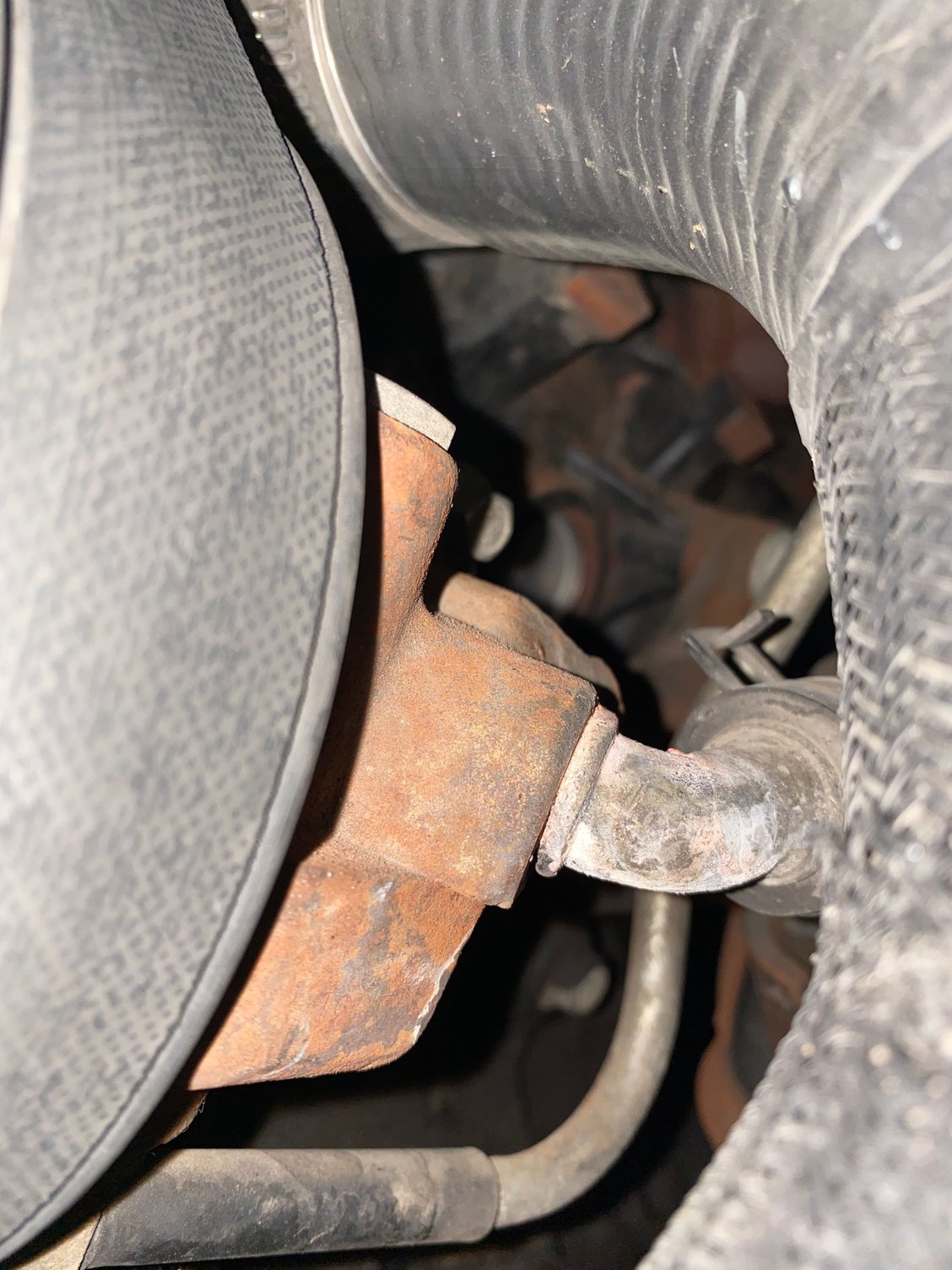

Well I noticed today that I have a coolant leak coming from the front to the engine by the driver side power steering pump. I’m running red coolant. I’m almost positive it’s coolant and not power steering fluid. I’ll confirm tomorrow with a bore scope so I can get into the area. It seems like the leaking from the front cover by where the power steering pump is mounted.
how bad is removing the front cover and resealing? Do I need a special tool for the front main and crank shaft pulley?

Well I cleaned it up to get some of that crud and gunk cleared up. Nothing yet going to pressure test it and drive it a bit see if I can get some leaks to re appear

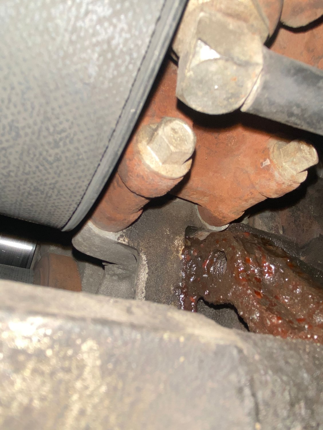

well got it cleaned up, up to 190f, and I’m seeing the minor leakage against it does seem to be the front cover around the power steering pump mounting area.

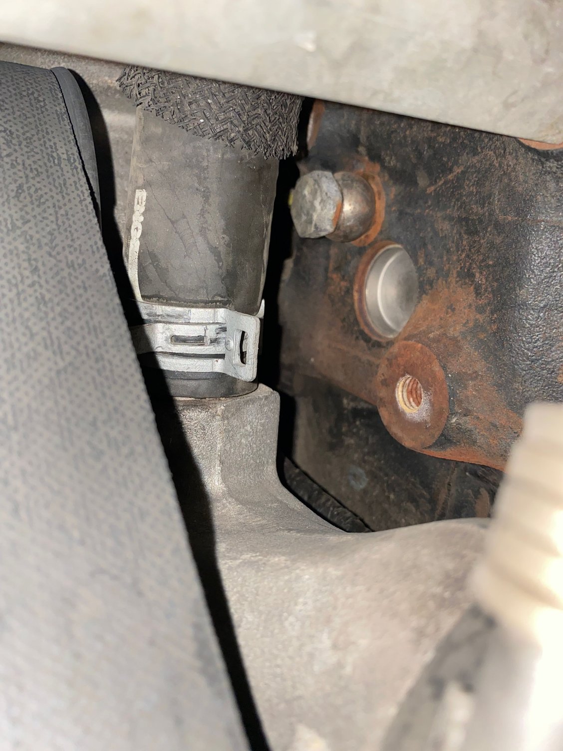

Could it be the donut seal leaking down? I've had a very slow coolant leak in my for about 8 years. It's on the passenger side. I thought it was the front cover, but upon doing the oil cooler last year, I noted the donut washer was leaking. I haven't really inspected it close since. I'll do that when the weather cooperates.

To r&r the front cover you will need a seal setting tool.

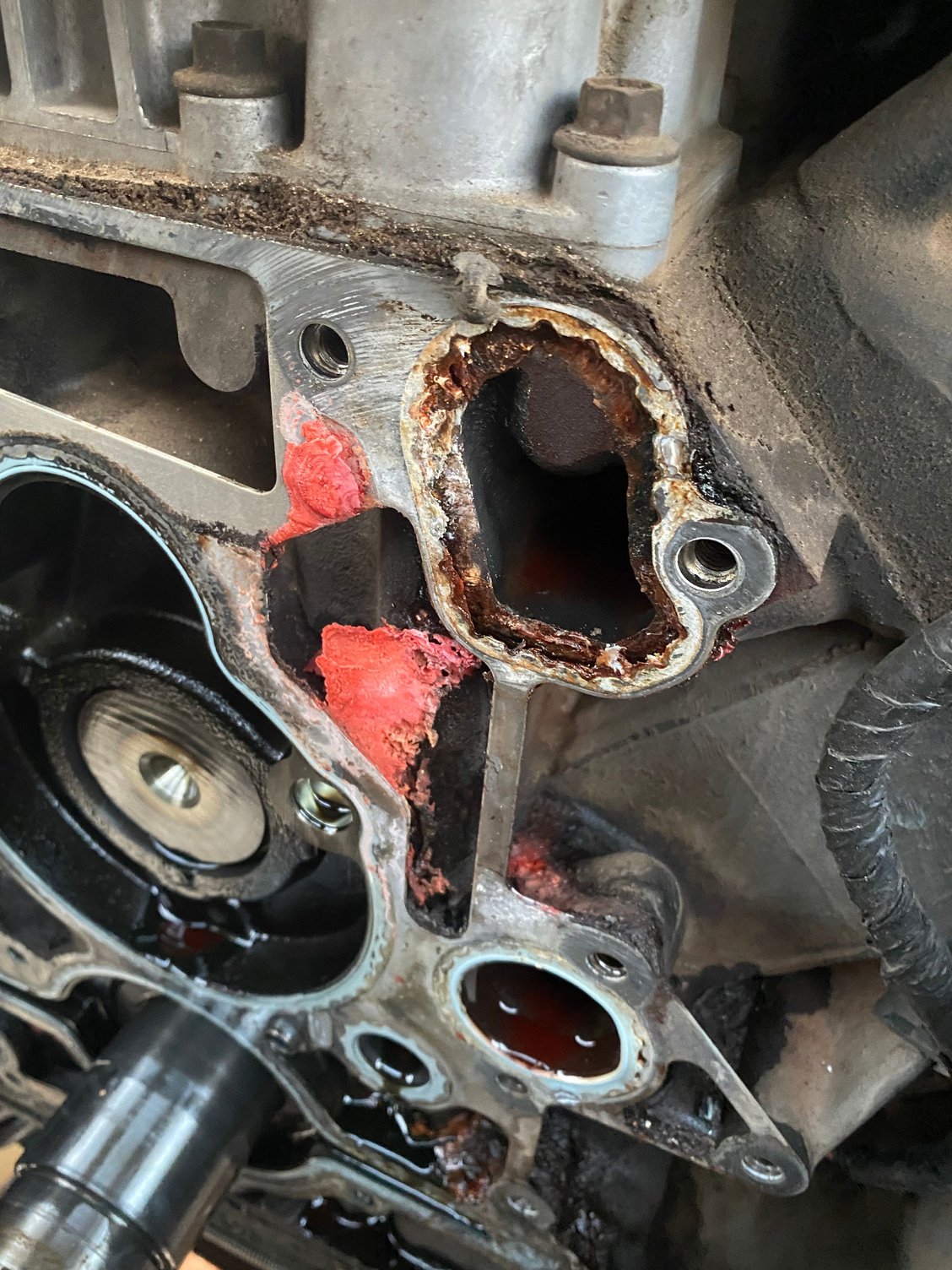

Front Cover Gasket
https://www.ford-trucks.com/g/picture/7353735
The black plugs in the pic above are the bed plate seals. You are supposed to cut the sealant before pulling the front cover gasket off, otherwise you will have an oil leak. Install the Ford oil resistant sealant in those same places on re-installation. TA31 IIRC. Hopefully someone else will correct me if my memory is poor!

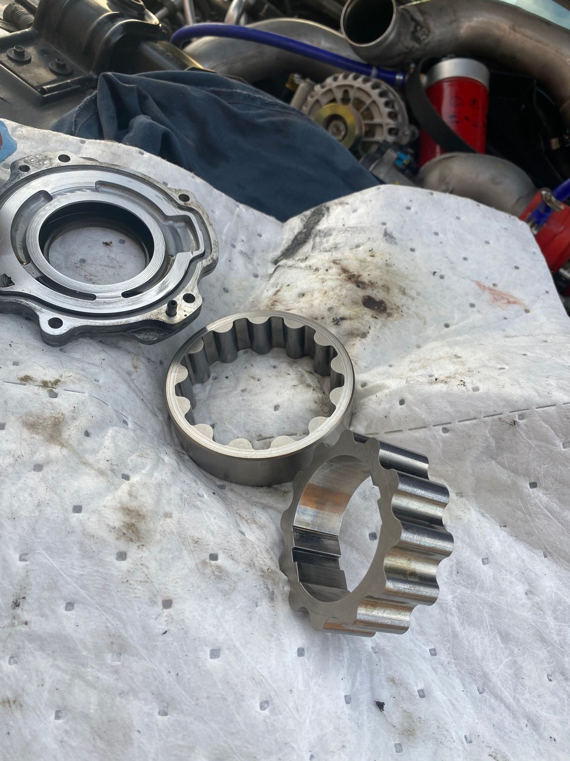

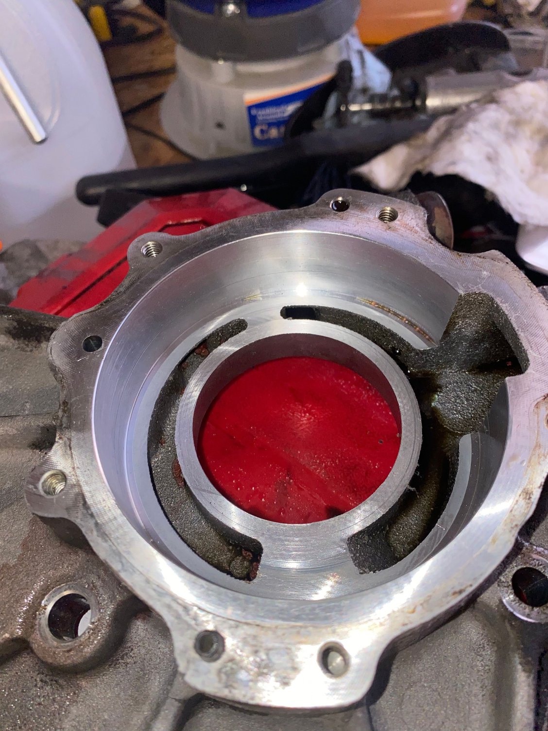

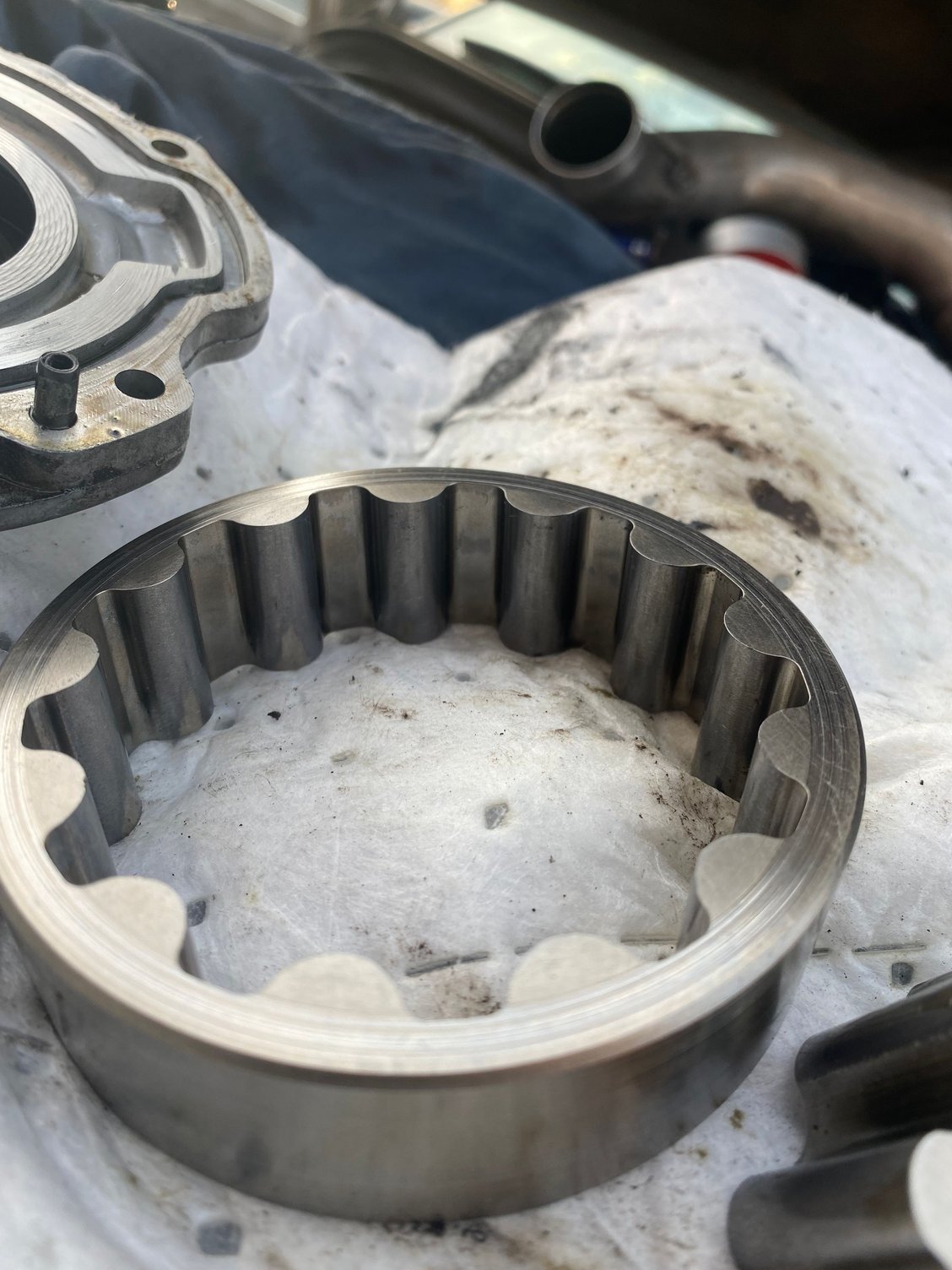

Well I got the cover and gasket removed. I used a putty knife to make sure I didn’t pull out the bedplate seals.

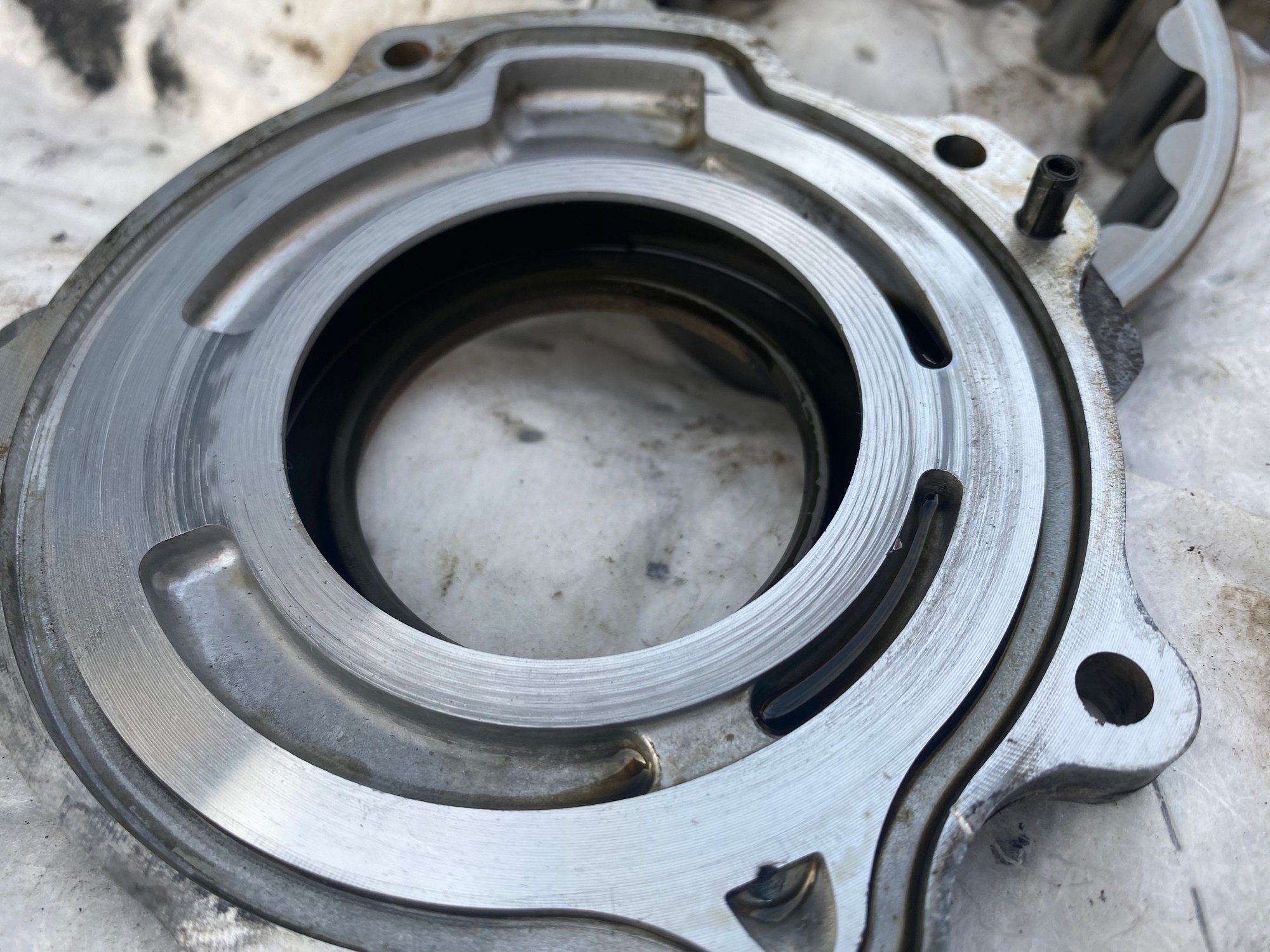

Should I replace the oil pump gears and housing? There’s some small grooves in both. The front cover looks pretty good to me. I don’t know enough about these oil pumps to say one way or the other.

I would replace the gears and the HPOP cover

I'm guessing you did not mark the gears before taking them so so they would go back in to their burnished set. New gears are not marked, and not worn in.
hey jack!
nope didn’t mark them. I ordered new gears and lpop cover. Is that ok? The cover doesn’t seem to have any deep grooves in it. The lpop gears and cover do have some grooves that I feel with my finger nail. Probably normal wear for 250,000 miles. any tips or tricks ?
