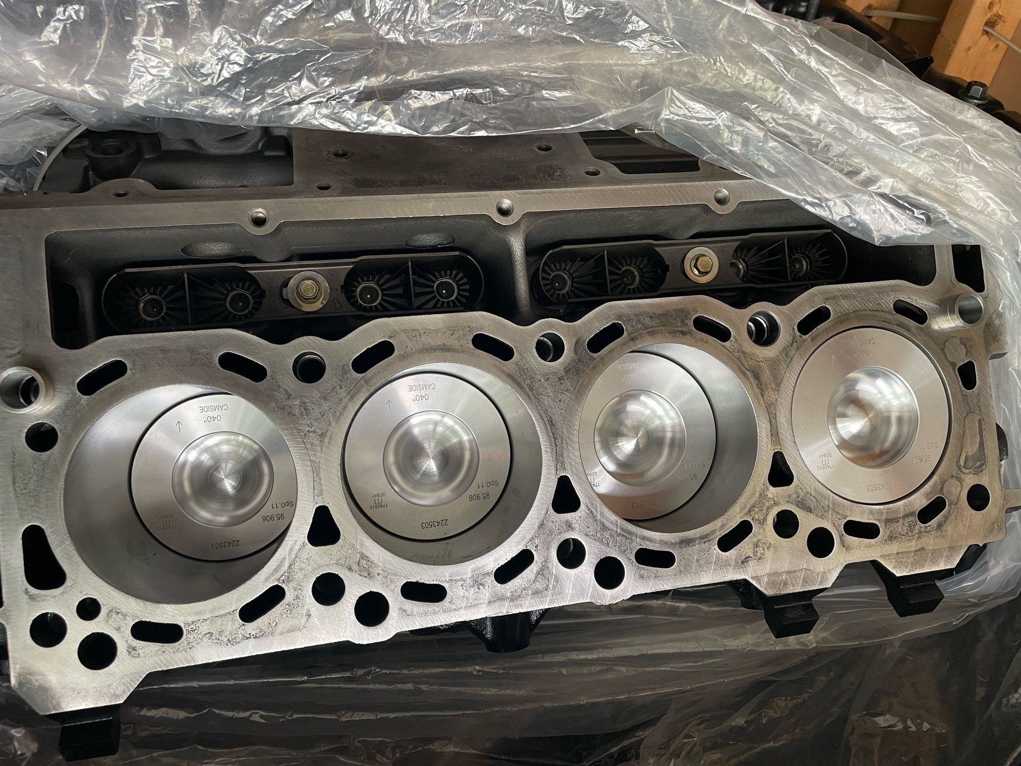

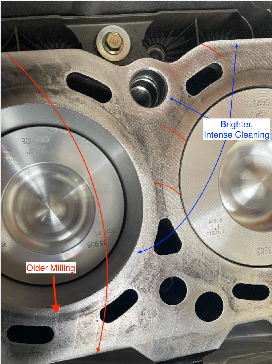

Mostly, it is. A hang up I have with them is the cost for an upgraded cam - it's the same as just buying one retail, but they get to keep the stock cam they use.
I've been having a discussion with a person who bought two of my engine lift brackets early on. He's military right now, but prior worked as a mechanic and rebuilds a lot of 6.0s on the side. He just got a short block from Ashville and they normally don't mill the deck.
I went over the images and sent him back what I thought was going on, and they confirmed it.
The shop that does the machining for Ashville goes over the deck lightly with a 3m scuff wheel if its flat, which is most of the blocks according to Ashville. He want's a milled deck, so they are sending him a replacement short block. He's about to be transferred in at the end of June so getting a replacement block is urgent.
The second image is with my notes on it. Taking off the plastic is a WTF moment; at least it would be for me.
You can tell from the scratch patterns that the major flycutter marks are not the same radius as the fresh minor marks. It was scuffed.
The deck could have been lapped and cleaned, but you're buying a machined short block. The factory or prior mill marks show the gasket staining in them, so that's a tunnel that the sealant has to fill. It might do fine, but if you are building for longevity, you want to start with a good surface.
You can tell from the scratch patterns that the major flywheel marks are not the same radius as the fresh minor marks. It was scuffed.
totally agree that’s why I had mine decked. One it the big reasons I pulled the entire engine. I wanted the best change for longevity. Flat head and a flat deck plus studs and O rings. I wonder why they skipped that part. A few thousandths is no big deal. I ended up at .004 and .005” for a totally clean deck and it cost me shaving the pistons but now I never have to wonder if the block was not true. Makes me sleep better that I checked those boxes. Maybe the wanted to save the cost of having to do shorter pistons not just the cost of decking. I paid about $200 for mine to be decked.
