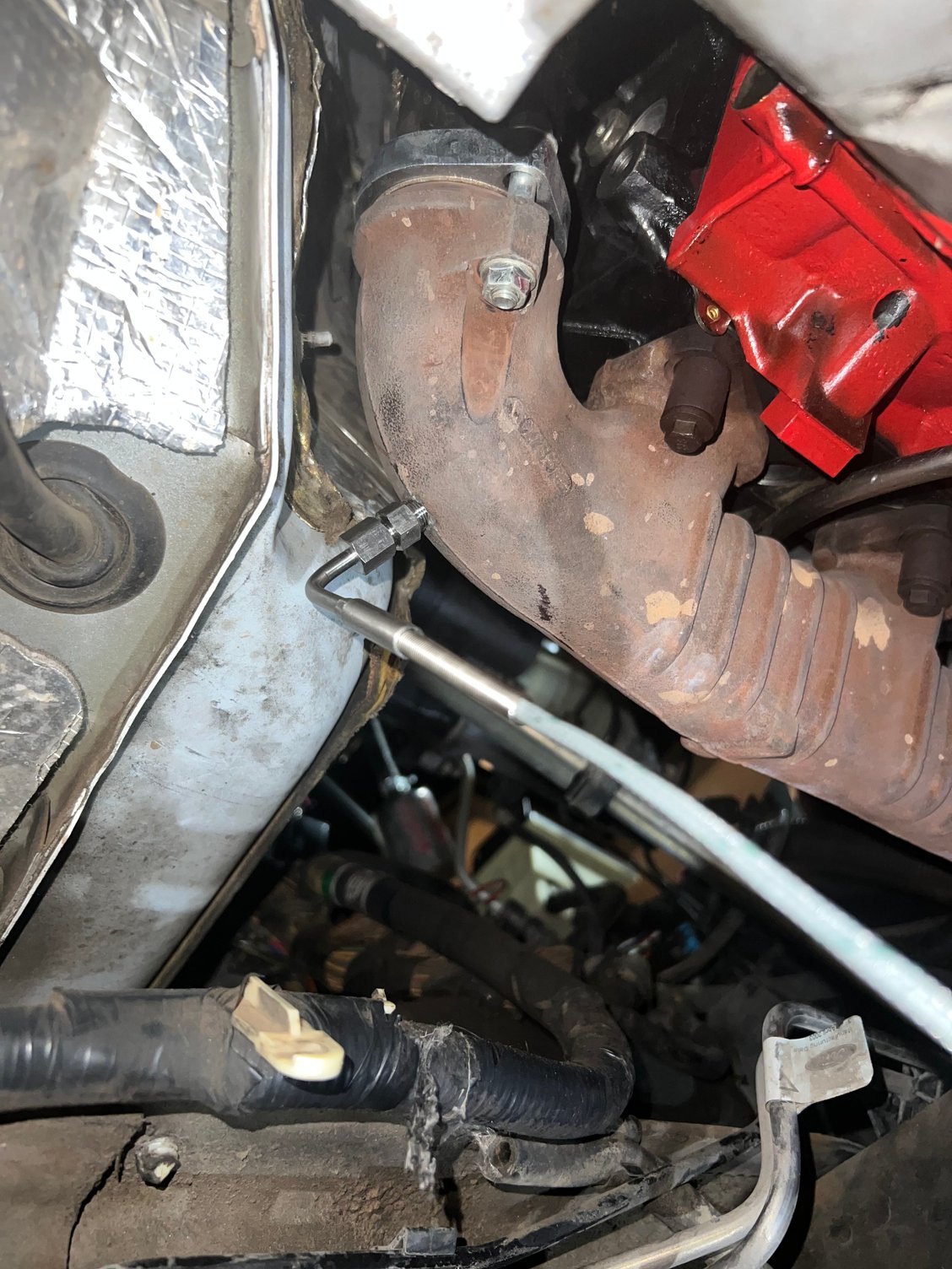

I tapped my manifold while the engine was out. Getting around to doing the SCT EGT sensor. Nice and easy. Hoping this tow tune is pretty mild. I’d like to stay below 1250 max. Maybe tonight I can check it out.

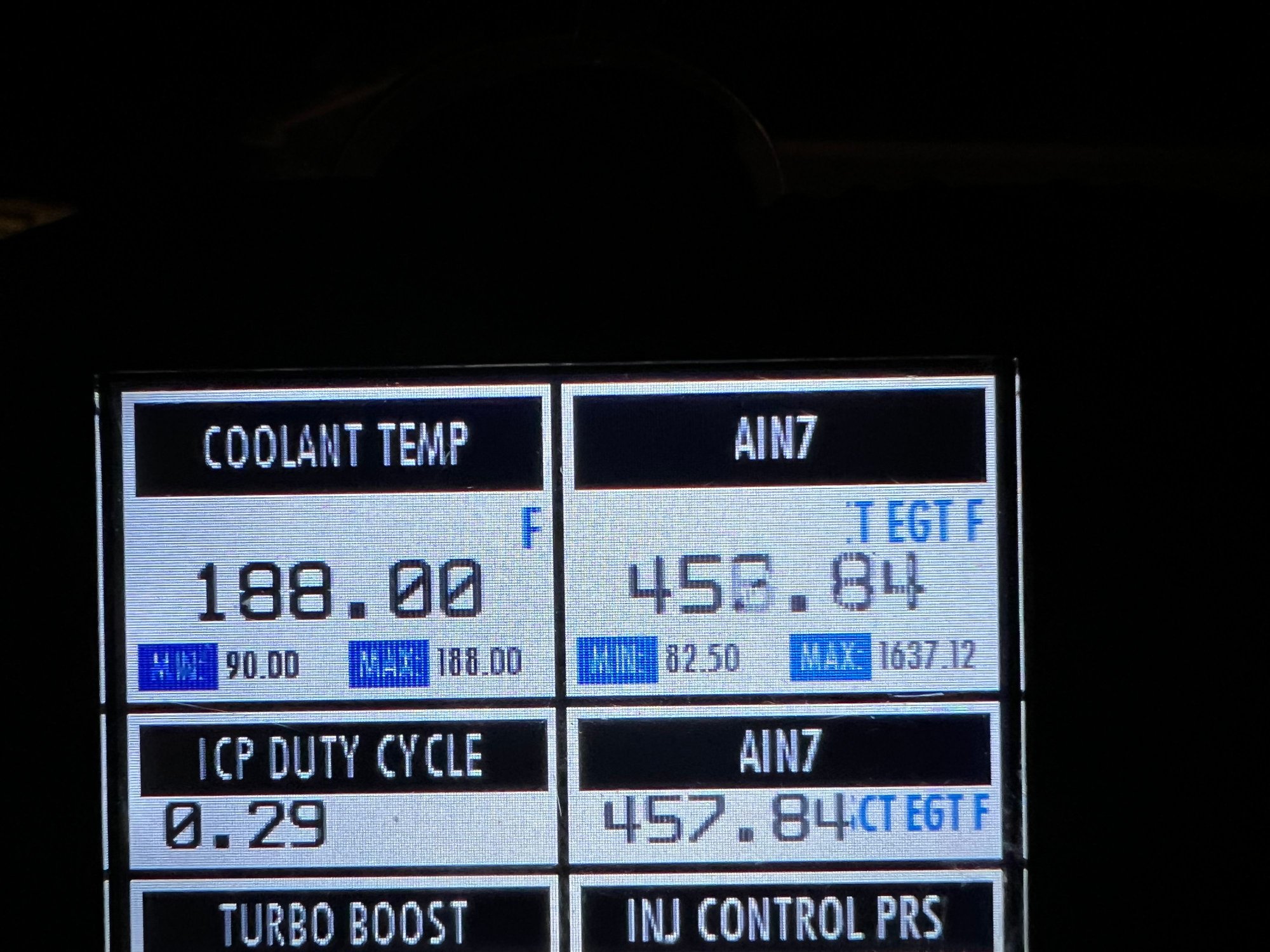

We’ll I did me some WOT testing and I don’t like what I saw at all. 600-850f cruising. Then I stomped it from 20 to about 85 and the temperatures climbed to the sky, 1100,1200,1300,1400,1500,1600. Granted it was only a very short time. I don’t think I’ll be running this “tow” tune anymore. Probably go back to stock fueling and a transmission tune. Holy smokes!!!

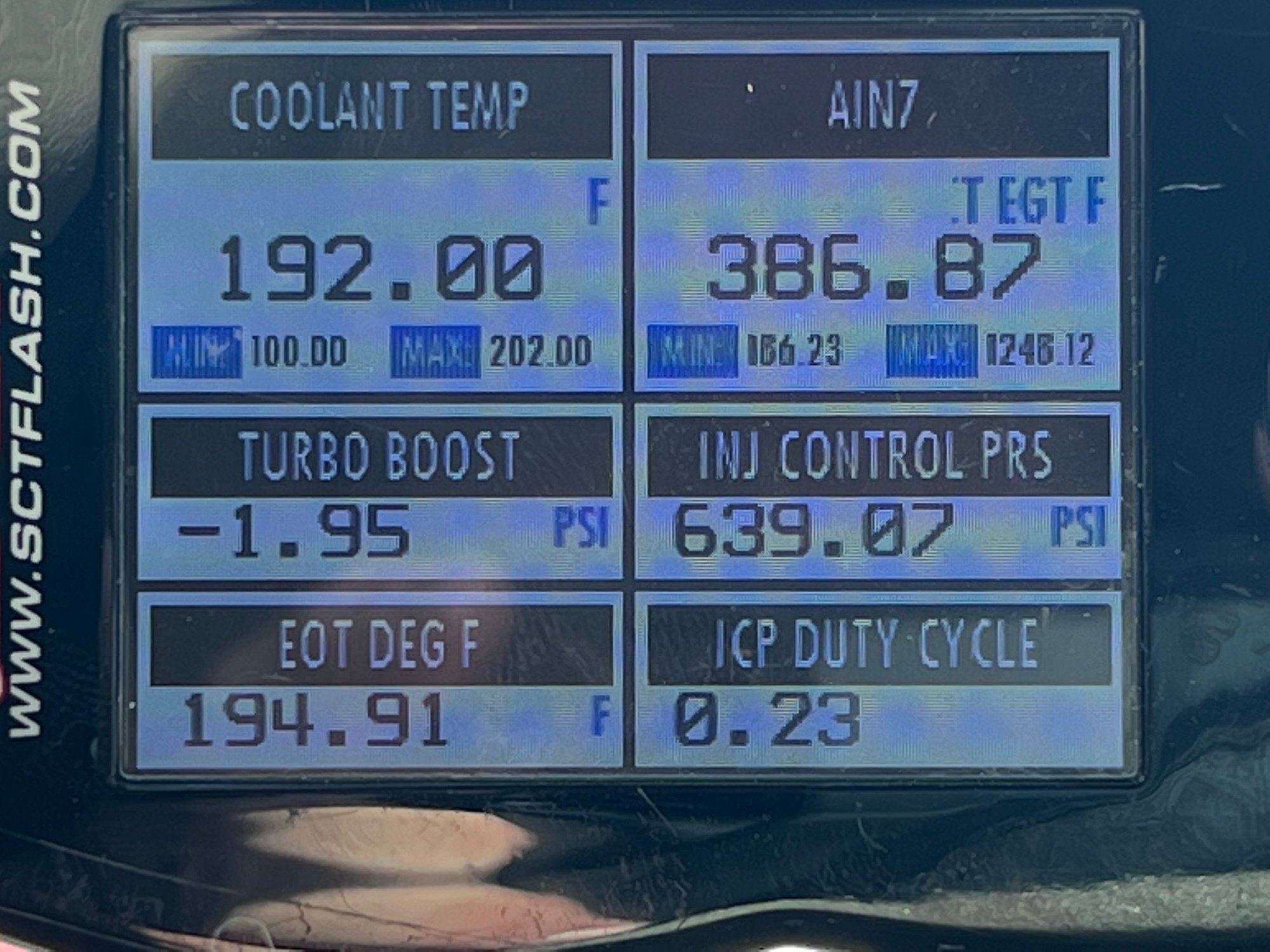

Loaded in the stock tune. Truck is more sluggish and docile. The temperature control is so much better EGT wise. I had to work it a bit to even hit 1248f. Moral of the story don’t run tunes unless you have a pyrometer. I was surprised the mild tow tune was hitting 1600f. The stock tune is safe to work the truck pretty much WOT. Interesting. It seemed to really spend more time in the 950-1200 range under heavy load. The other tune was fueling too hard I suppose.
