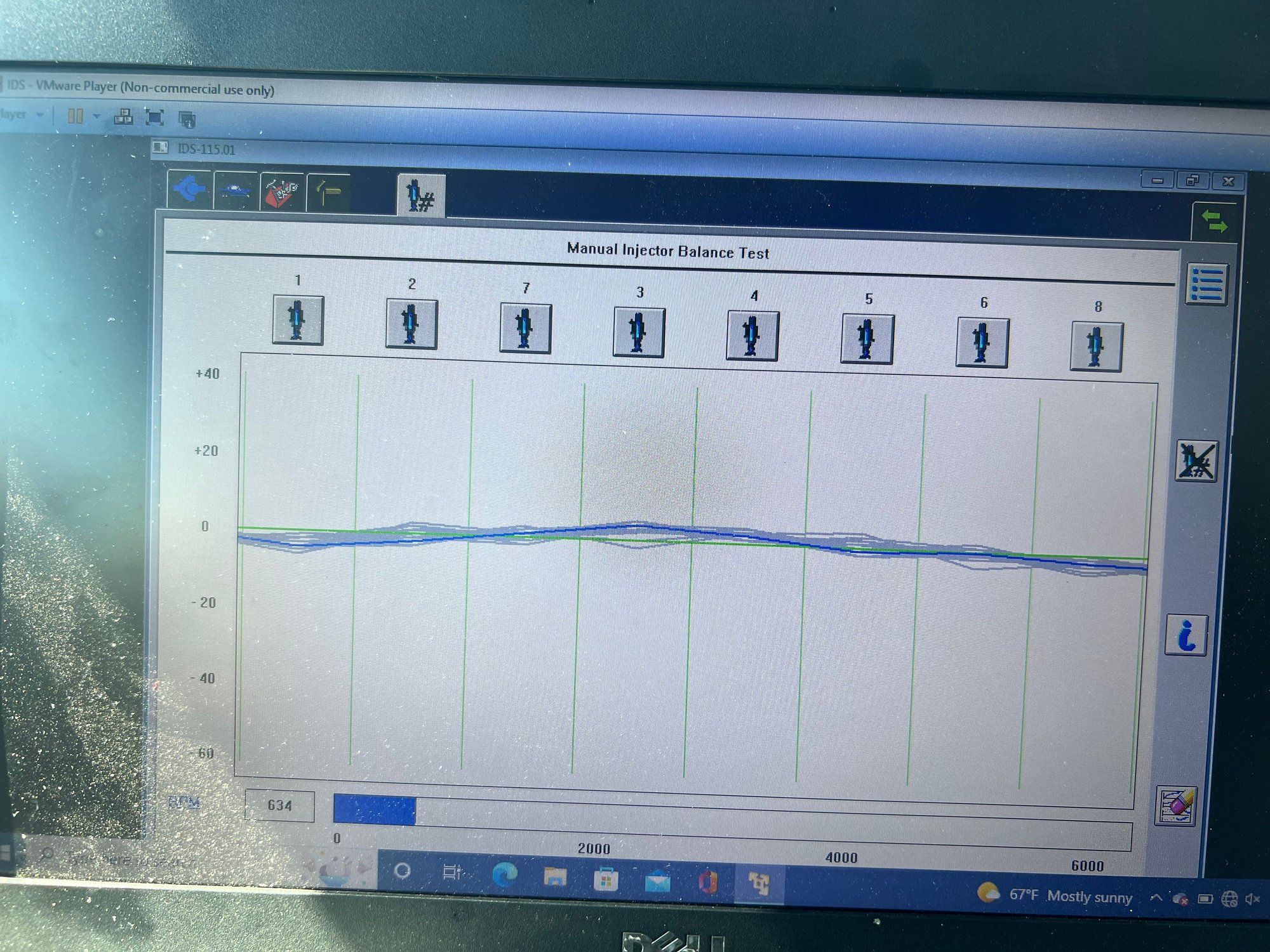

After a 2 hour trip. Cylinder #2 injector seems a little suspect. Maybe I should have replaced that one too in hindsight. Or maybe at this point I’m chasing perfection down a rabbit hole…… LOL

You could but...
Myself, I would be happy with that trace.
How does it look cold?

I too would not have a problem with that trace

ride it.
Whats your ICP and IPR numbers when running the test above?

Originally Posted by Hartwig
ride it.
640 ICP and 23.1%

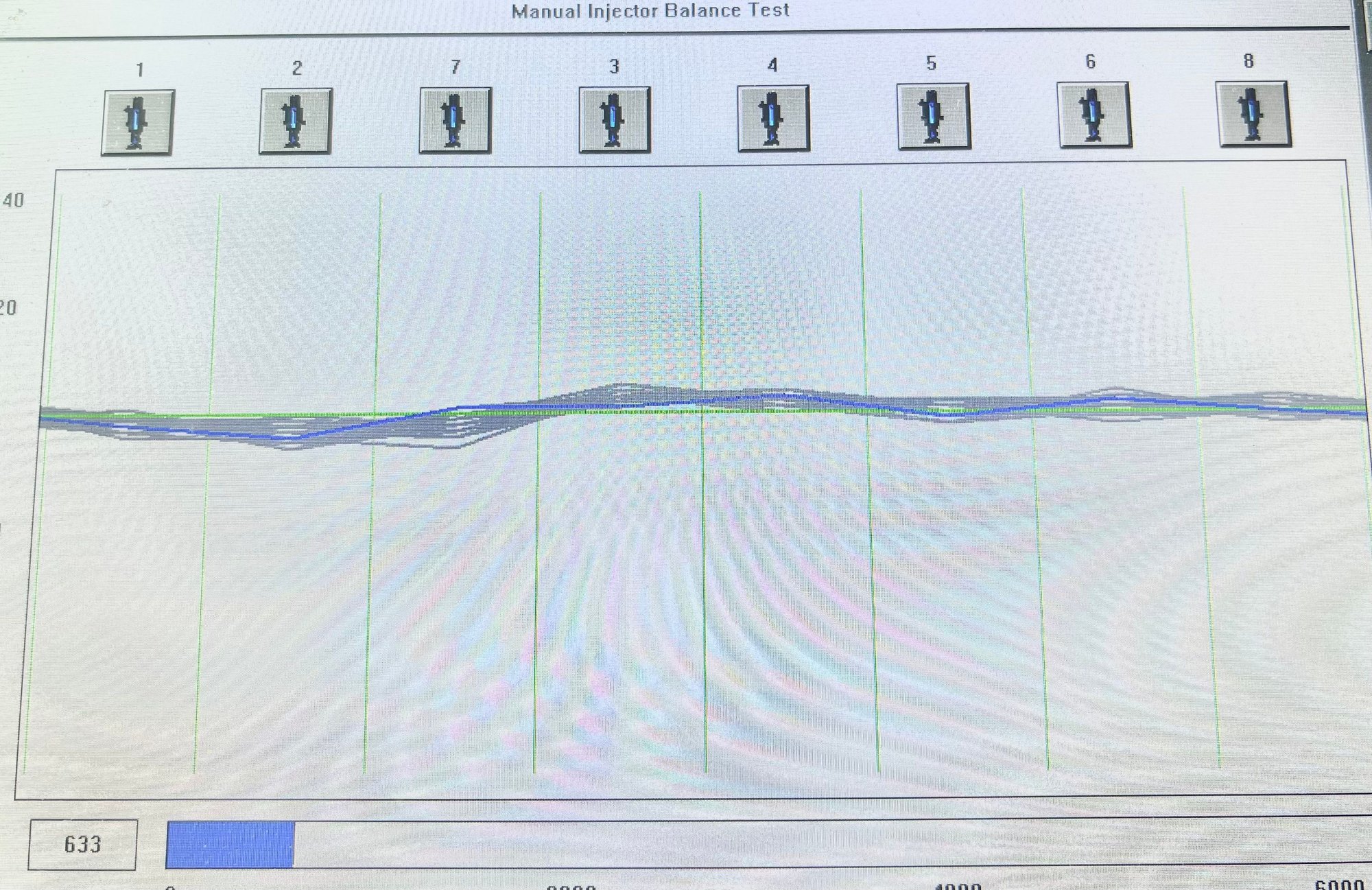

Originally Posted by Yahiko
You could but...
I’ll do a “cold” start and post it. Probably
is ambient here is not cold. I think ford says EOT below 70f is a cold start.
yeah maybe I’m chasing perfection. I noticed that the contributions seem to float around a bit. One may go a little low and the other a little high and then they switch. Nature of the beast. I’m just happy it’s code free and idles smooth as glass.

“Cold” start

From: Jersey Shore
Manual, that looks good.

From: Spanaway
Looking very good.
Now get out and have a fun time. Work that truck.

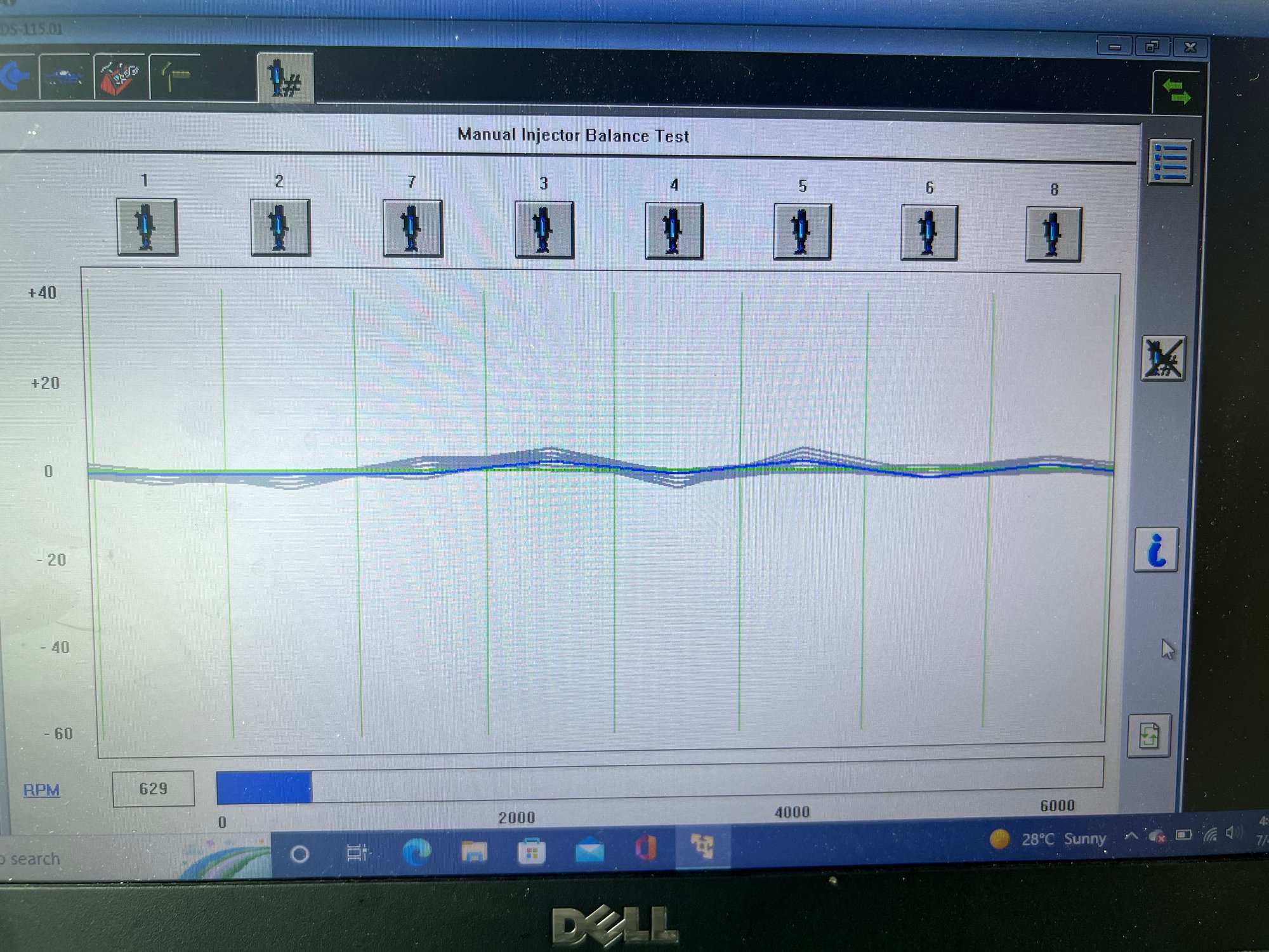

Latest hot power balance. No more codes running fantastic very smooth.

From: Spanaway
Very nice. I would be more than happy with that trace.
Now go have fun and drive it.

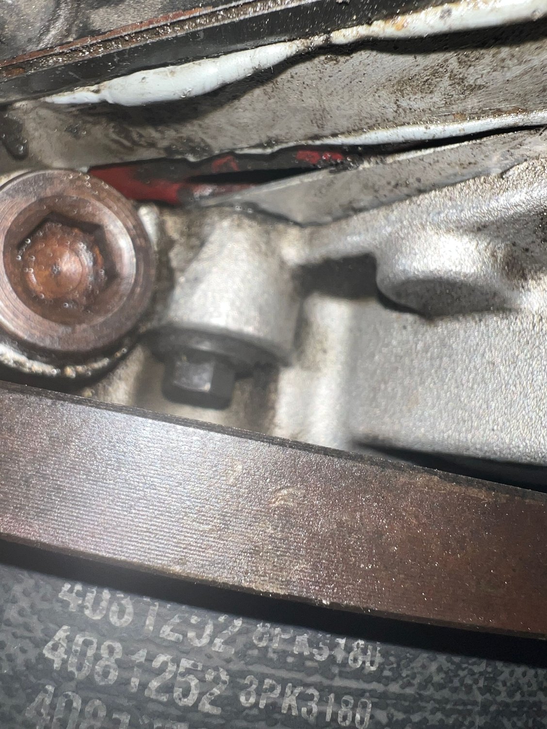

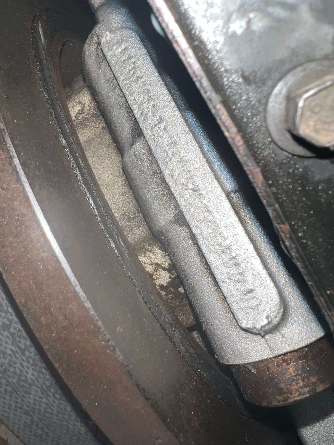

Update: truck has been running good. I have about 5,000 miles on the overhaul. Noticed a little oil after a 6 hour trip down by the front cover regulator spring. Nothing crazy but a few drips. Could be the front seal hard to say. I noticed I’m about a quart low. Engine is consuming some oil still. Blowby seems ok though. I seem to be collecting oil in my intercooler piping.
could this be a turbo charger oil seal issue?
