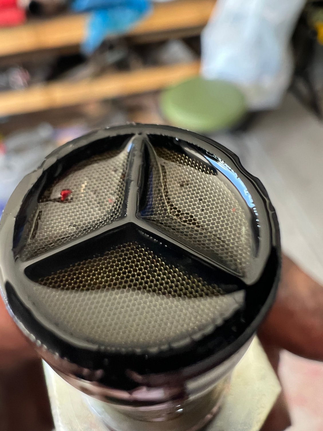

Some minor debris

here is what I got so far, ICP is ok, I removed IPR in previous post showing minor debris. Maybe I should install the old IPR and try to crank the engine. The problem now is my relocation kit made impossible to get my IPR socket onto the IPR with the hose assembly in the way.
im waiting on my air test fittings to show up
tomorrow. Then I’ll know what happening.

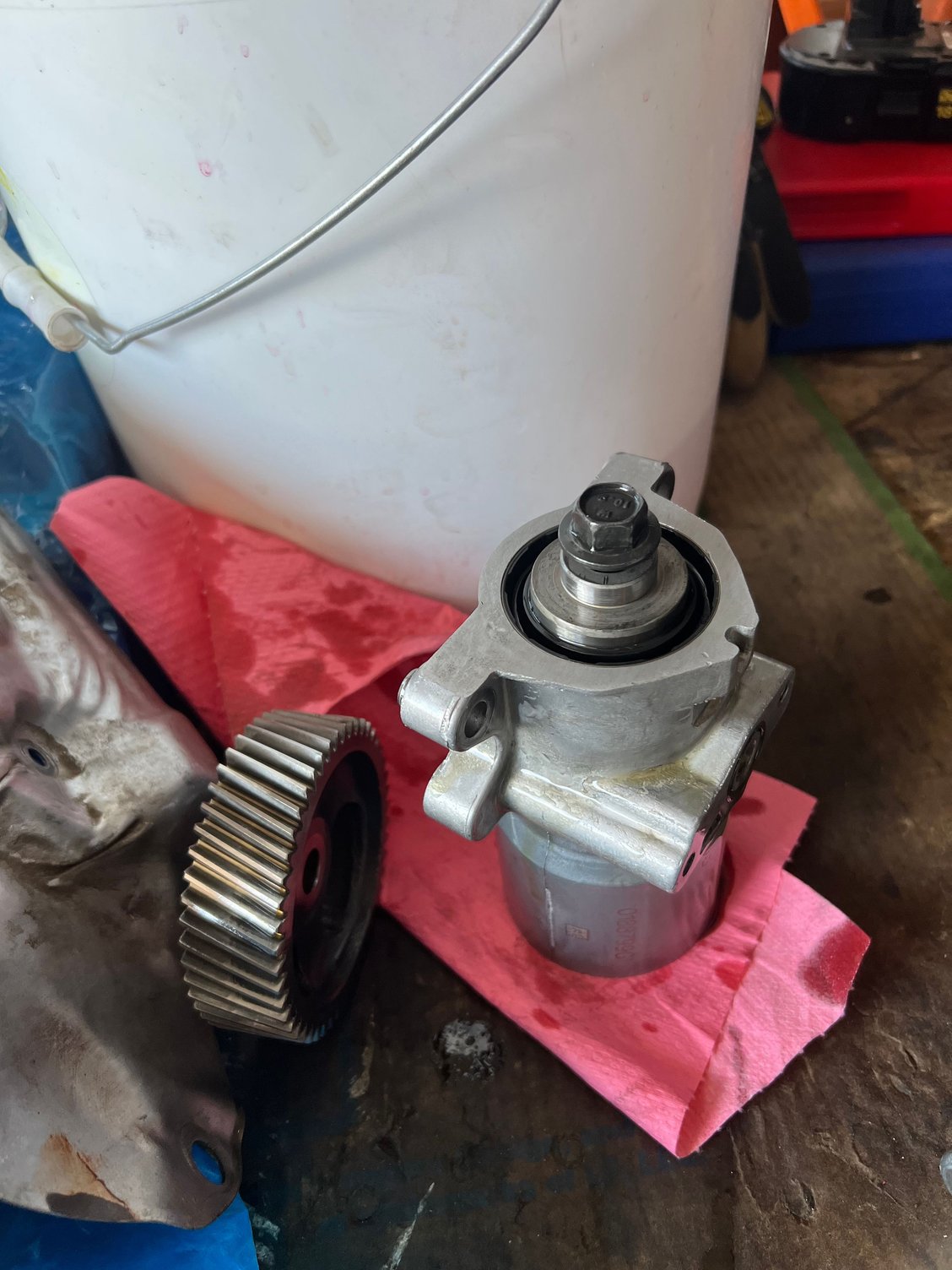

We’ll I found the problem, the damn gear was spinning on the HPOP shaft. Somehow the gear must have got loose and spun when the truck downshifted and rpm’s came up. When I touched the pump I felt the gear very loose.
I’m not sure I want to put it back in at this point with the labor and time invested.
Just freewheeling along. I just ordered a CNC Fab Stage 1 to be done with it.

Those are good HPOPs. With gear spinning on the shaft, I’d be done with it.
Is there any key or dowel with that gear?
Old May 24, 2022 | 07:11 PM
  #433
blicharski1989's Avatar
blicharski1989
Joined: Oct 2021
Posts: 478
Likes: 194
nope. doesn’t even fit that tight. Now the camshaft and cam gear that was a tight fit.
I was thinking the same also.
No key???!!! Just a press fit like the swash plate. I think I would be asking for some details
on the higher end pump to be sure that this can't happen there also.
On the up side. You now know what the issue was. Sucks.
true! It was much easier to take this apart that everything was relatively clean and fresh. TA-31 has what jack would say a tenacious grip! Holy moly I used some on my hpop cover for extra insurance. It took some serious coaxing to get it to budge.
overall it’s a blessing in disguise as this could have happened down the road with the family and one Angry spouse.
