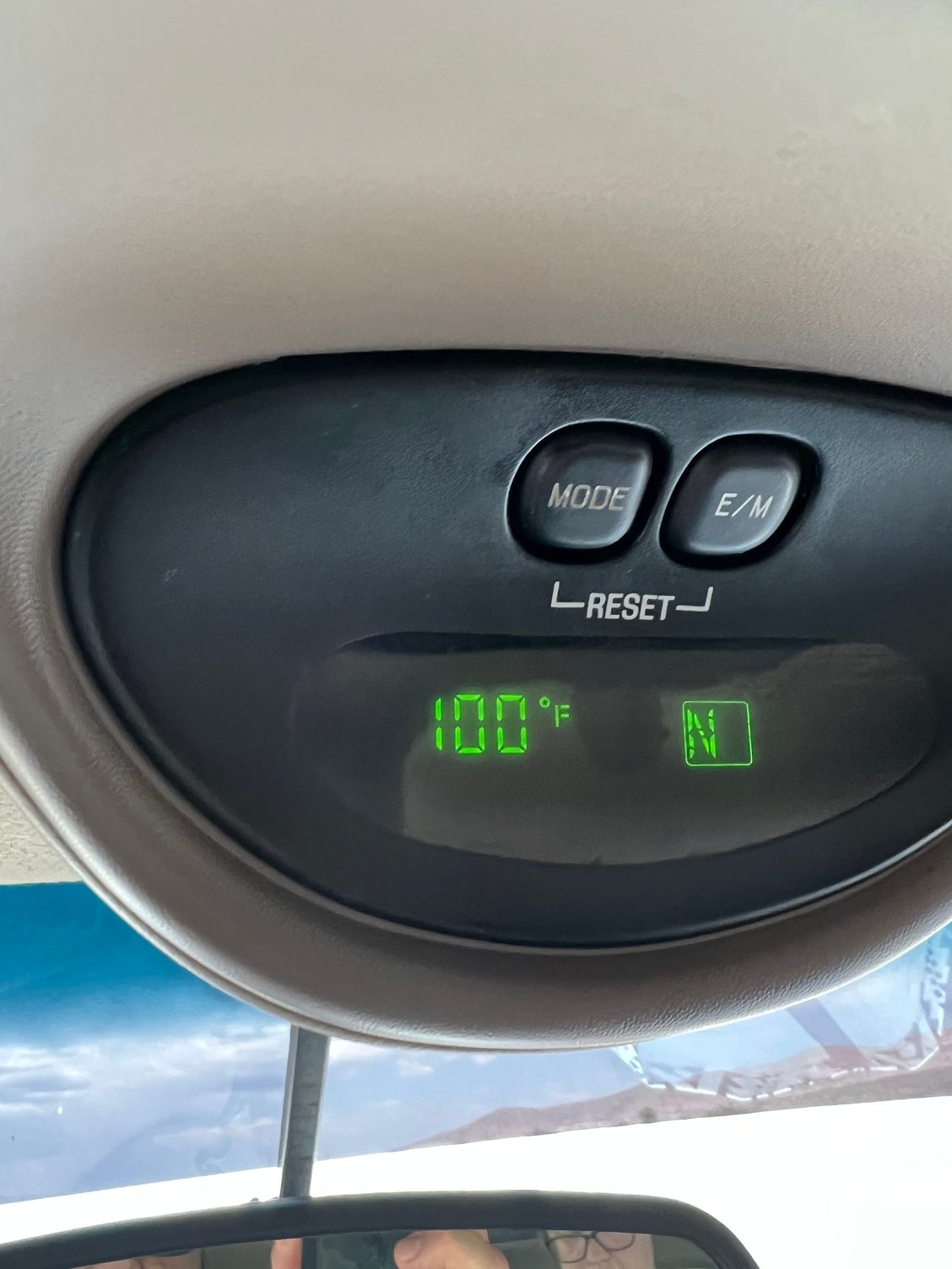

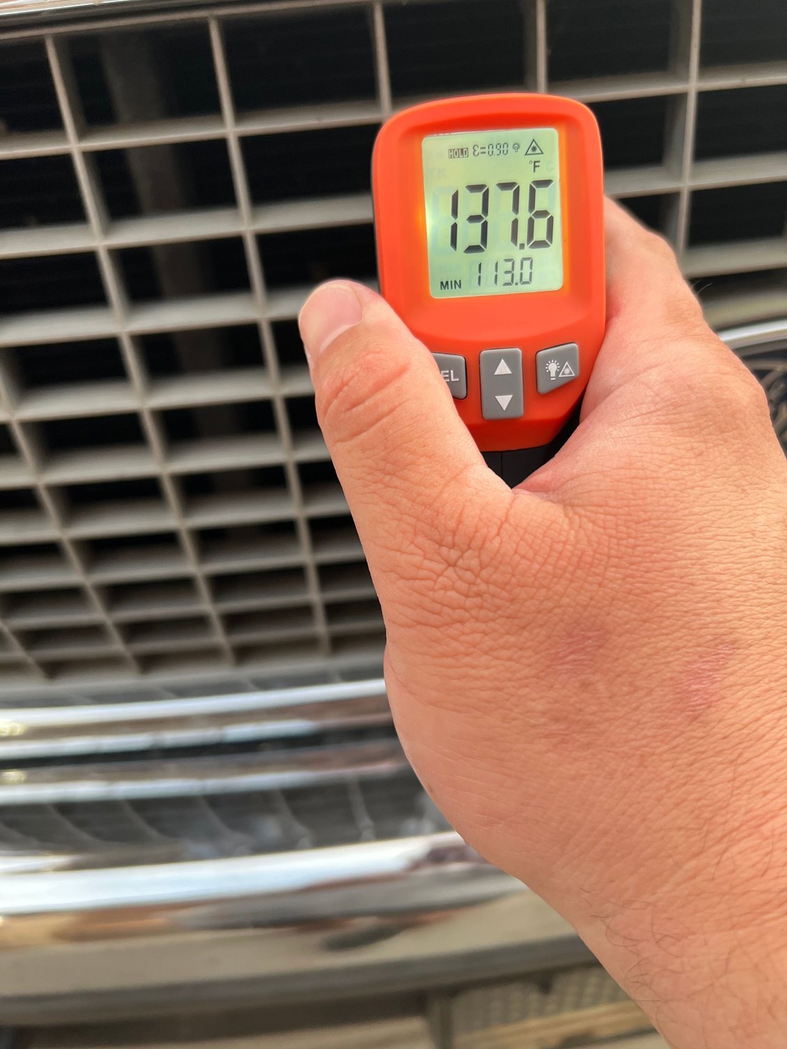

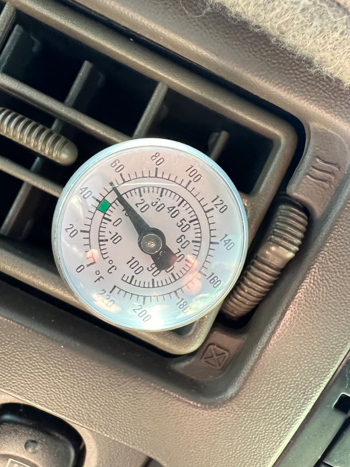

AC system is not working quite as well as it should? I’m back in AZ for 10 days on a family trip, I don’t remember how the excursion worked out here as we didn’t have it long before we moved
ambient 105f
low side 52-55 psi
high side: unknown don’t have my gauge set with me on this trip. Based upon a 137-140f condenser temp it would be 220-230 psi
Vent discharge:65-70f
that’s a delta of 35-40 degree F which in my head is pretty good but I would like the temperature out the vents to be closer to 50~
below 80 ambient I can see my discharge temps on the vent approach 46-48f
Max air center vent
Condenser temp
deg F

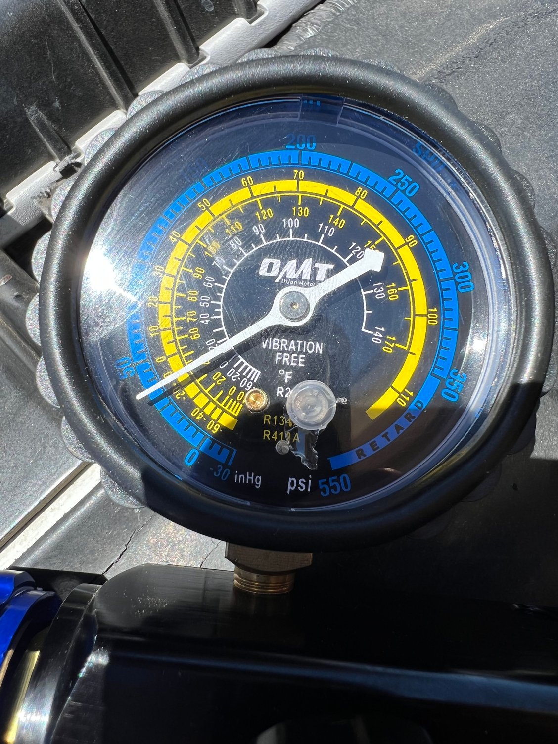

I had some Freon recovered from the system and got my low side pressure down to 45 psi instead of 55-60.
Another warm one
New discharge temp with less refrigerant. Need my gauges to be able to get the whole story. An improvement for sure. Probably going to recover the whole system and start over. Not sure if the compressor is really bad. A good flushing and starting over work the oil may help. Don’t have any comparison data to see how the performance is.

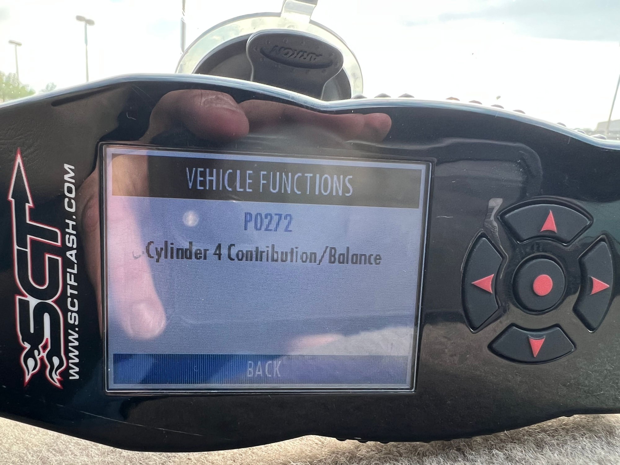

P0272 comes back at idle on stock tune can feel a occasional hiccup at idle. Can’t feel it on the tunes. The difference maybe the stock tune idle around 640 psi and the tunes around ~1000 psi. Something to do with the injection pressure and number 4 injector. Leaning toward the oil rail check valve. Got the new one in hand for replacement

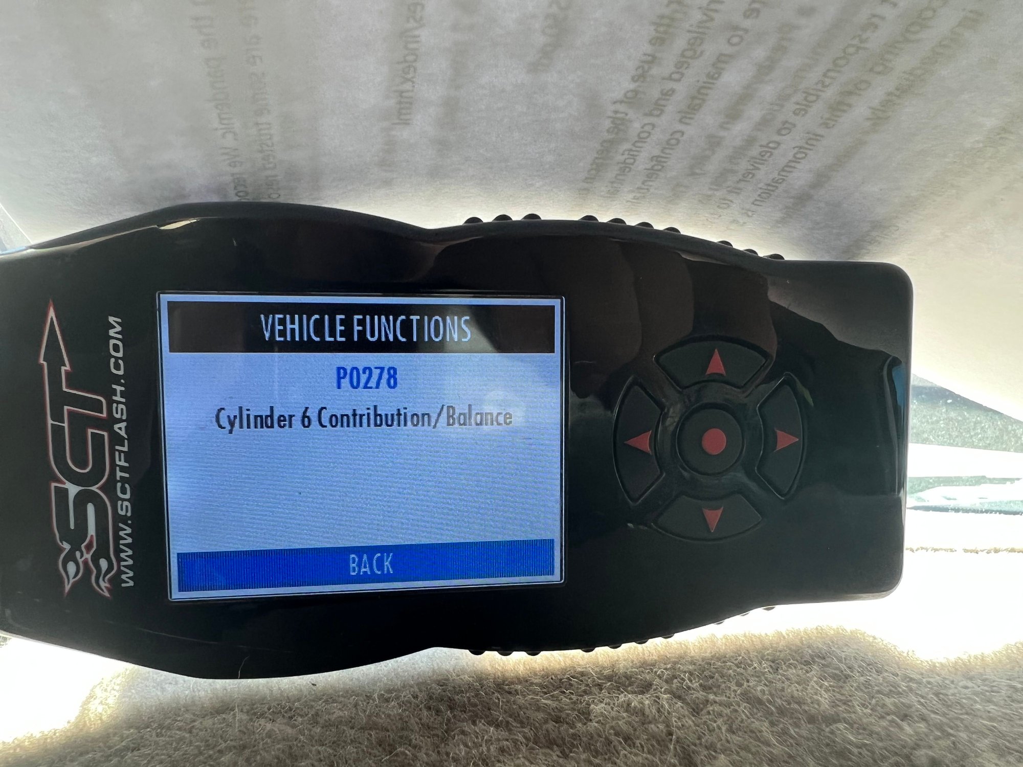

So this morning on the way to an appointment I noticed that after returning to stock tune Cylinder 4 contribution cleared out but now it’s Cylinder 6. Two bad new motorcraft injectors next to each other? Maybe some compensation is making it hard for PCM to know who’s truly not contributing enough?
HPO system is almost completely rebuilt and IPR/ICP look great. Only really detectable at idle with a slight feel not always present. Usually when hot. Noticed a little extra white smoke when cold but clears out once above 100-120f.
Ordered an IDS VCM2 clone hopefully I can get some answers. What do you guys think? I’m hoping a relative compression and power balance will point me in the right direction.
Could this be a FICM issue? Voltages check out but im kinda lost until I get IDS. No cold start issues. It does seem to have a little more white smoke when cold than previously. Not heavy smoke but a light haze. Seems more pronounced when hot.

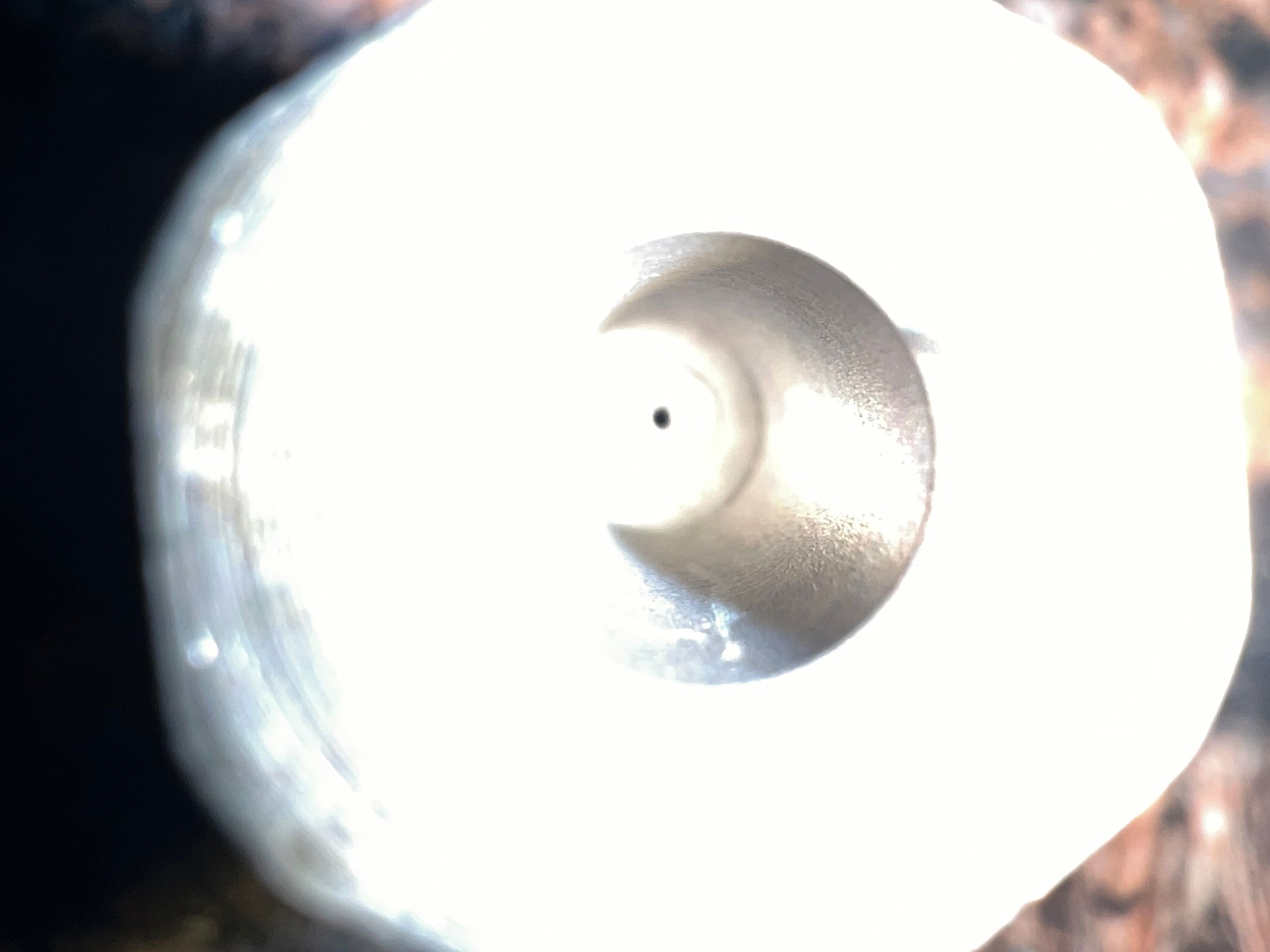

New check valve
New check valve
Orifice shot

High side pressure 90F ambient
Low side pressure 90f ambient. Feeling good. 40-46f coming out the vents. You can see a difference between the TXV system on the rear evap vs the fixed orifice tube. Overall system is working good and I’m done messing with it. Over charged definitely can hamper your vent temperatures. These systems are a little finicky it seems but once dialed in things are pretty good.
