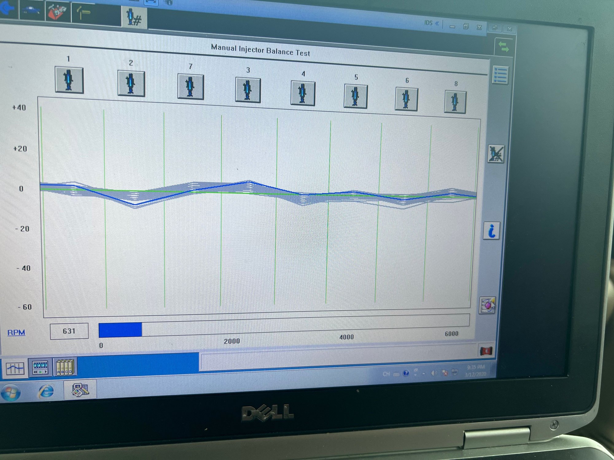

i would think the opposite cylinders adding excessive fuel are compensating to keep the engine speed up because of the anticipated weak cylinders. Maybe I’m wrong? To me it seems 4 and 6 are causing issues. Number 2 maybe a very small amount at idle.

194f warm test. Running the blessed performance eco beast tune. 640 rpm idle and ~1000 psi injection pressure at idle.

re ran my bubble test when hot to confirm there was no combustion gases going back into the fuel side. What are the chances of 3 faulty motorcraft injectors out of the box ending up on the same oil rail?
FICM or oil rail check valve is my hunch. Back to work these past few days so My time is more limited.

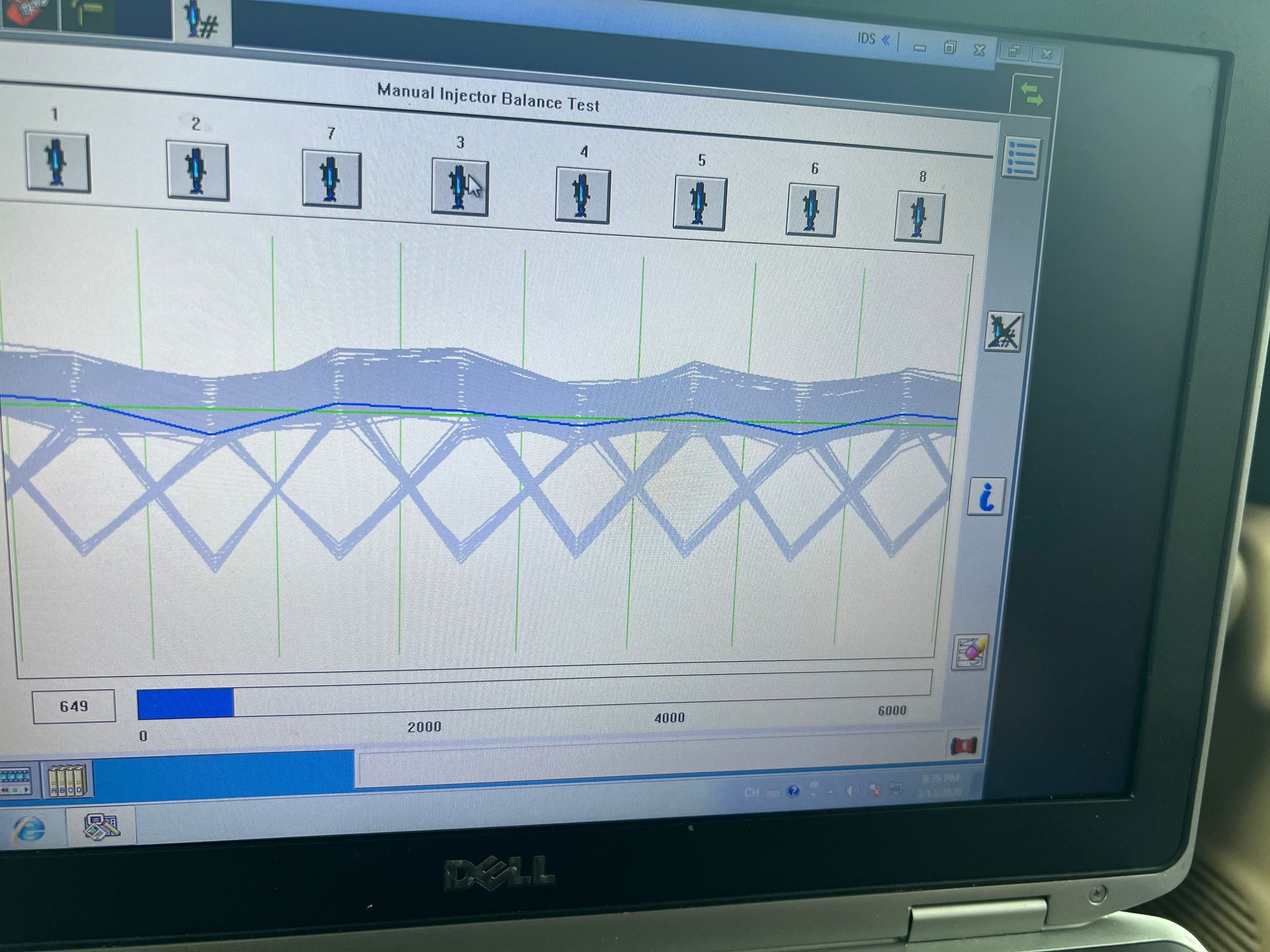

Old Jun 26, 2022 | 08:01 PM
  #599
blicharski1989's Avatar
blicharski1989
Joined: Oct 2021
Posts: 478
Likes: 194
Uncompensated after 35 minute highway drive. Cool ambient temperatures (72f). It seems to get worse when the engine is heat soaked. 2,4,6 seem to be consistent under performers. Hopefully doing the check valve install this week and trying some new injectors on 2 and 4. I almost wonder if it’s the ficm acting up when the under hood temperatures climb. It gets worse when the ambient is about 100+. Strange
Cylinder cut out
