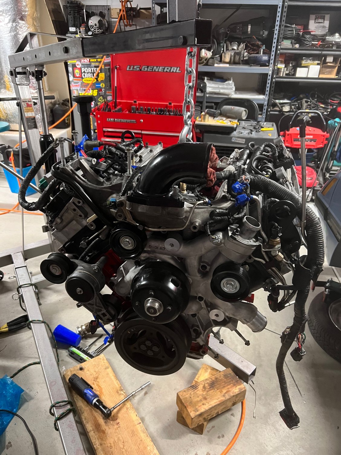

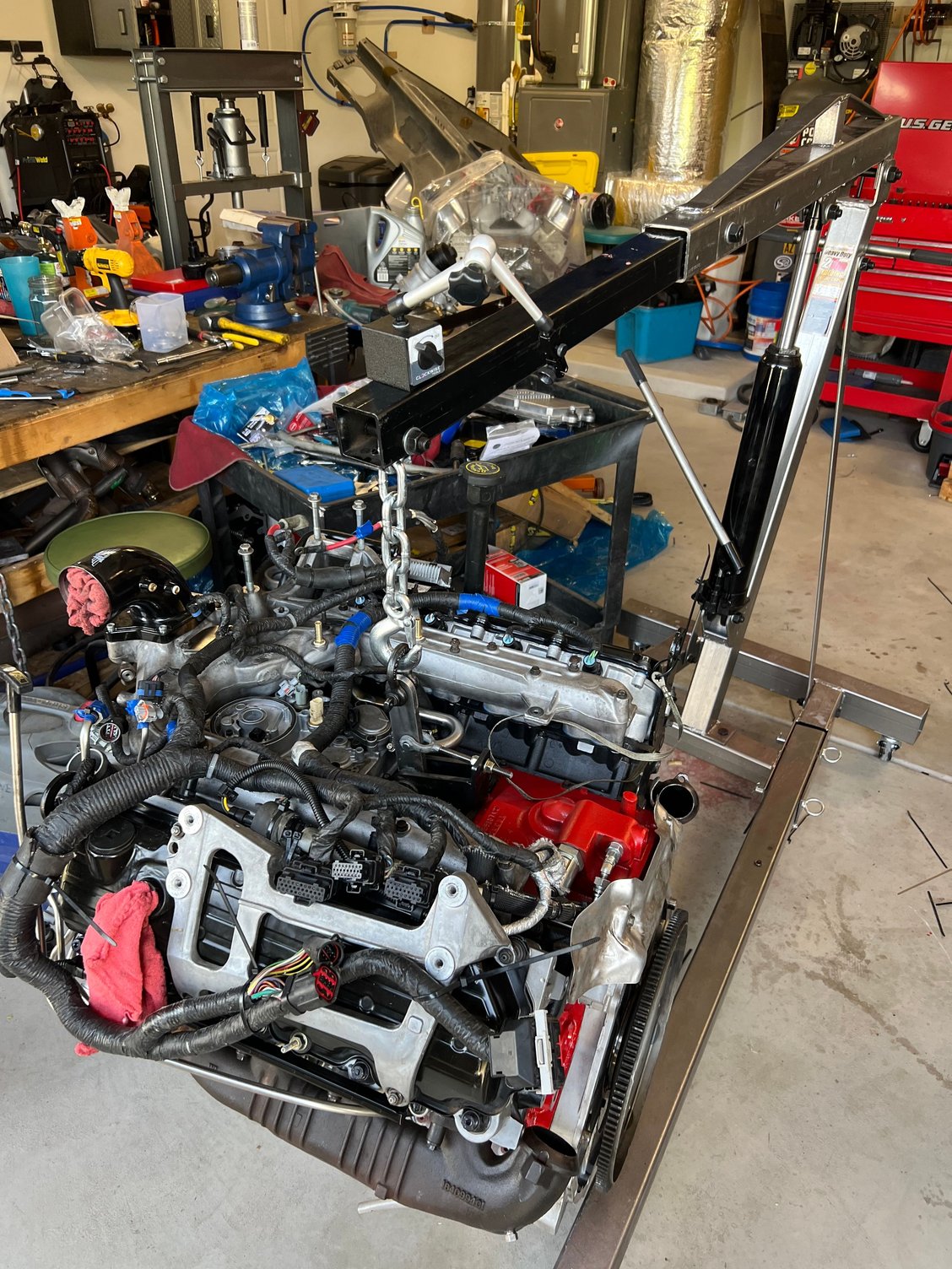

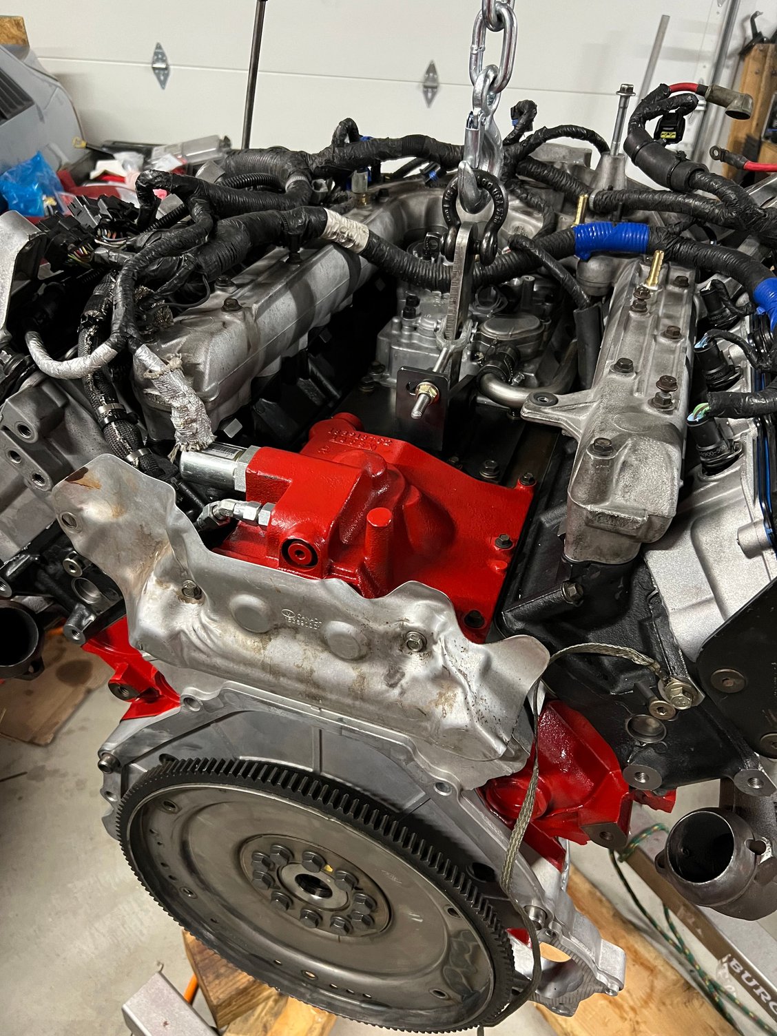

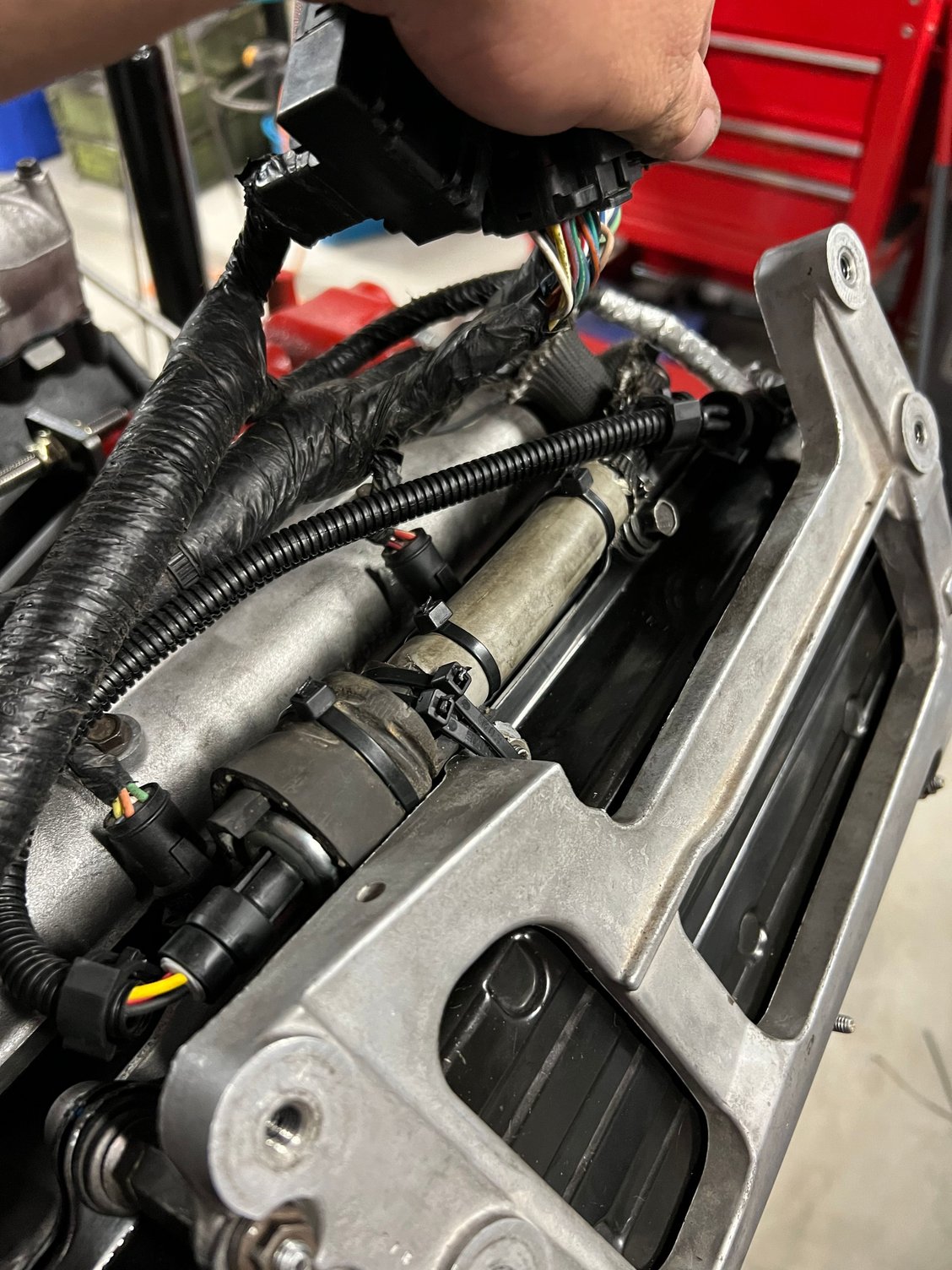

Ready to go back in

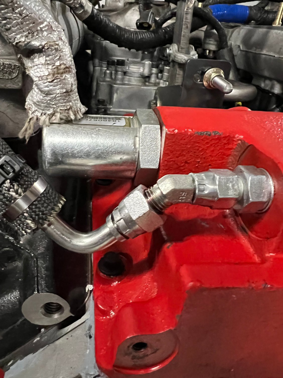

ICP relocate, decided to run it, used lock tite designed for sealing hydraulics
ICP new home with extension harness

Glad to see everything has come together so well and thank you for posting the photos of the remote ICP plumbing kit. Seeing these photos and the discussion last week actually made me pull my old notes out regarding this. I had originally machined an adapter for original ICP location to a female NPT thread.I need to look at the other half of the adapter.
Rob.

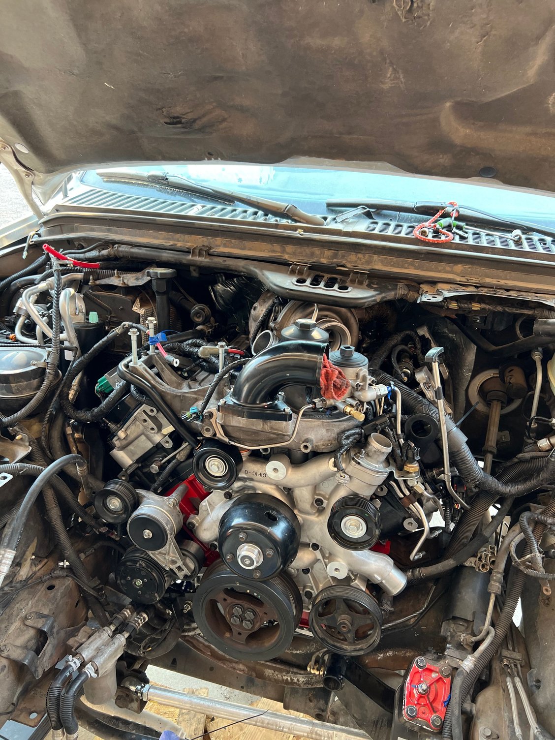

Feels good to have it back in the truck
Turbocharger back in its home
Wrapped my new up pipes hopefully it’ll make a dent in the heat load at the rear of the engine.
I forgot I removed the factory down pipe when the engine was out and now it’s almost impossible to get it back in. Ordered a 3.5” down pipe aftermarket deal to fix that since they are two piece and I’m not pulling this engine back out.
