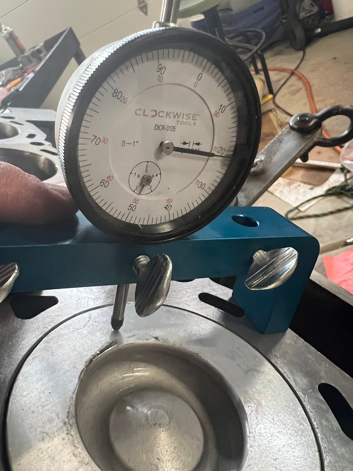

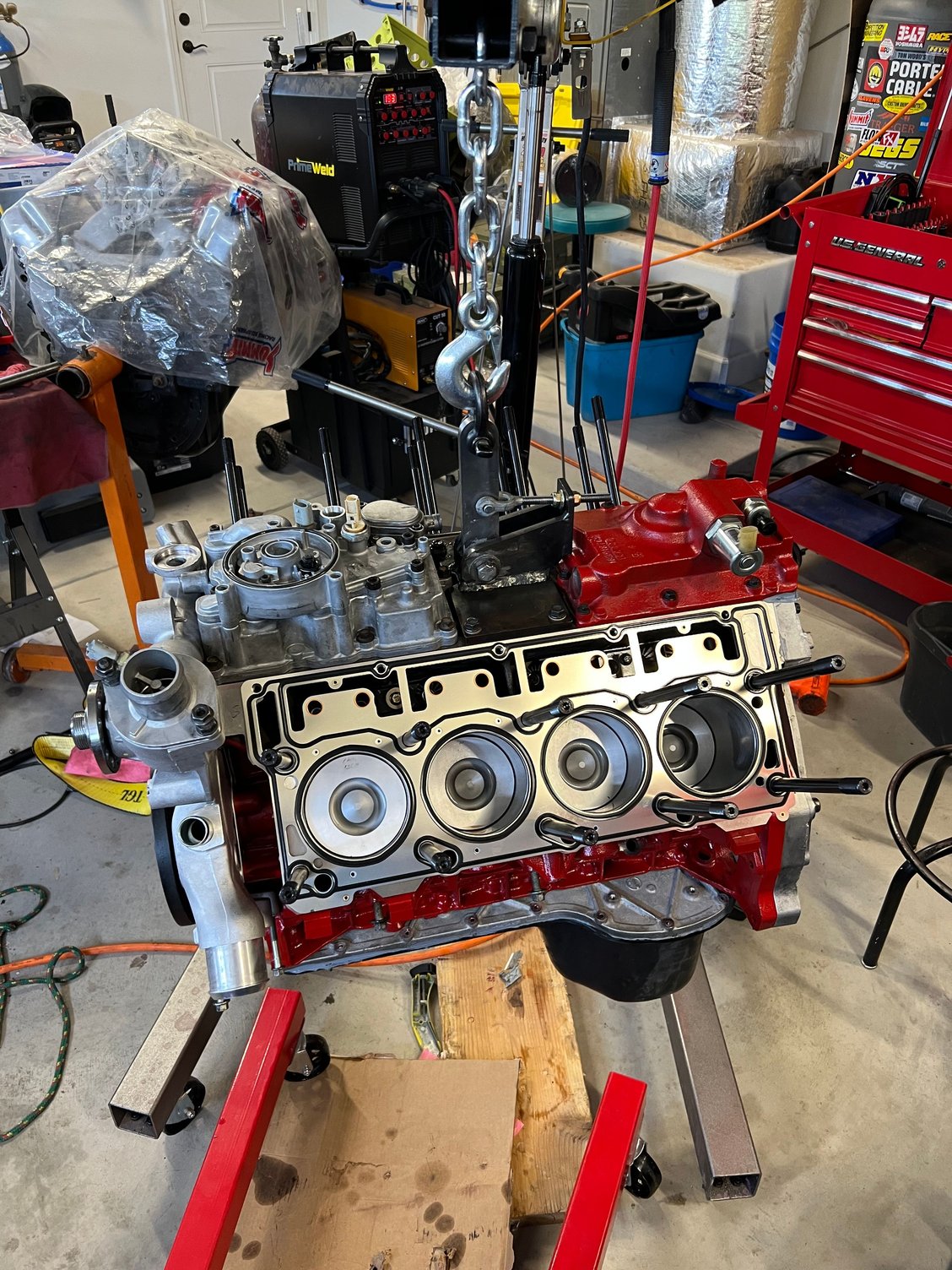

After a buzz in the CNC things are looking better
.021-.022” protrusion

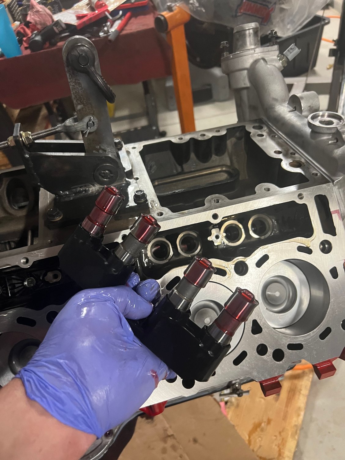

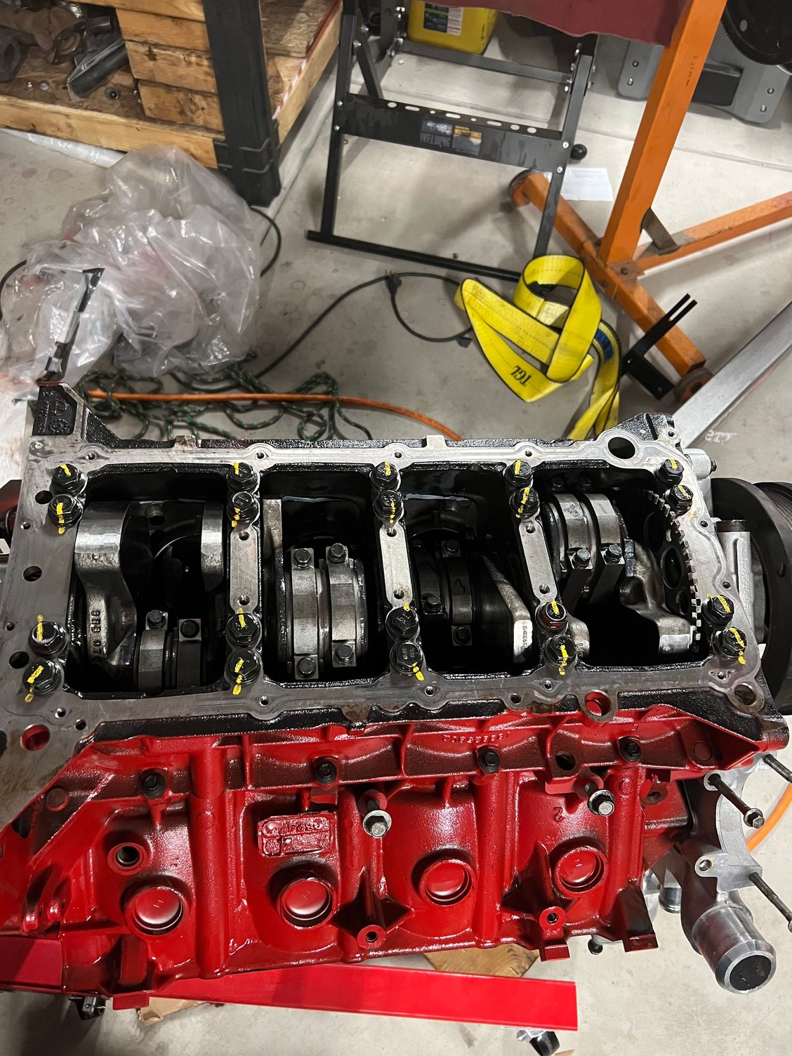

Mains n rods done
Oil pan adapter plate installed
Lifters going in
Getting closer

Getting closer! Need some heads to show up!

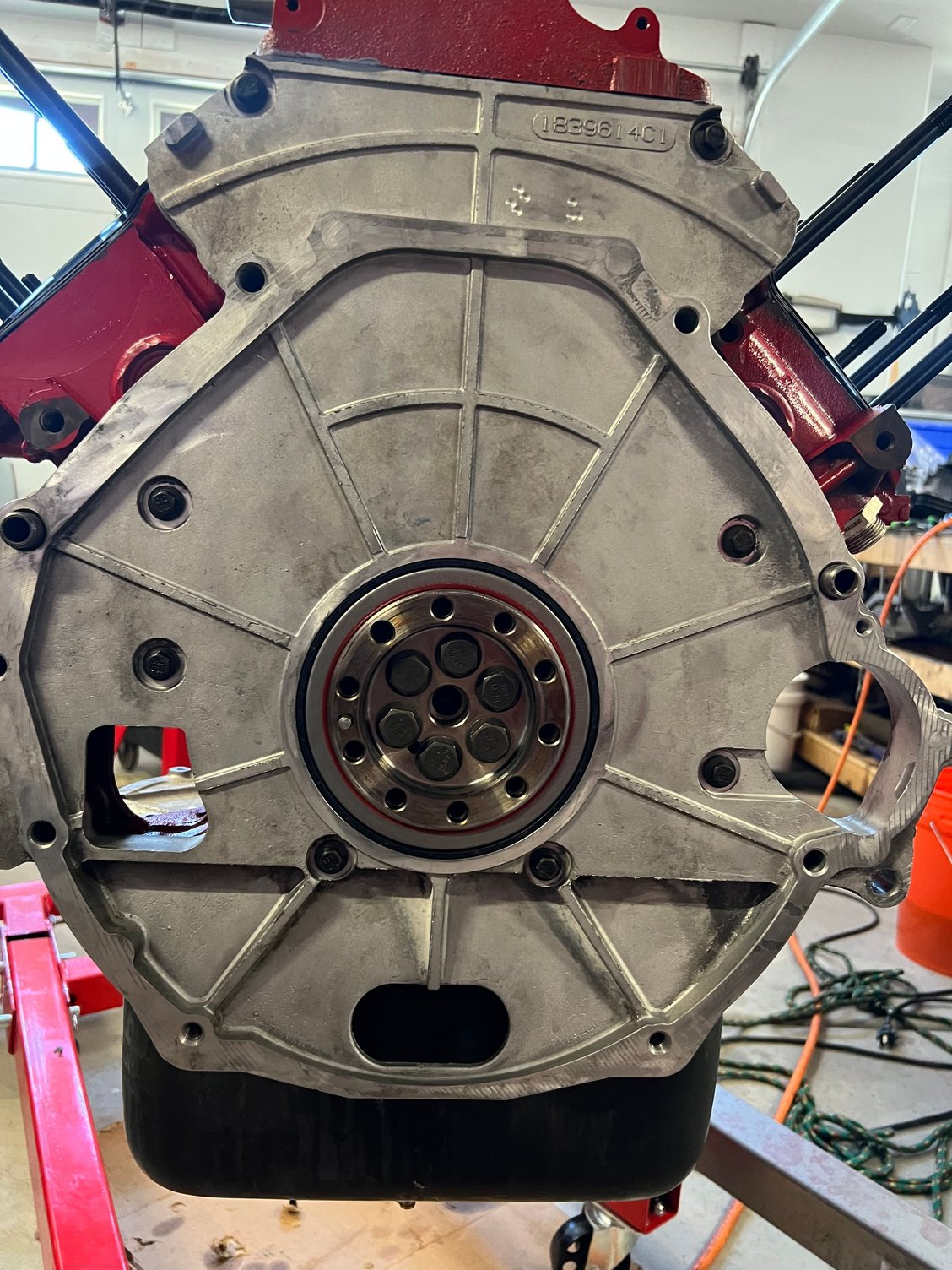

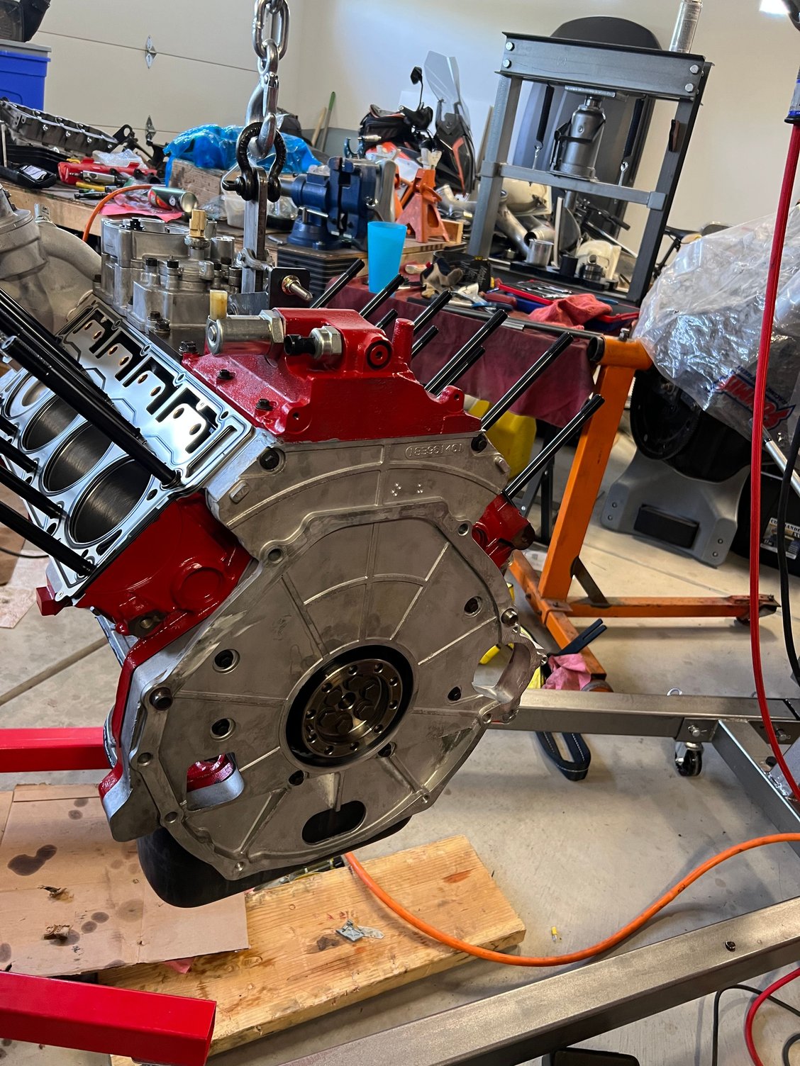

Rear cover installed minus seal

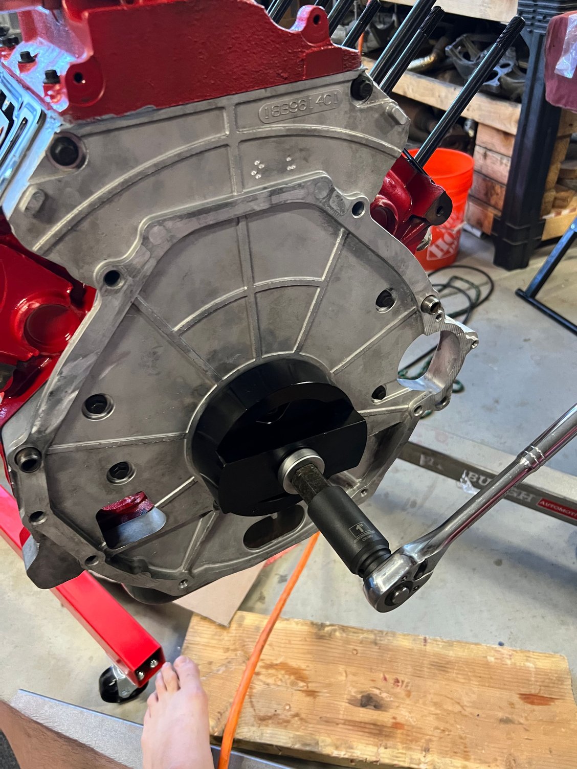

Rear seal installed
Amazon seal install tool. Went in smooth as better. I did a good job of cleaning the rear cover on the sealing surface.

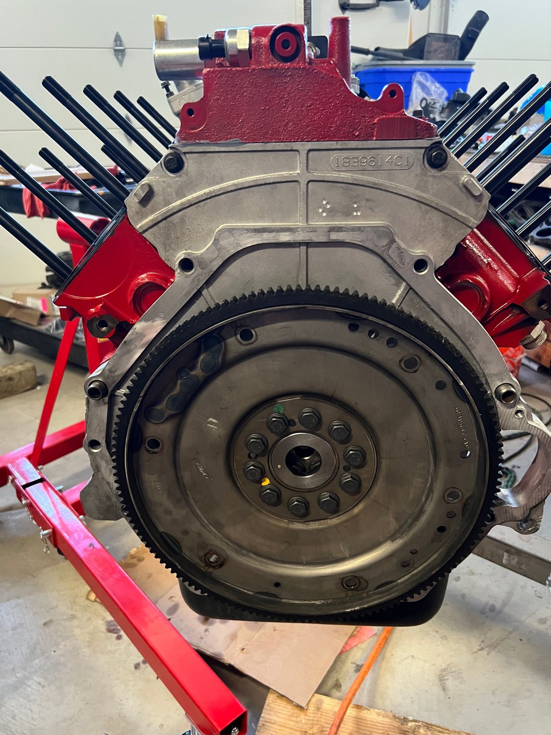

Flex plate installed and torqued to 69lb ft
