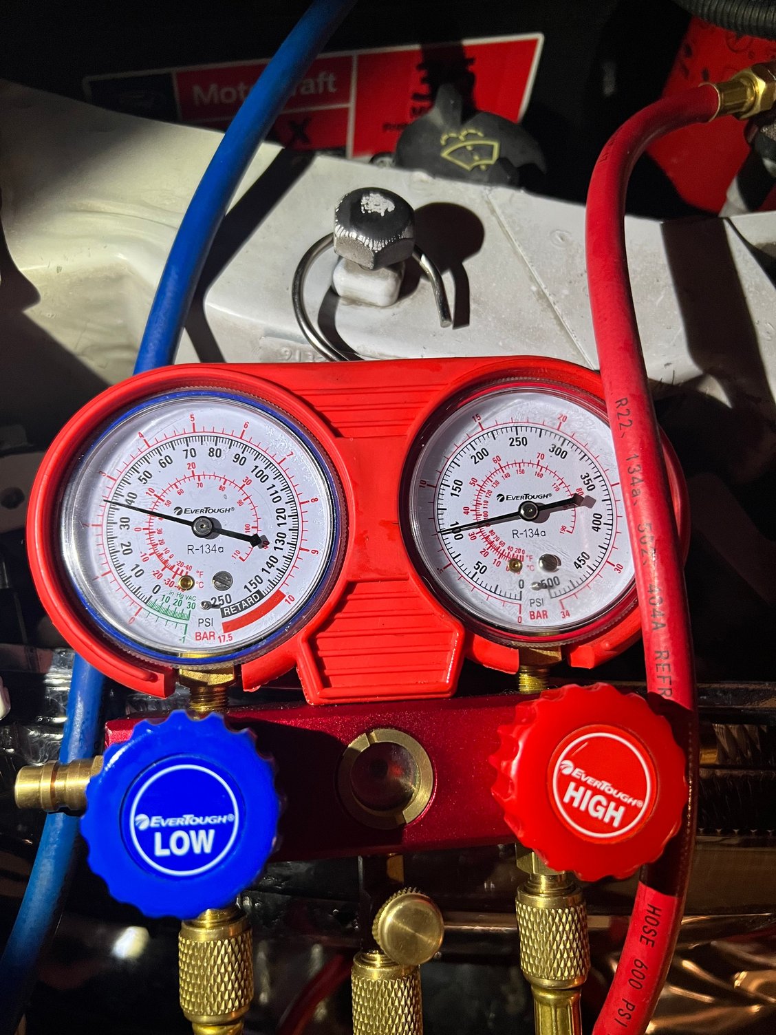

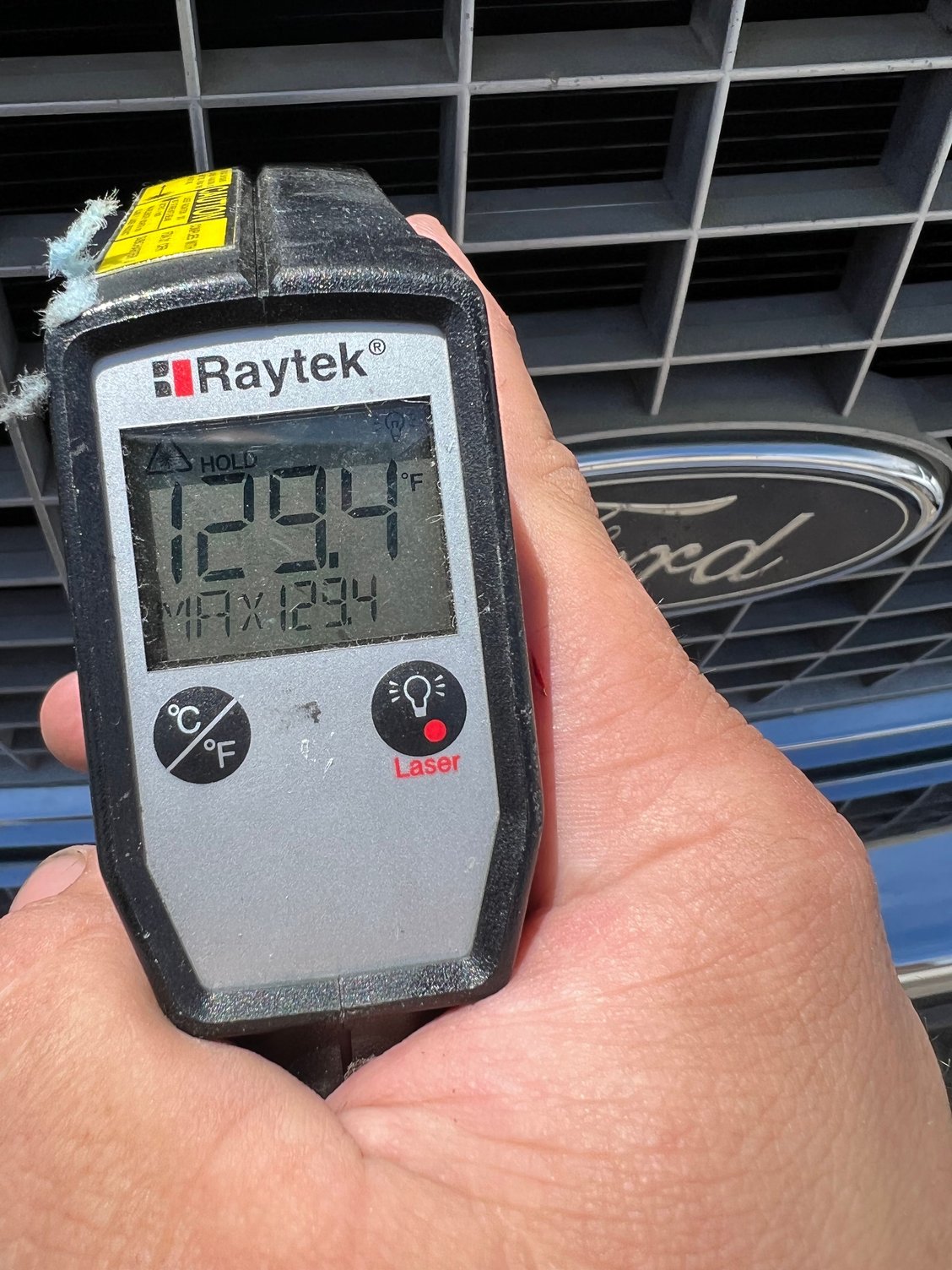

Last reading at an ambient of 79f Not sure why my high side pressure is low. It’s blowing cold air so it’s moving refrigerant. I expected higher pressure.
Condenser temperature
