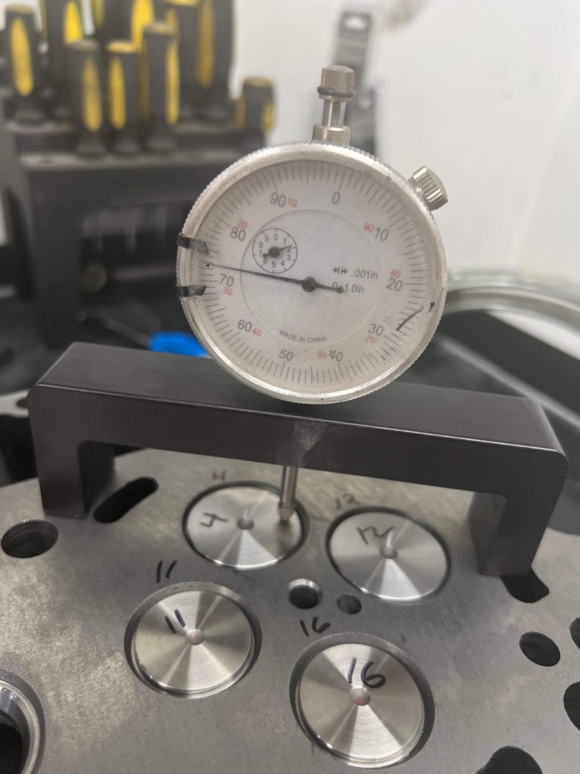

New heads on their way from PSC, much happier with these numbers
in the end it took longer than I would have liked but they made it right and that’s what matters. I think between my new valve recession .025-.030” and my modified protrusion of .021-.023 I should be safe with my colt cam stare 2

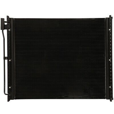

Looks like my new condenser motor craft YJ594 does not have the provisions for the rubber air dam pieces that seal off the gap between the core support and the condenser/radiator/coolers. I wonder why they didn’t install the little bracket on the sides of the tubes for it to mount ?
Motor craft unit I purchased
Aftermarket unit that mimics the side rails for mounting the air dam trim pieces

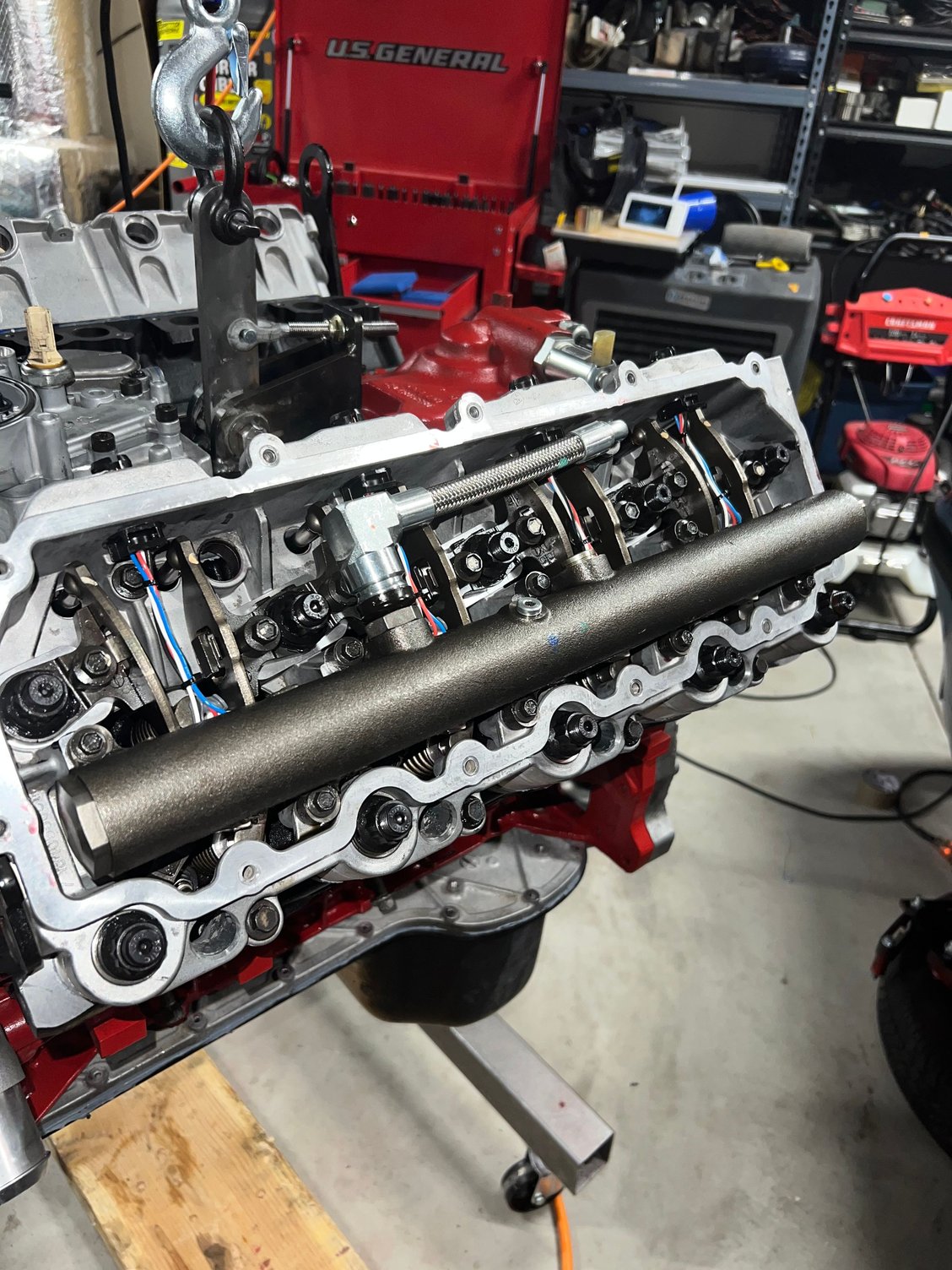

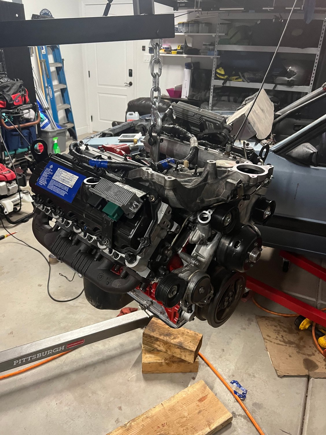

Getting valvetrain installed
One side complete
I stripped 3 valve cover bolt holes in the rocker boxes. 1 passenger side and 2 driver side. Ordered a M6x1.0 heilcoil kit.
I torqued them down to 76 inch lb but I guess those 3 were on their last legs in respect to the threads. Easy to fix now while the engine is out. I also dropped my GPCM and broke one of the plastic connectors. Oops. I’m just happy this engine is almost complete.

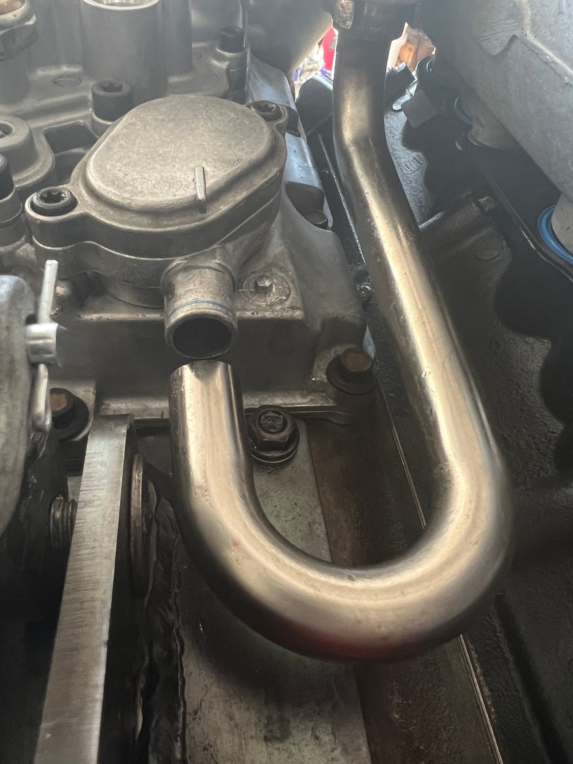

Heli-coiled both valve covers so I wouldn’t have to deal with stripped rocker boxes again.
Hmmmm doesn’t line up too well?
Yikes
Yikes
Never had one of these delete kits that fits perfect.

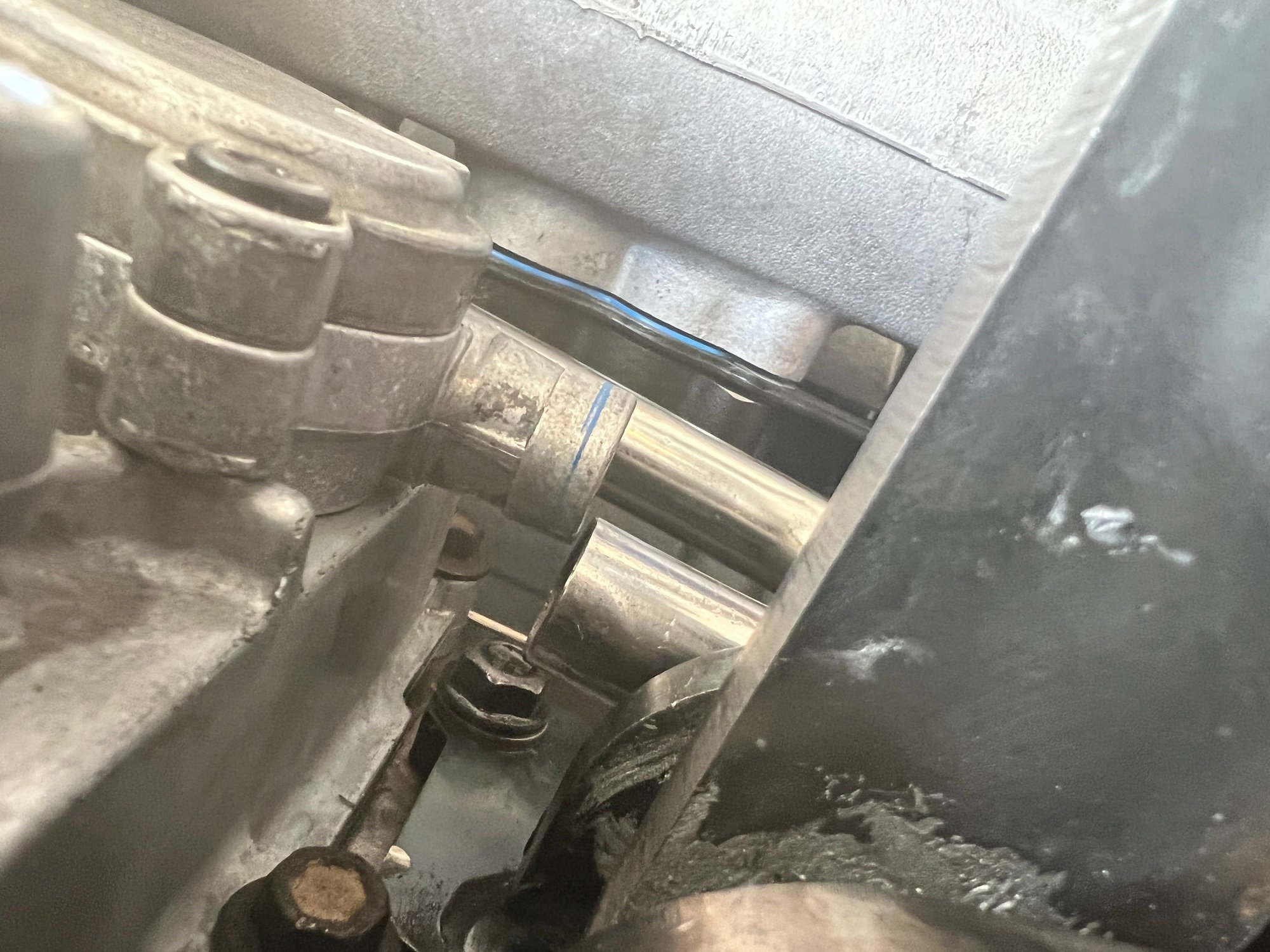

That’s better little massaging
They seems all to come from China.
yeah the original fit up was bad china man need better jig it’s not that hard. I had to use a torch and bend the pipe a bit but then it cracked the bad weld around the flange so I had to re Tig it.

Which ICP sensor relocation kit are you using?
Old May 13, 2022 | 12:23 AM
  #345
blicharski1989's Avatar
blicharski1989
Joined: Oct 2021
Posts: 478
Likes: 194
Dfuser kit. My only issue is the 45 degree elbow some how got bent/tweaked and it’s not seating very flush. I’ll run over to the hydraulic store tomorrow and get a replacement. Maybe it’s my fault or maybe the hardware is **** quality. I’m hoping the relocate makes life better down the road
