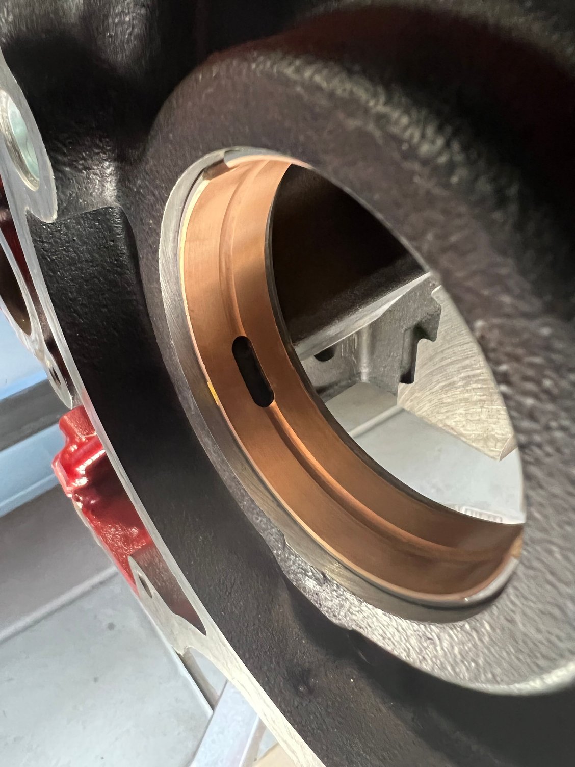

  #304
blicharski1989's Avatar
blicharski1989
Joined: Oct 2021
Posts: 478
Likes: 194
Cam bearing repositioned.

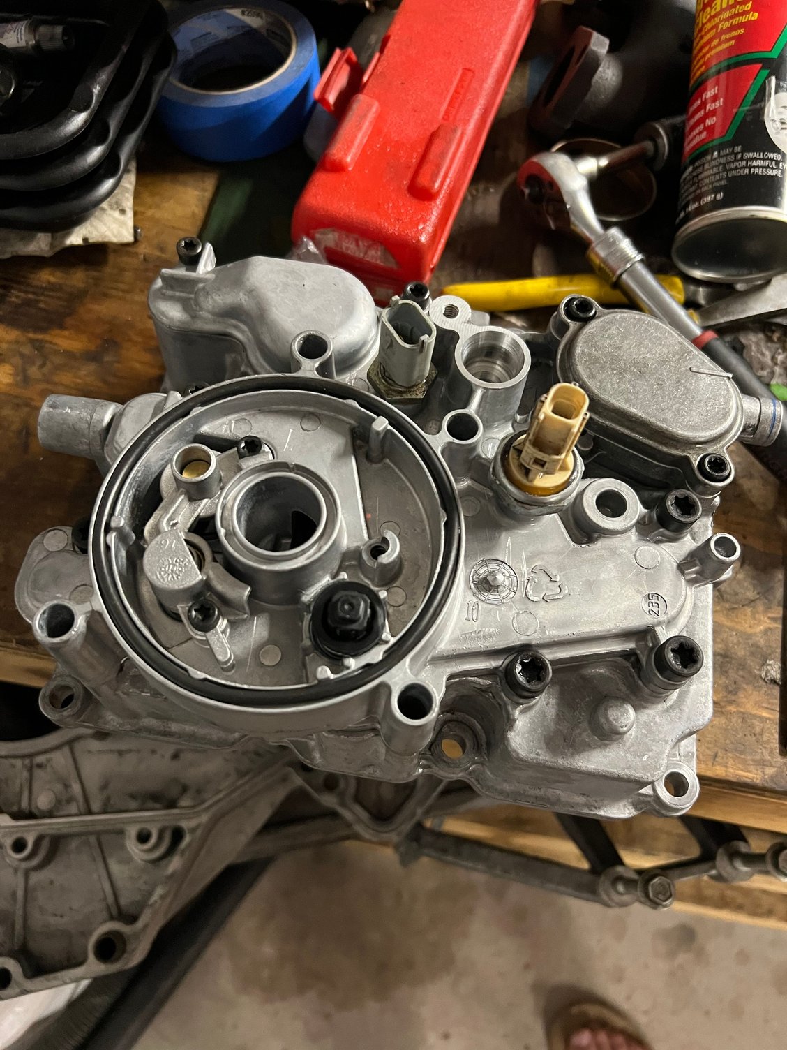

Old Apr 30, 2022 | 05:07 PM
  #310
blicharski1989
Joined: Oct 2021
Posts: 478
Likes: 194
Got the new oil cooler installed while I’m waiting for parts
