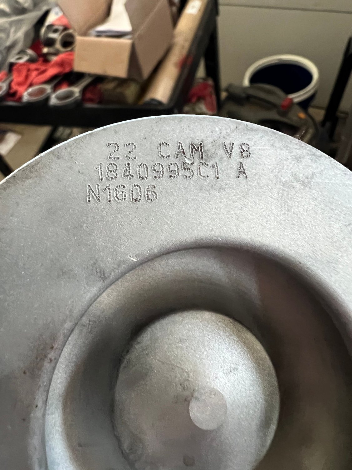

2003 piston ID

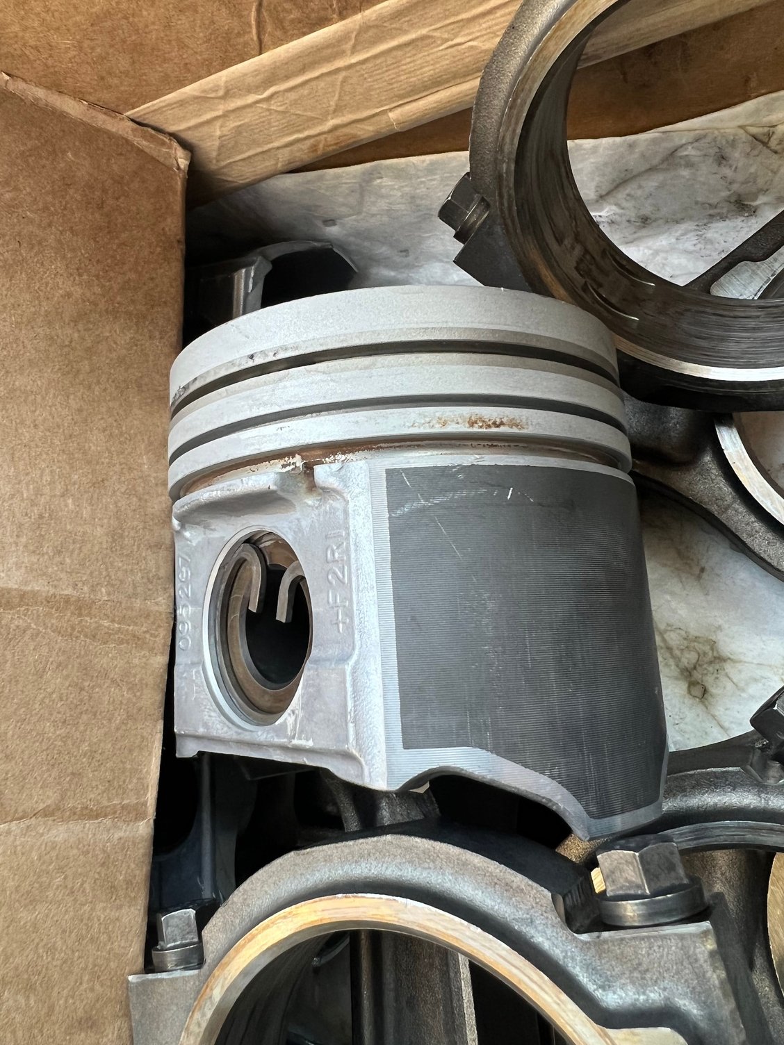

Skirt coating

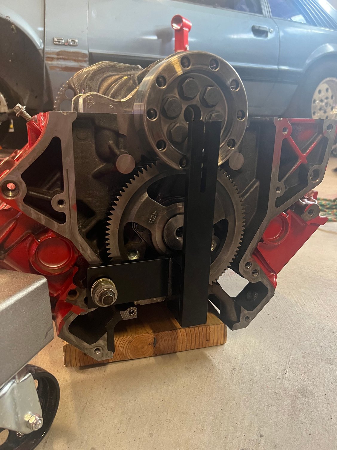

Timing tool

I spoke to Mahle who did the pistons for Ford OEM. The guy said the numbers on my pistons indicate they are from international and that’s probably why they don’t match spec. He mentioned they did the running change for 2004+
his advise was that I’m crazy and .004-.0056” was certainly in the realm of normal for a medium duty Diesel engine. He gave it his stamp of approval citing that the Cummins engines run much larger clearances without issues and i could get more cold noise but with how much racket a diesel makes it wouldn’t matter.

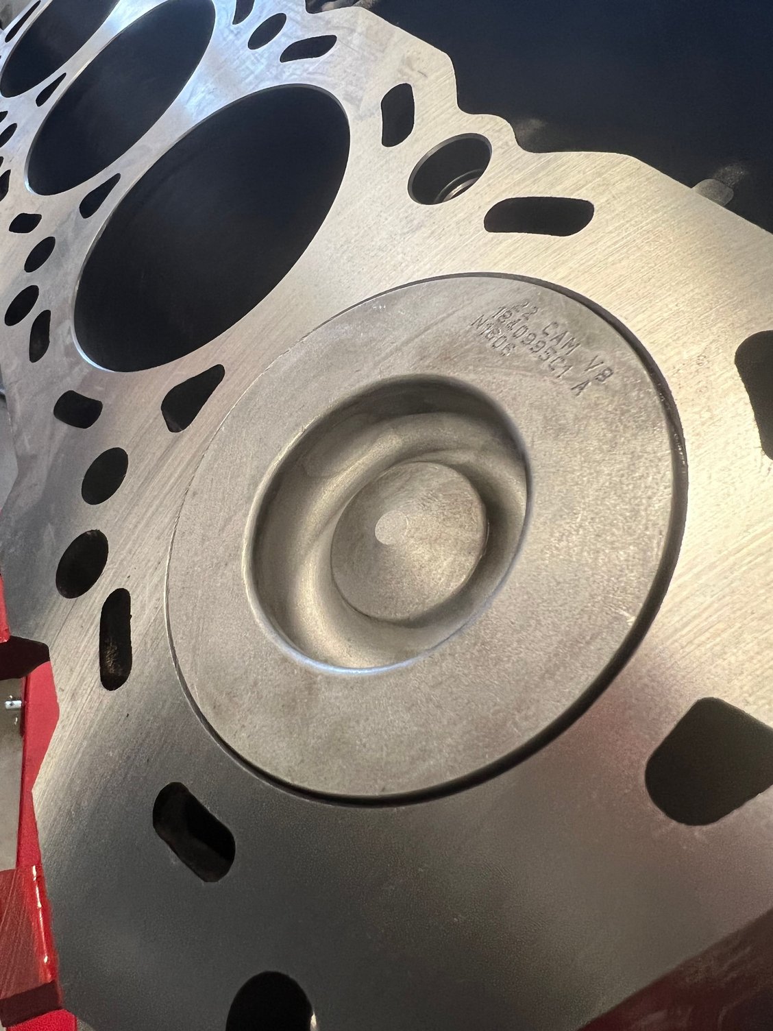

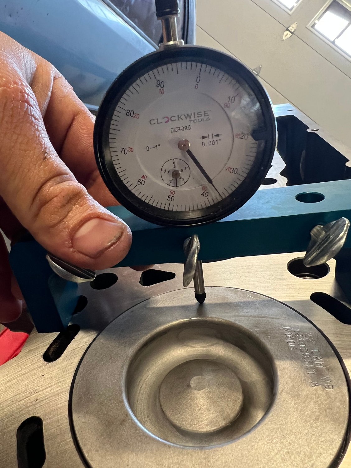

We’ll my answer for reduced compression height has been answered on the first cylinder. Placed an order with KDD for their new pistons with .010” height
