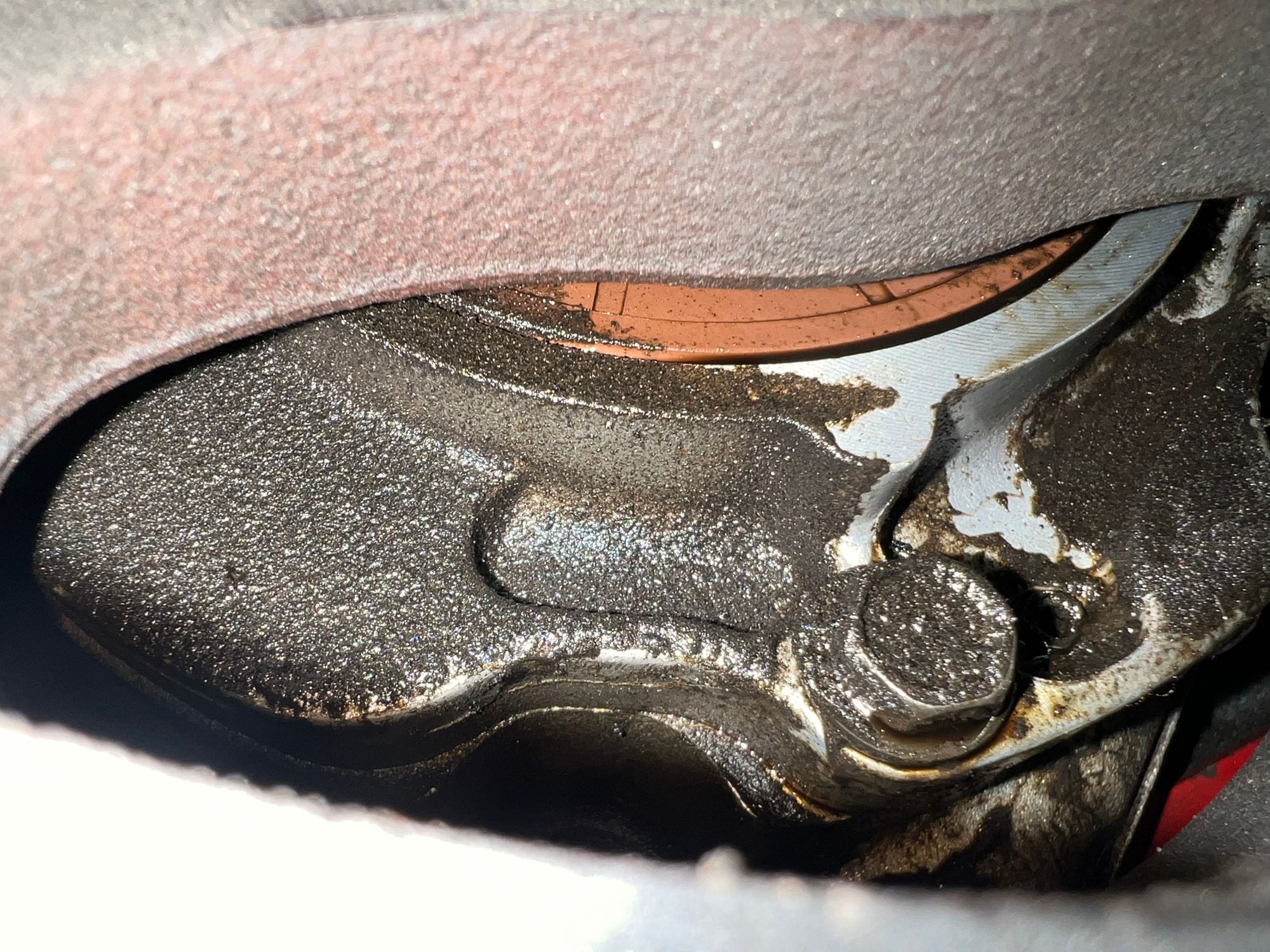

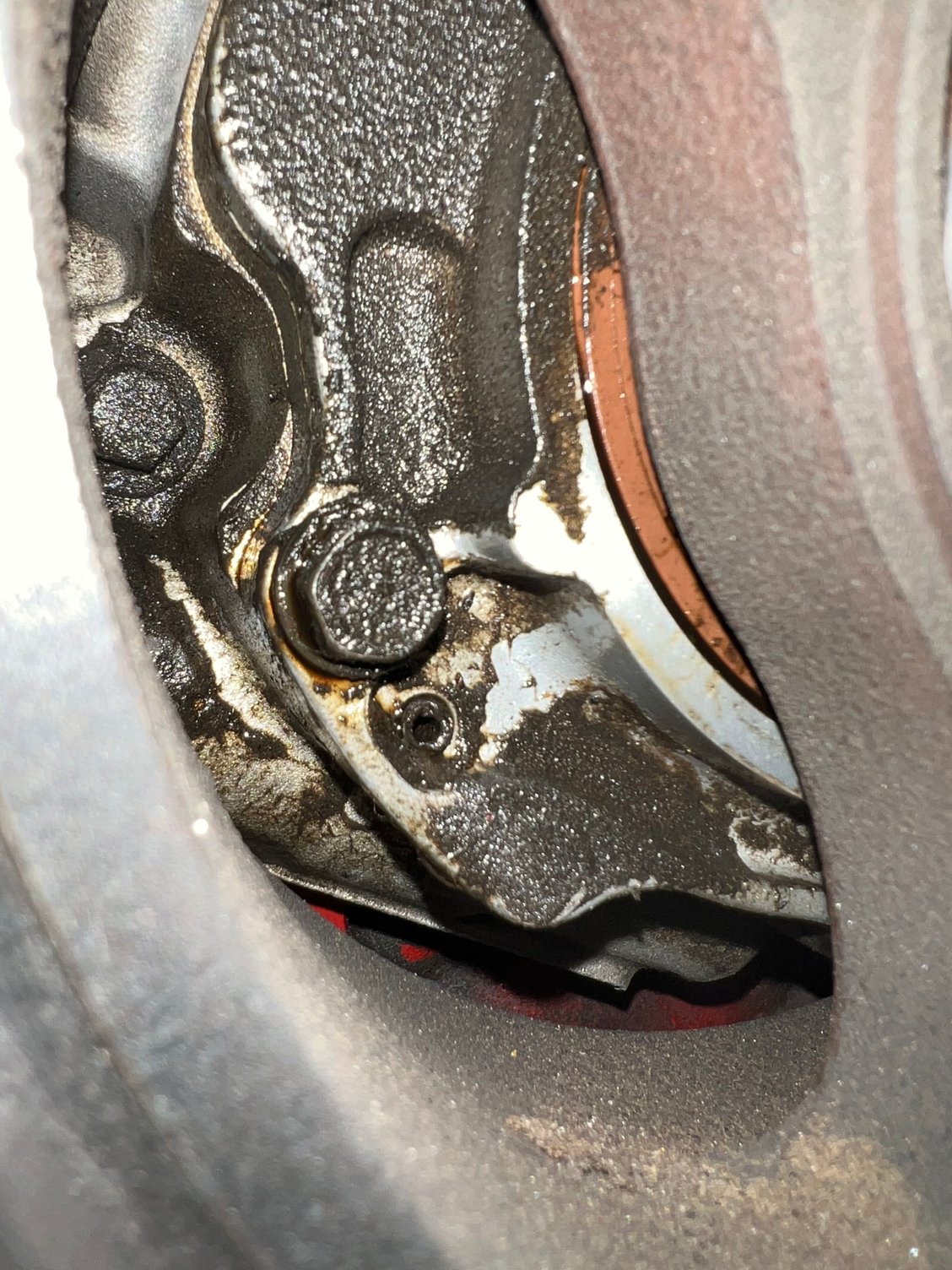

We’ll I got my first oil leak
LPOP regulator
Front main seal Leak?
Top of the LPOP cover?
well got a few drips of oil on my driveway. Looks like it’s been kinda wet on the LPOP cover. I’m guessing that new front main seal is the culprit. Only lasted 5000 miles lol.

Did you " hammered" the seal in, or did you pressed it in with the install tool?
I don’t remember but I used a tool on the rear. I may have hammered it in. Probably need to just replace it with a new one and use the tool to press it instead of hammering it to death. I think I have a new one laying around. Live n learn

That's not an OE seal.
I think it was part of the front cover gasket kit. I believe it was a Mahle kit. Guess I’ll try again with a verified OEM seal and the actual driver

This was the last time I did a front main seal, few weeks ago. It was a Ford part. You can see it was a grey one

Have you perhaps installed the sleeve and the seal separately?
In my opinion, the best installation option is when both are installed together with the special tool.
