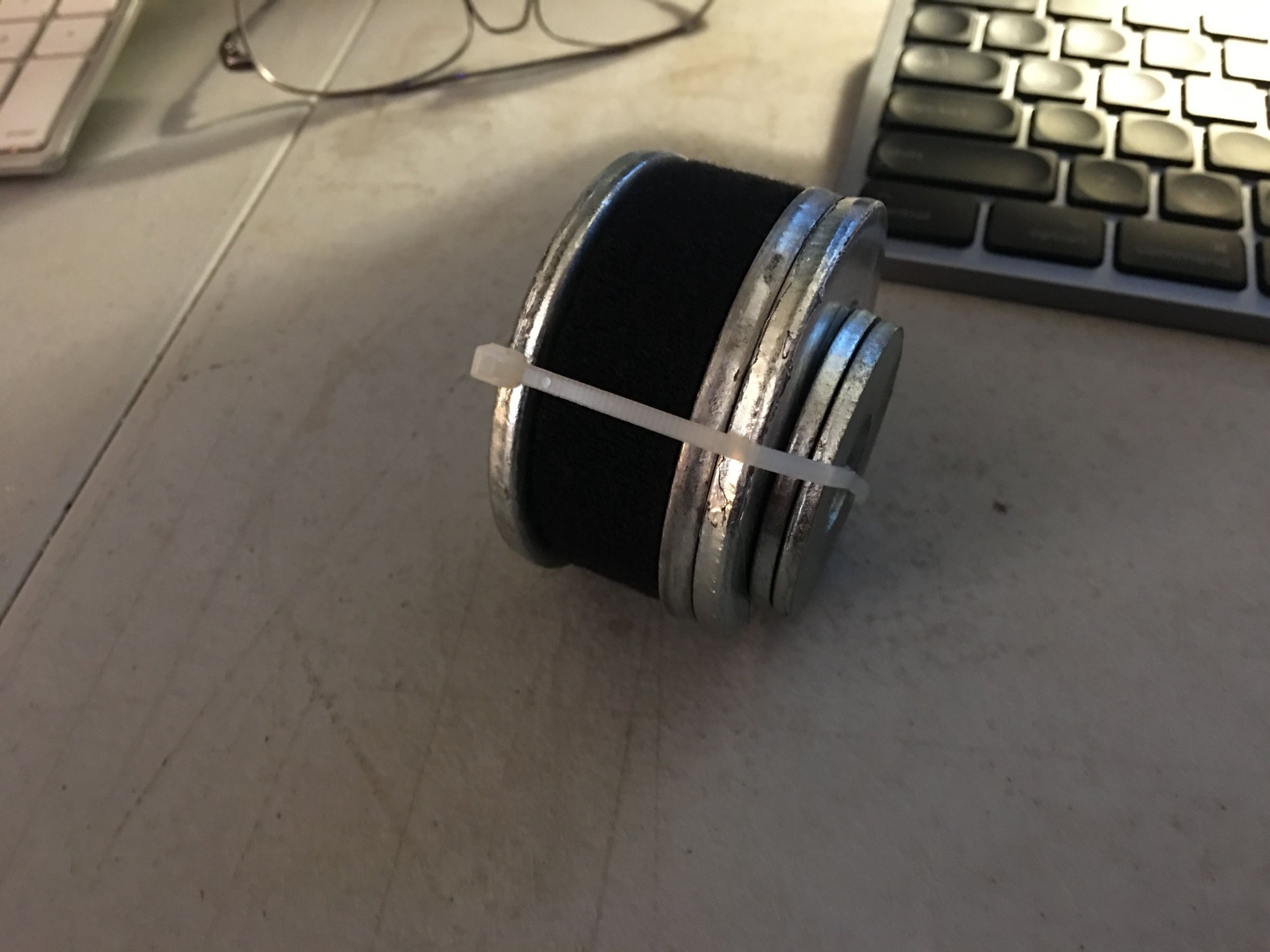

If you need the “kit”, it’s ready to ship. You’ll need threaded rod and nuts.
Thanks for all your support much appreciated! I ordered a lisle cam bearing tool, few extra bearings, worst case I could have the machine shop drive the new bearings in for free. Not to bash them im sure it was good enough but I’m not looking for a redo after this build for a while.
I’ll let you know about borrowing your tool. I think the idea of pressing them in mechanically is better than driving them with a hammer. These bearings are somewhat flimsy and require some care to install correctly.

What is the size and length of the threaded rod and nuts needed? I like the idea of pressing not pounding them in.

The rod I have is a 3/4" fine thread, it's from another project. 3/4" all thread from Tractor Supply/Home Depot/Lowes, which would be coarse, could be used. The rod you could "rent". Or I could ship this to you. I think UPPS has triangle tubes for Priority shipping, but I've not handled them. I have shipping tubes, too. The basic washer kit I was thinking of the same size box as I shipped out the engine lift brackets with. I also use some plates from my seal install kit, I 'd have to figure out what I used. Just ship it back to me when you are done if you want to use it.
Buying the washers from McMaster is going to run around $40 by the time you are done. Buying the rod and nuts probably around $20-25, so the made up kit would be ~$65.
let me know if you could send the entire thing in the mail. I’ll compensate you for your shipping and a reasonable rental fee then send it back in a week.
I appreciate your help and everyone else’s

It's 24" long, so it should ship. Monday morning I'll check out the box at the post office and see if it's worthy. If not, I've got the cardboard tubes that long materials have been shipped to me in, I can cut one down. Maybe my Colt Cam tube might work. I still should have some of the pipe insulation I used too.
If you want to cover the shipping, that's fine, I'm not looking for a rental fee.
