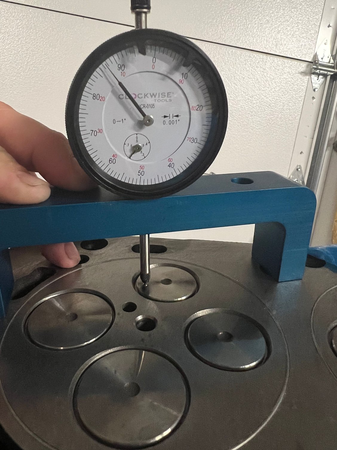

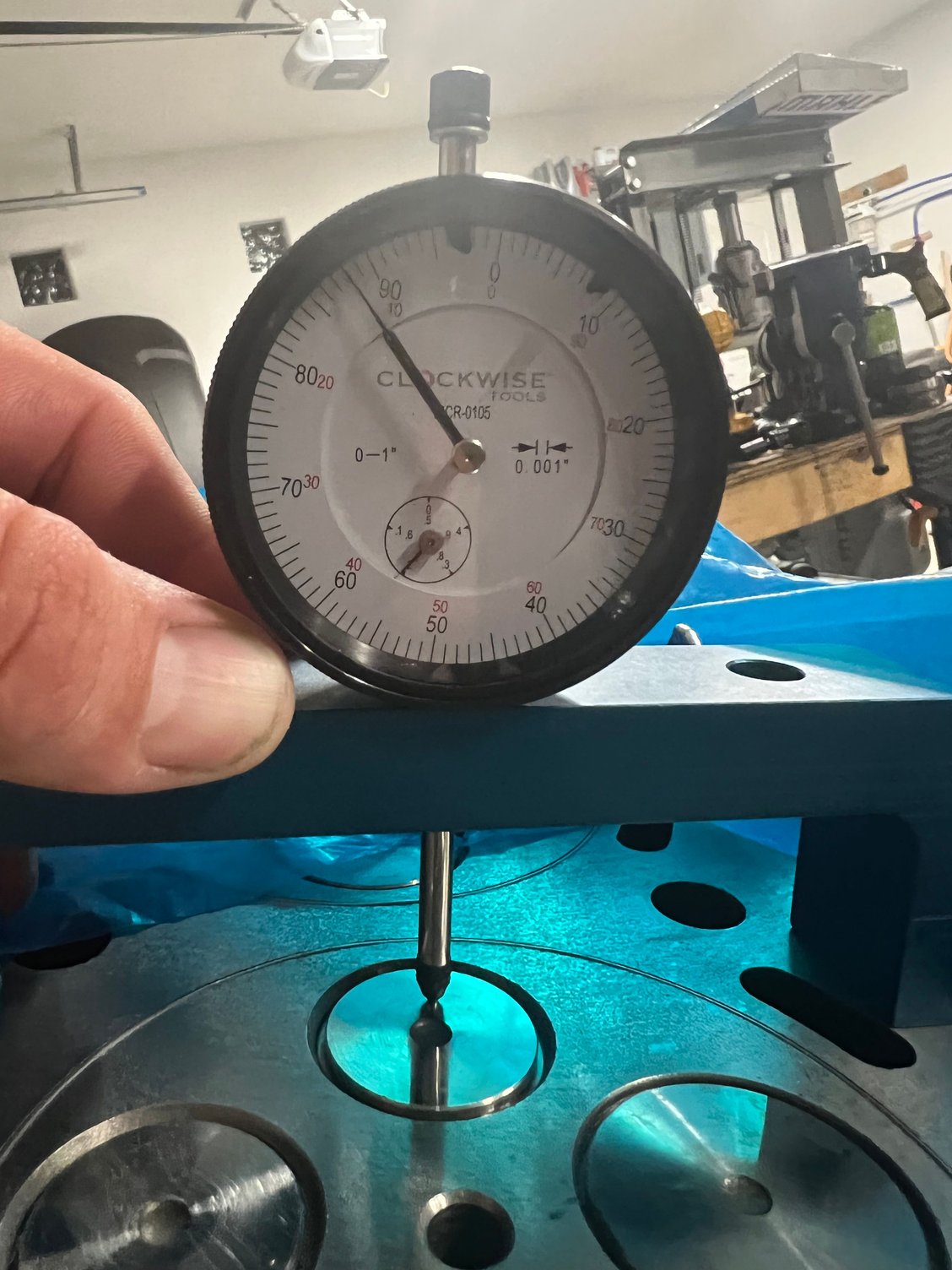

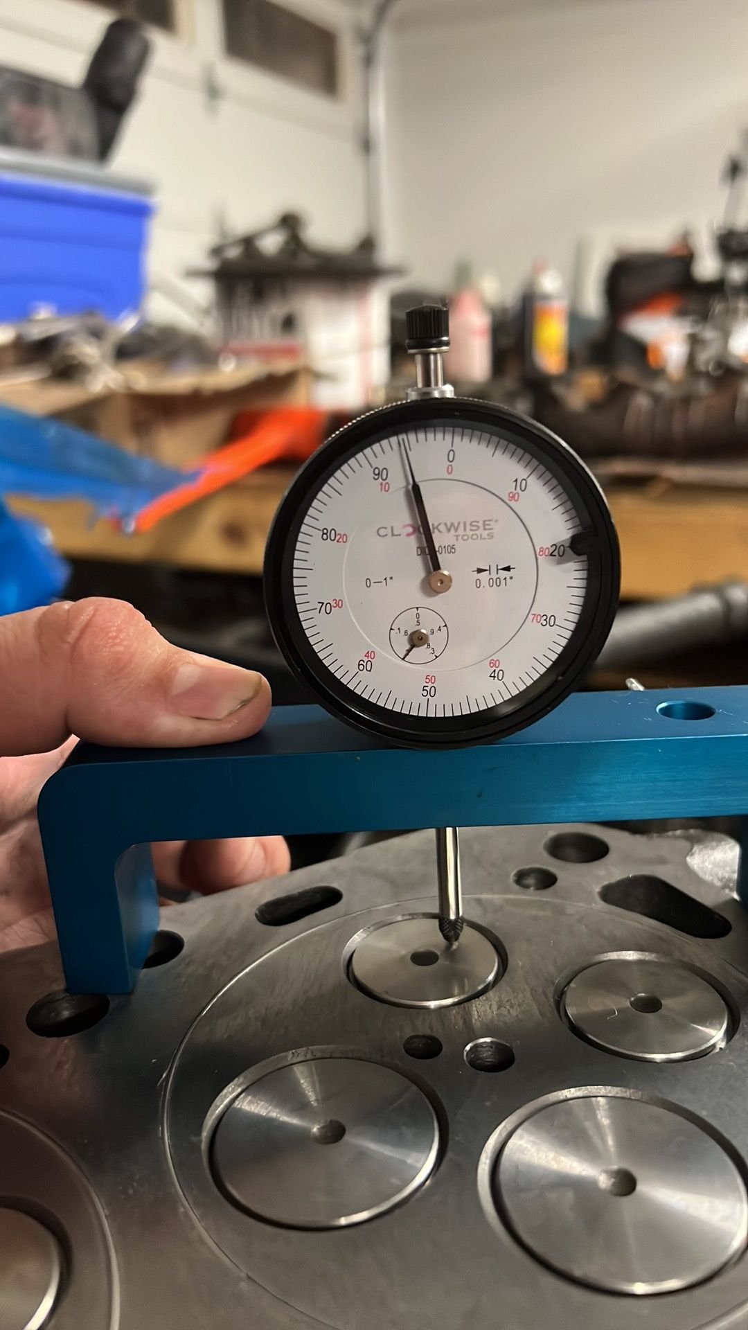

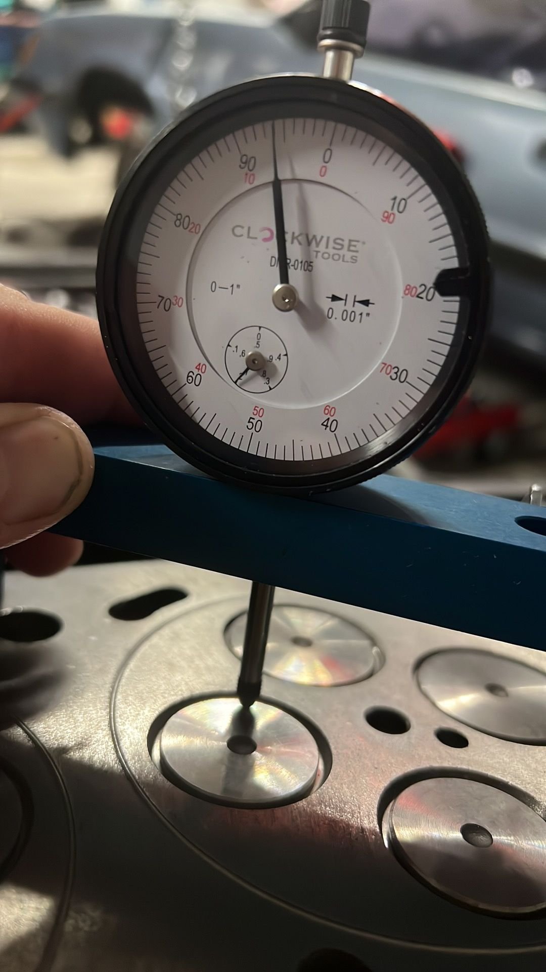

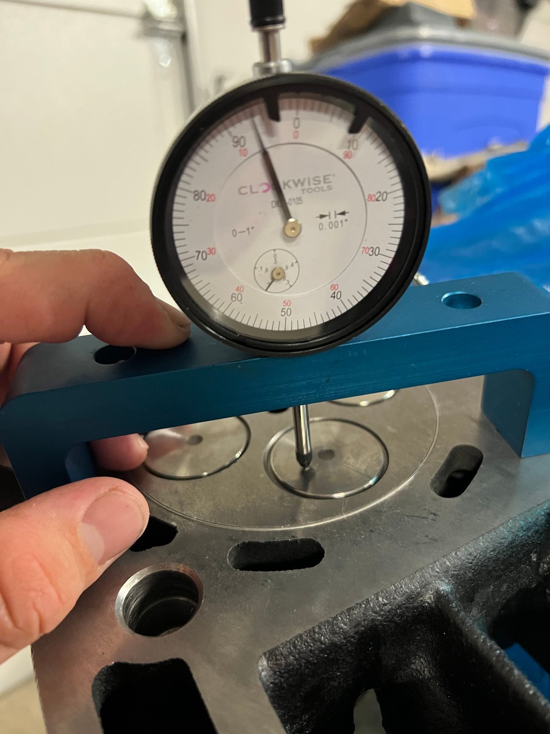

my valve recession is no good on the new heads the builder is going to make it right.
what is a good number on new heads? I’m thinking .020-.026” would be ideal?
Mine are .005-.015 all over the place. Oops
Houston we have a problem
valve recession is 0.5mm +/- 0.18mm (stock cam)
With stage2 cam 0.7-0.8mm
Yes, yes, you do.
Without looking at my videos on the subject, The short answer is you want 0.025"; some prefer to go to 0.030".
I did videos on valve recession, piston protrusion, and measuring piston to valve clearance, based on my conversations with a pro 6.0 engine builder and Geoff Bardal, owner of Colt Cams. I came up with a chart so people do not have to do the assembled engine/valve to piston clearance measurements.
My heads were factory 20mm "Commonized" heads and had a good consistency and within the OE spec of 0.0126" to 0.0268". However, I had one valve out of all lower than the others, which I wish I didn't have, and if it were such a hassle to get a machine shop to do one valve seat, I would have had it brought to the range of the others.
But, measured and in a running state, down to 0.018" valve recession still gives the clearance that Colt is comfortable with, 0.035".
It is also dependent on what the piston protusion is.
