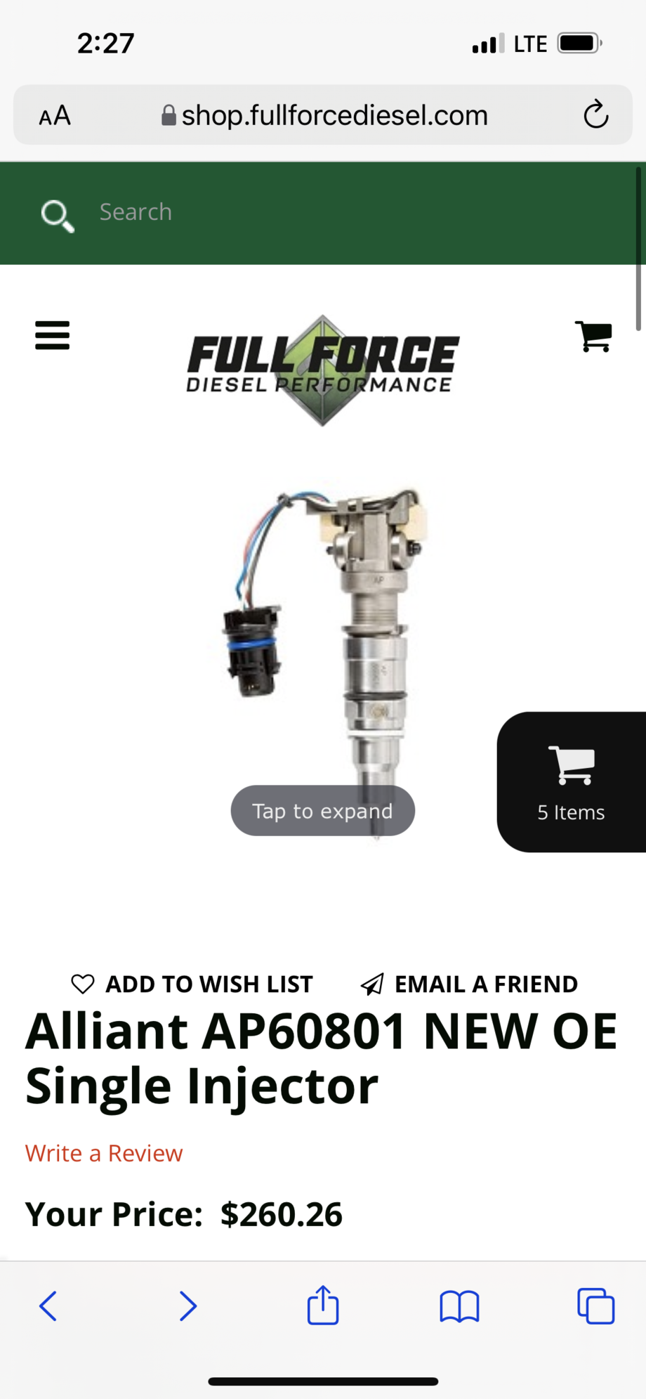

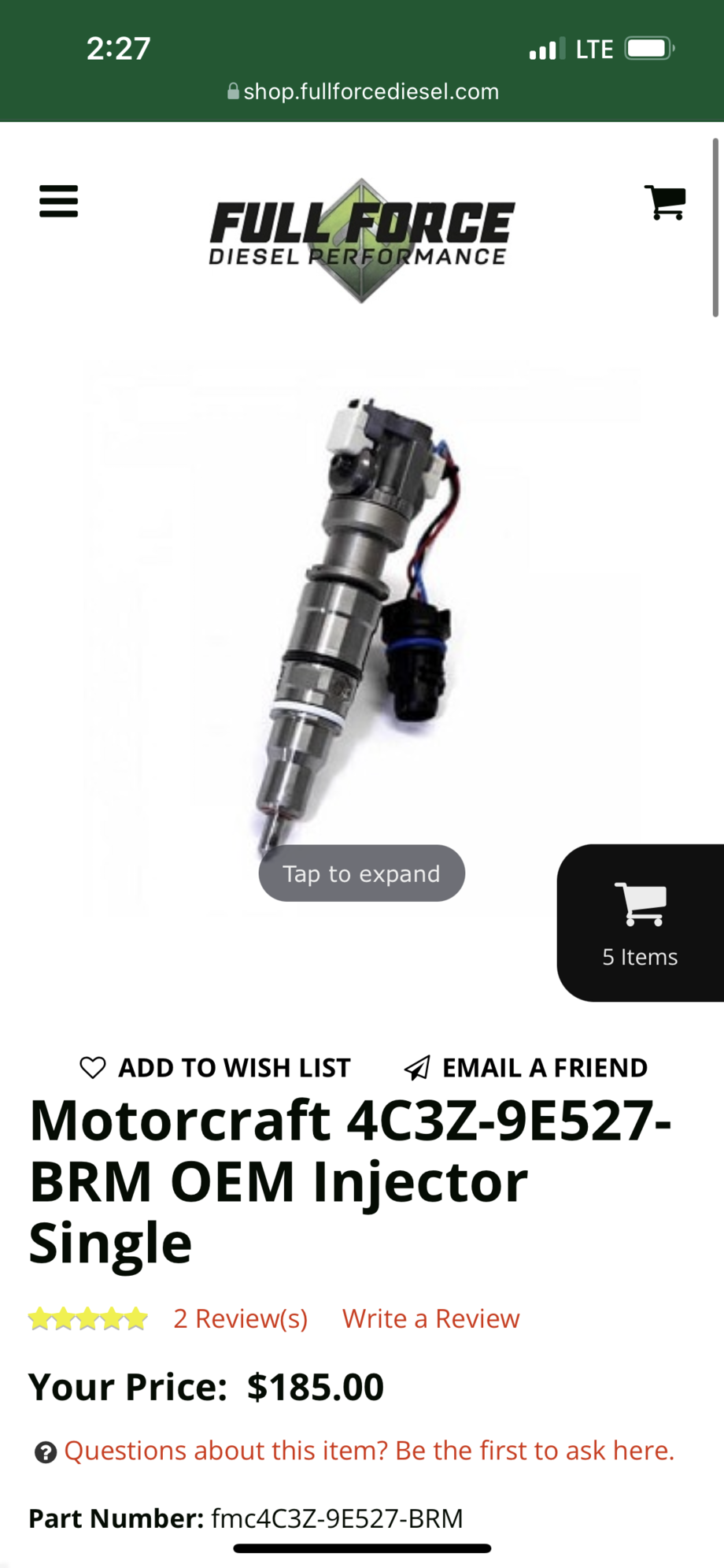

Looking at doing a set of injectors in this engine before it goes together. It ran fine before but I don’t want to touch this turd for a while.
pure power has a “new” injector for about $260
Motorcraft reman looks like $190-200 each
what do you guys recommend ? My guy says pure power new injectors is probably a safe bet. I would be happy to get 100K out of them.

I would only use Motorcraft or Navistar injectors.

kinda stuck on which route to go for injectors.
is it worth the extra money for a 100% new injector? I’m praying this is the last set of injectors I’ll put in this motor. 100-150K would be excellent to get out of them.
100% new
Mostly new
