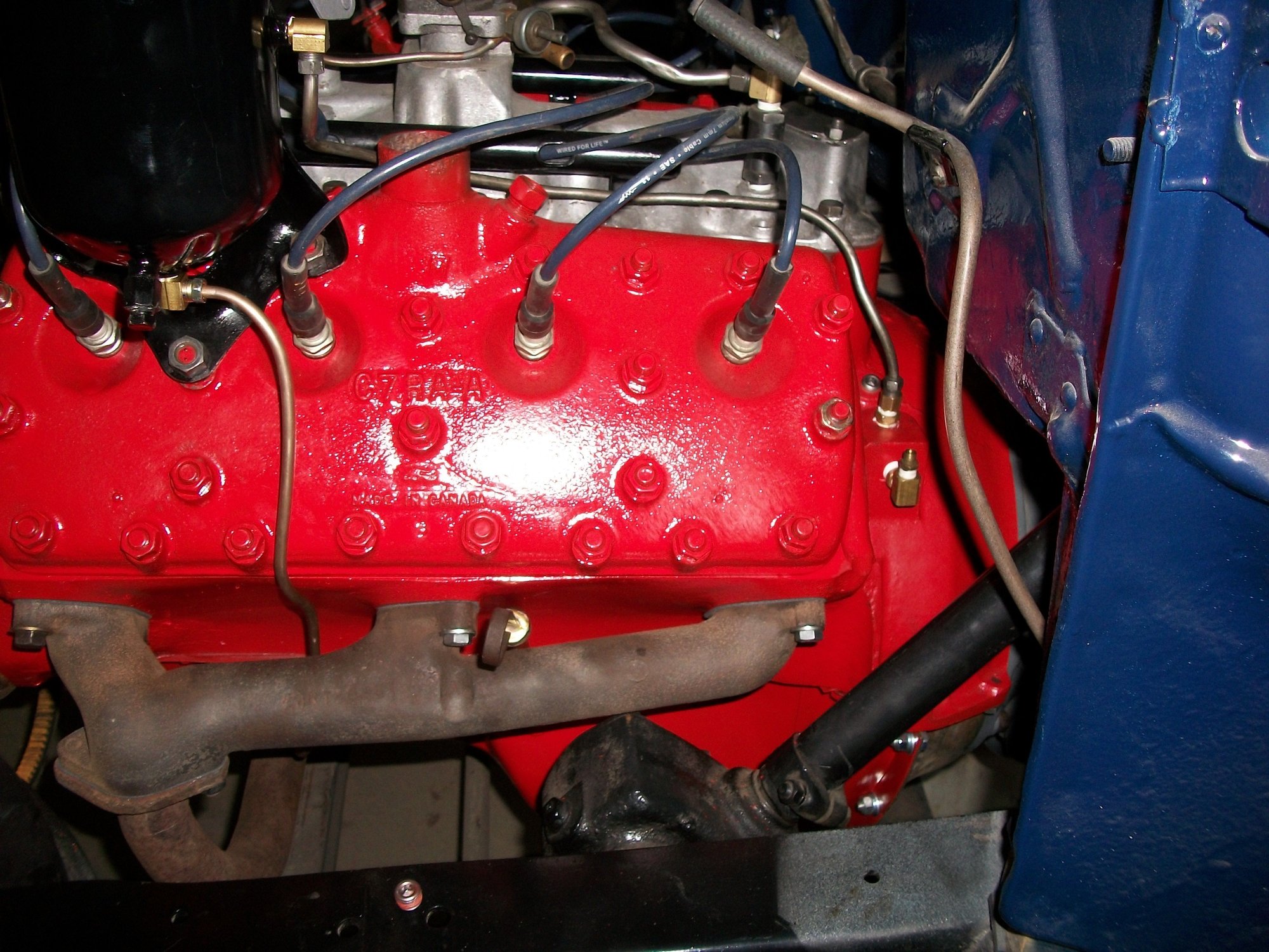

in my truck i have i believe a pcv valve. so the vacumm is below the carburator instead of air filter! i,m really not sure,but it sounds logical! as you can see in the picture.
now if i can get used to the picture posting!

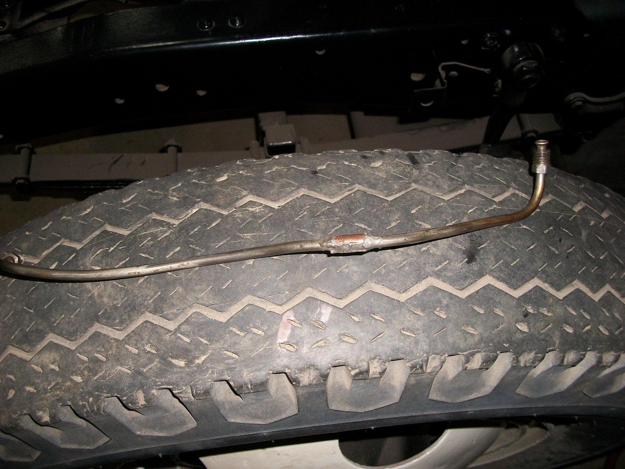

made a cap for the gas pump and will look Inside when motor runs, just out of curiosity. i will install a oïl pressure and temperature gauge temporarily,for the next year . all i have to do is install carburator and oïl filter pipes to do a first start,without any prestone. i will reuse my leaking radiator for the next year ,until i can gather up more coins for the final.
on the oïl filter lines theres a repair or some sort of restriction! is this normal or should i install a new pipe!

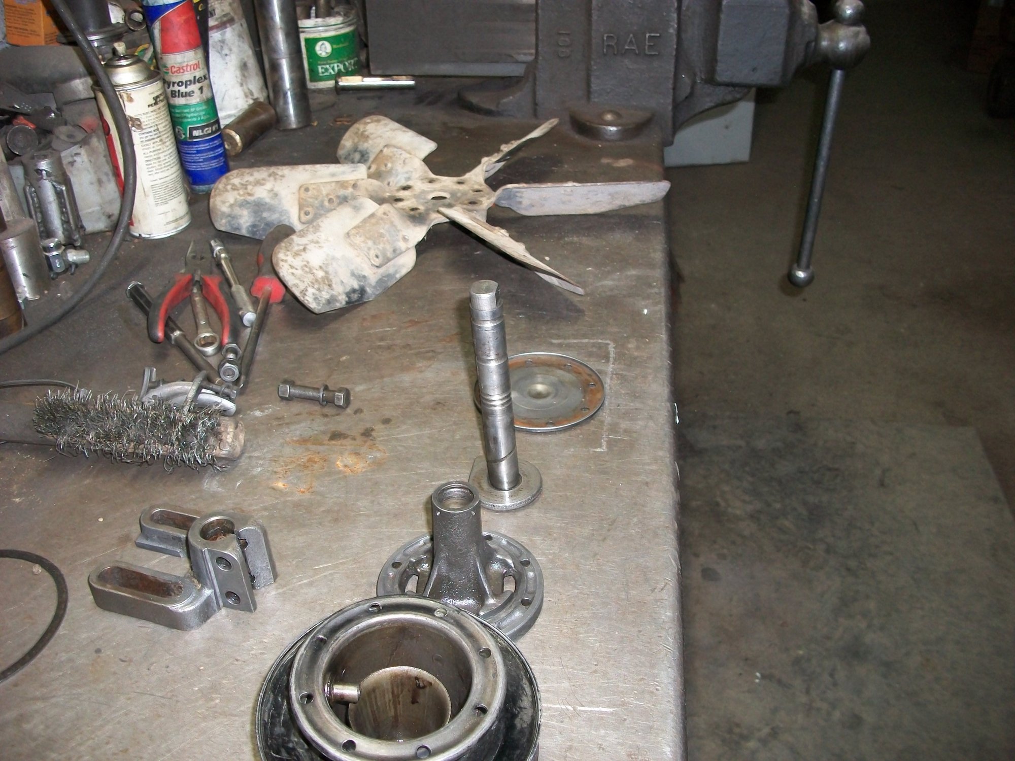

is it Worth while to try and install some sort of seal on the fan hub, i thought of putting a o ring in one of the 3 groves. there was oïl in there yet,i was suprise theres no bearings in there. i will get a set of gasket it nice and tight ,but awfully dirty.
not sure what i will do for the alternator ,joe from joe,s antique said them slingshot braquets can slacken! he sells them as a match set with alternator!
I'd get rid of that Brian..

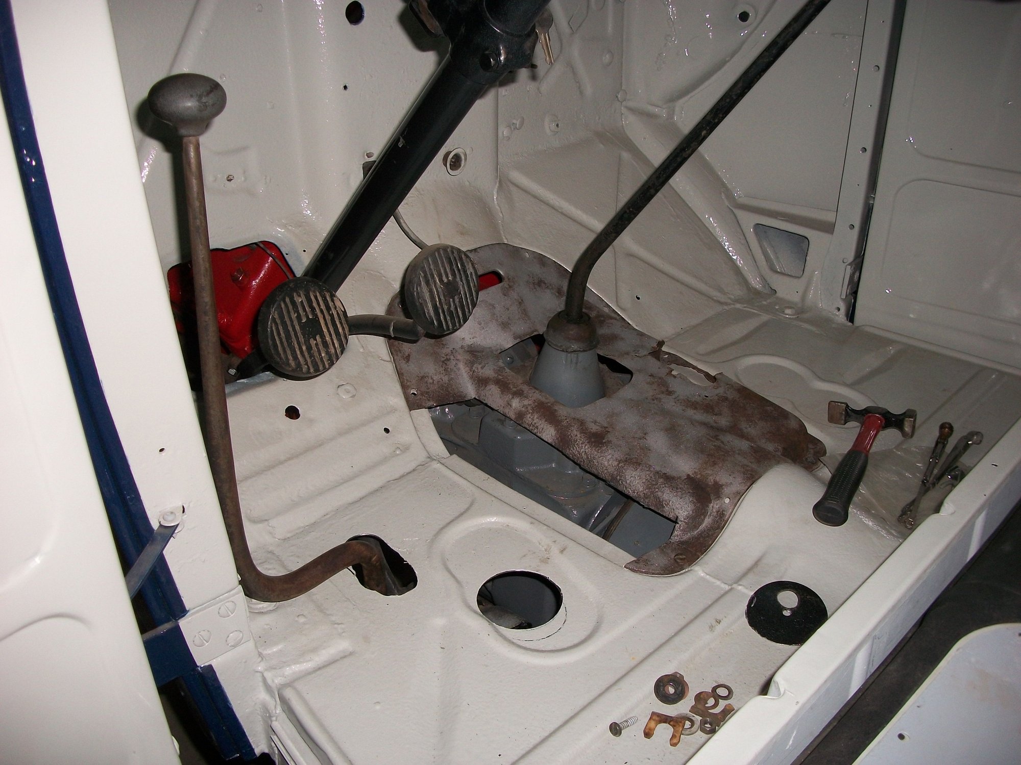

got about 6 hours into truck ,and seems like i didn,t do nothing! i got to get a plan going,i,m jumping around on different jobs. i almost done on motor,got oïl in it and installed my oïl filter. i was missing the the restricking fitting,i made one with a brass bolt. i tried cranking it,it would turn for 1 turn and almost stop. i had clean the paint for the starter to ground! it turns good with a wrench,so maybe starter is wore. it had a paint rebuilt didn,t open it up. done some sandblasting on inner fenders and fan shroud and my battery rack. i shorten the battery rack and slimed the height. made my holes for the master cylinder and ruxel lever. now the ruxel lever is going to open a new can of worms.
