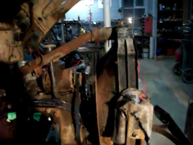

bought the truck in septmber. only can work on it in winter. bernette is the owners name my name is brian . start by pulling a few dents,then took the front end apart. put some repair on helper side rocker and cab support,straighten up the helper door a bit.so opens better. drivers door is bang up quit a bit ! owner son who sold it too me said truck had an accident and cab was replaced with a 1947 cab which he has. so i must go and pick it up,when we can go up on his farm. hopeful i can use door parts.

done a tune up on engine got her running. for some reason can,t post the youtube. go too( 1942 ford truck first start 40 years 001 ) it was the second start
