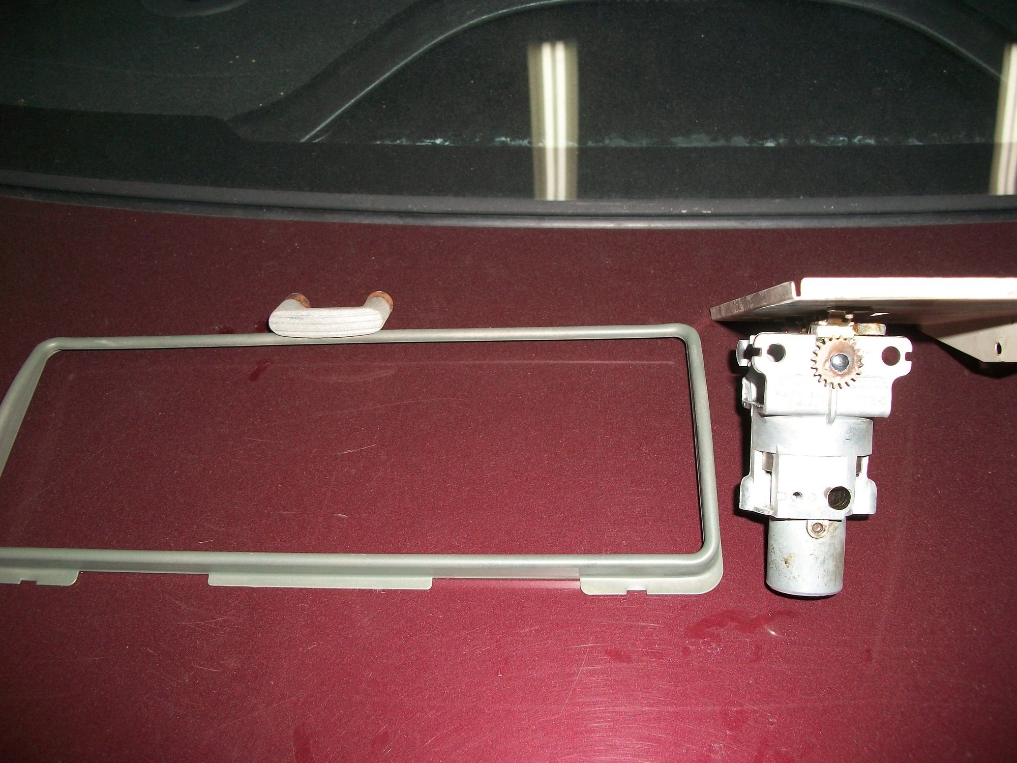

this is the gear that was jamed. i drilled the rivet to remove gear ,sanded the shaft and grease.

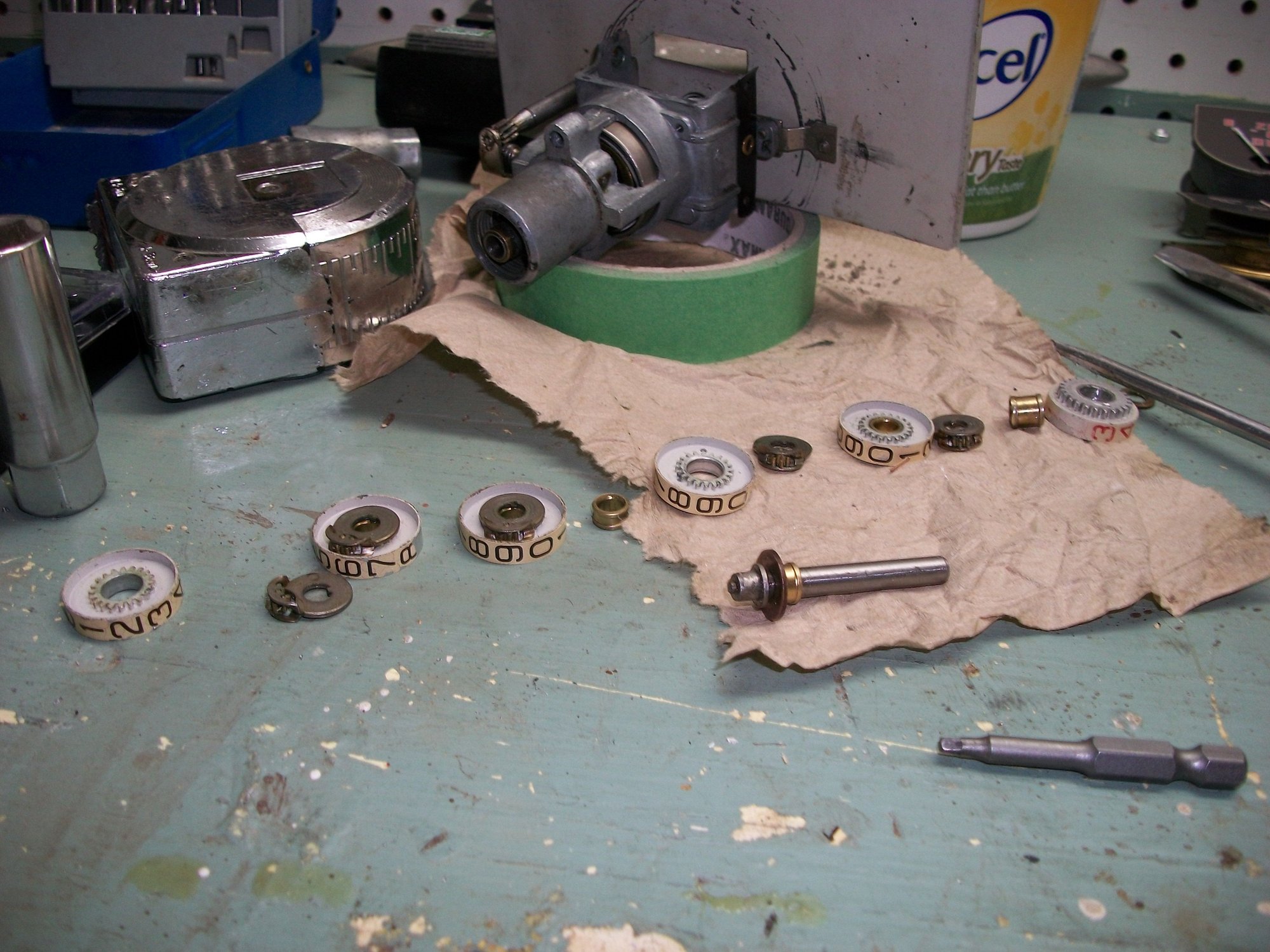

I have disassembled, cleaned, and reassembled an odometer before. It isn't that hard. I actually took two apart to get enough good number for one nice odometer.
I think you can get new number strips to redo the numbers on your odometer wheels. I didn't look into it since I had two speedometers to make one nice unit.

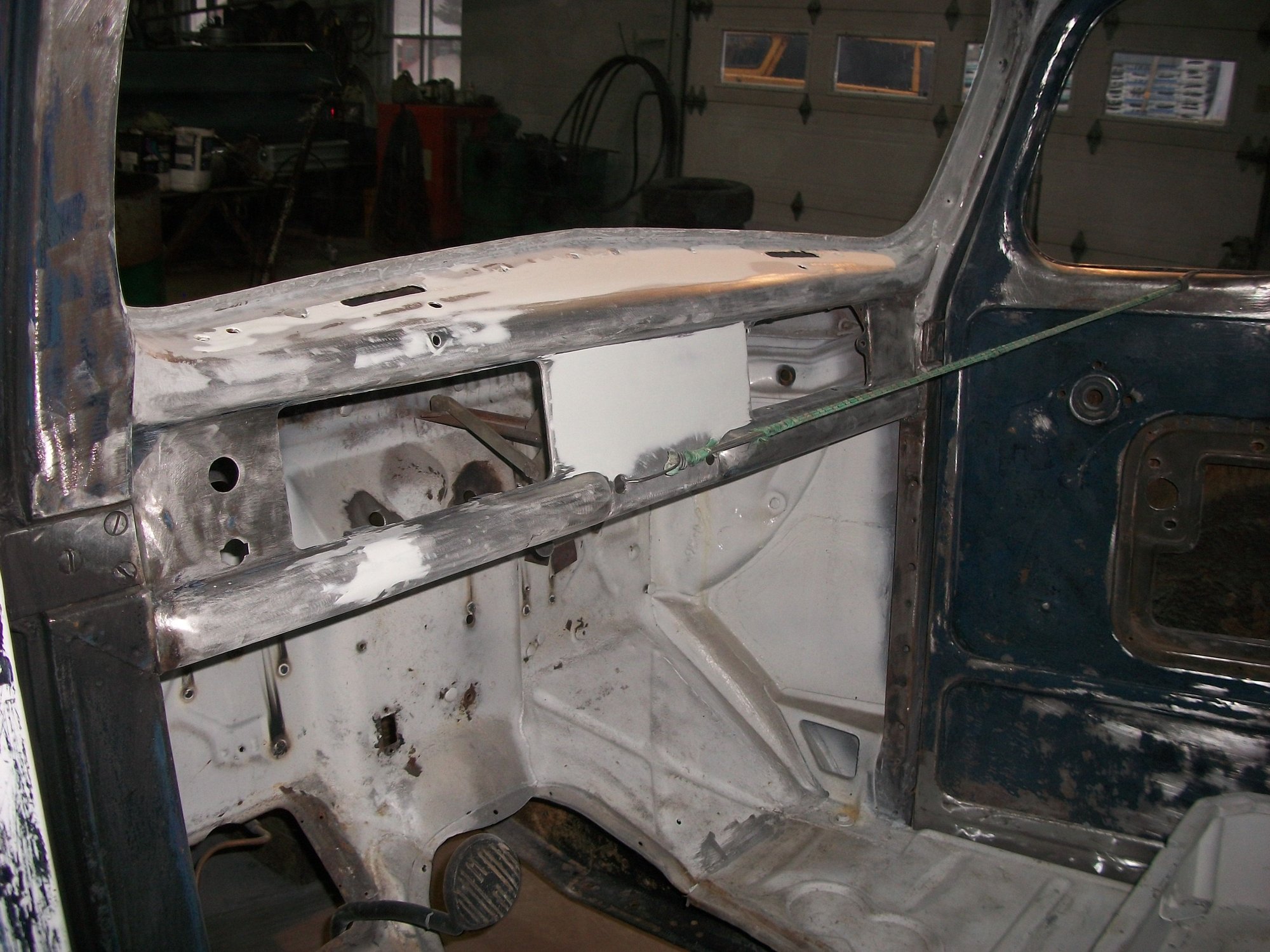

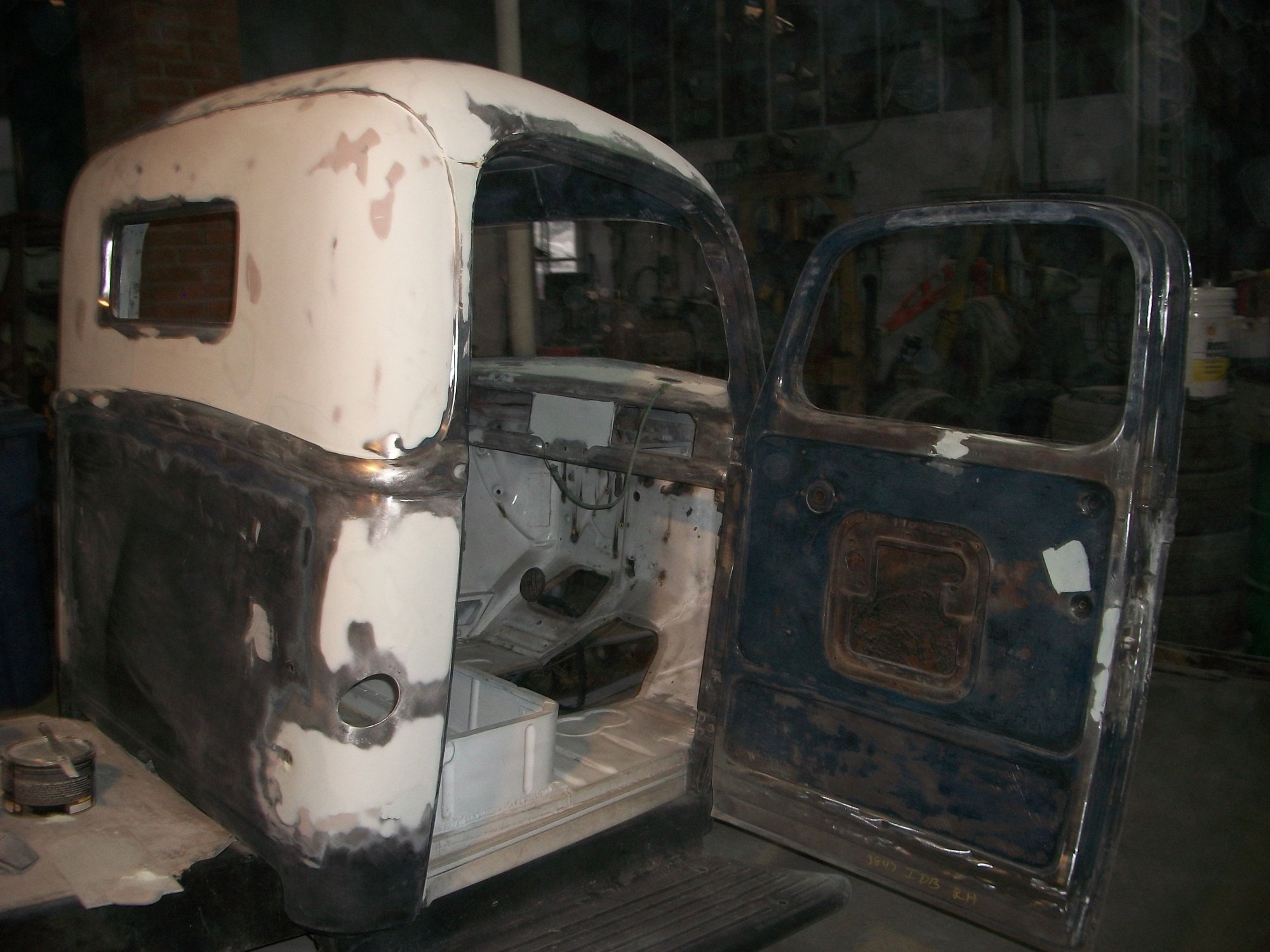

dash is ready for paint,i plug some holes and repaired the cracks that the steering column had done. being the cab supports were shot the steering column had broken the dash.
alot of sanding, i understand the cost off a high end paint job!!! hoping this turns out ok! i don,t want perfection,back of cab and roof top will not be over sanded!

thanks 38 coupe ,i was afraid of breaking something by trying to dissasemble it. i will give it a shot!

well i got the odometer gear disassembled,and made 2 attemps at putting it back together. seems like theres some sort of timing,not quit sure how to assemble it. 38 coupe you wouldn,t remember any tips.
Dang it Bernette.... If you get that puzzle back together and it works, you have a much larger brain than me. And maybe better glasses too!

hi GB! yeah it took a few attemps before i coax myself to take it apart. the numbers are getting worse from playing with it. there has to be an easy way of timing it. the people who work at putting them together had to have some sort of guide! but the guy who invented this and had no computors, he was very intelligent!!! if you ever see a good set of grille bars let me know! around here everything is rusted. i,m following your woody project you have a mighty find brain.

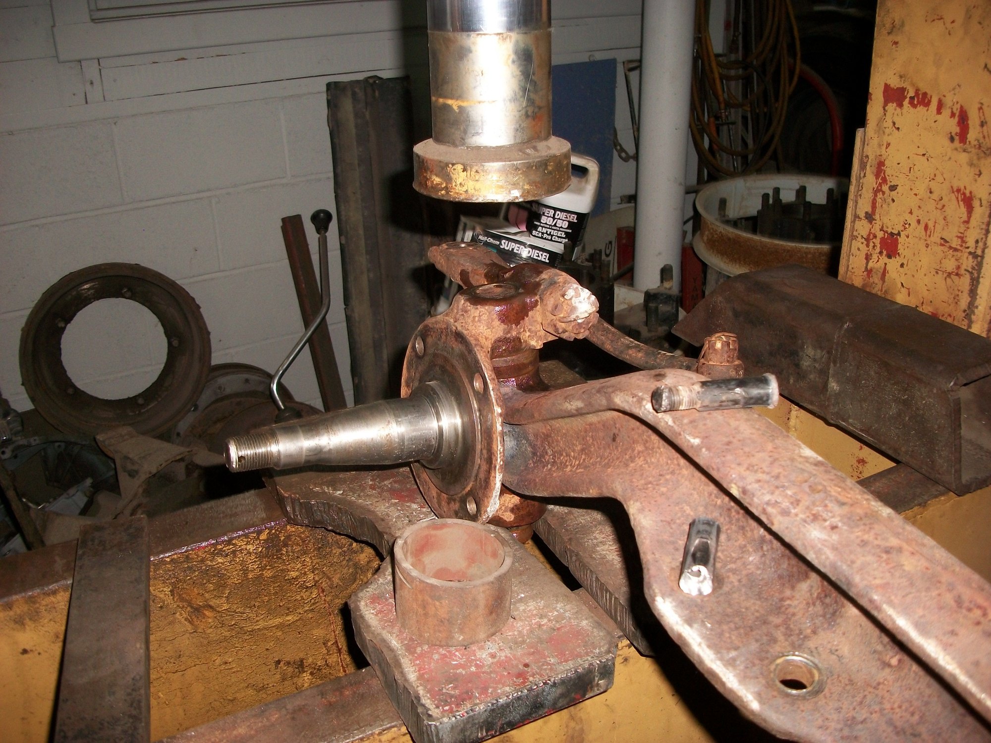

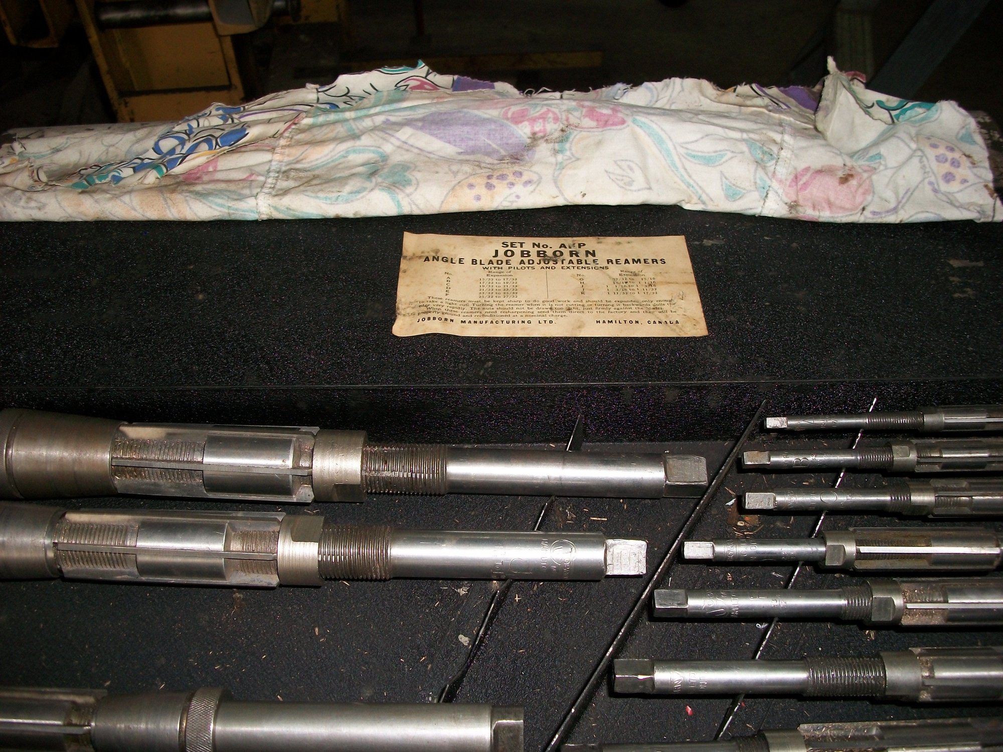

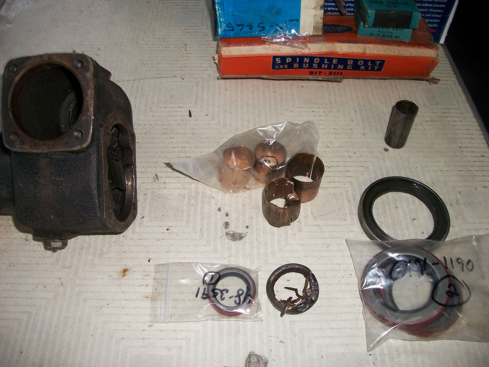

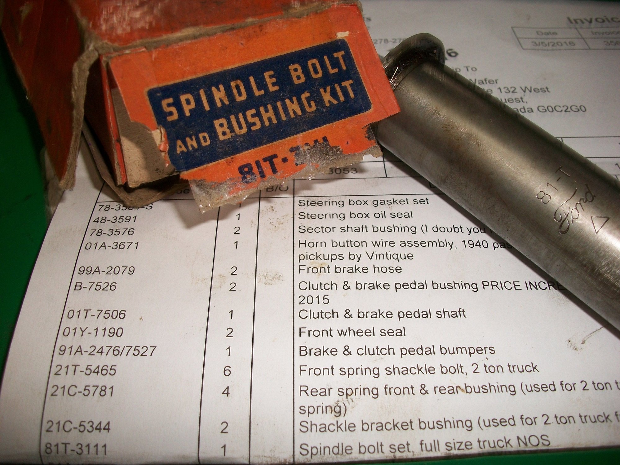

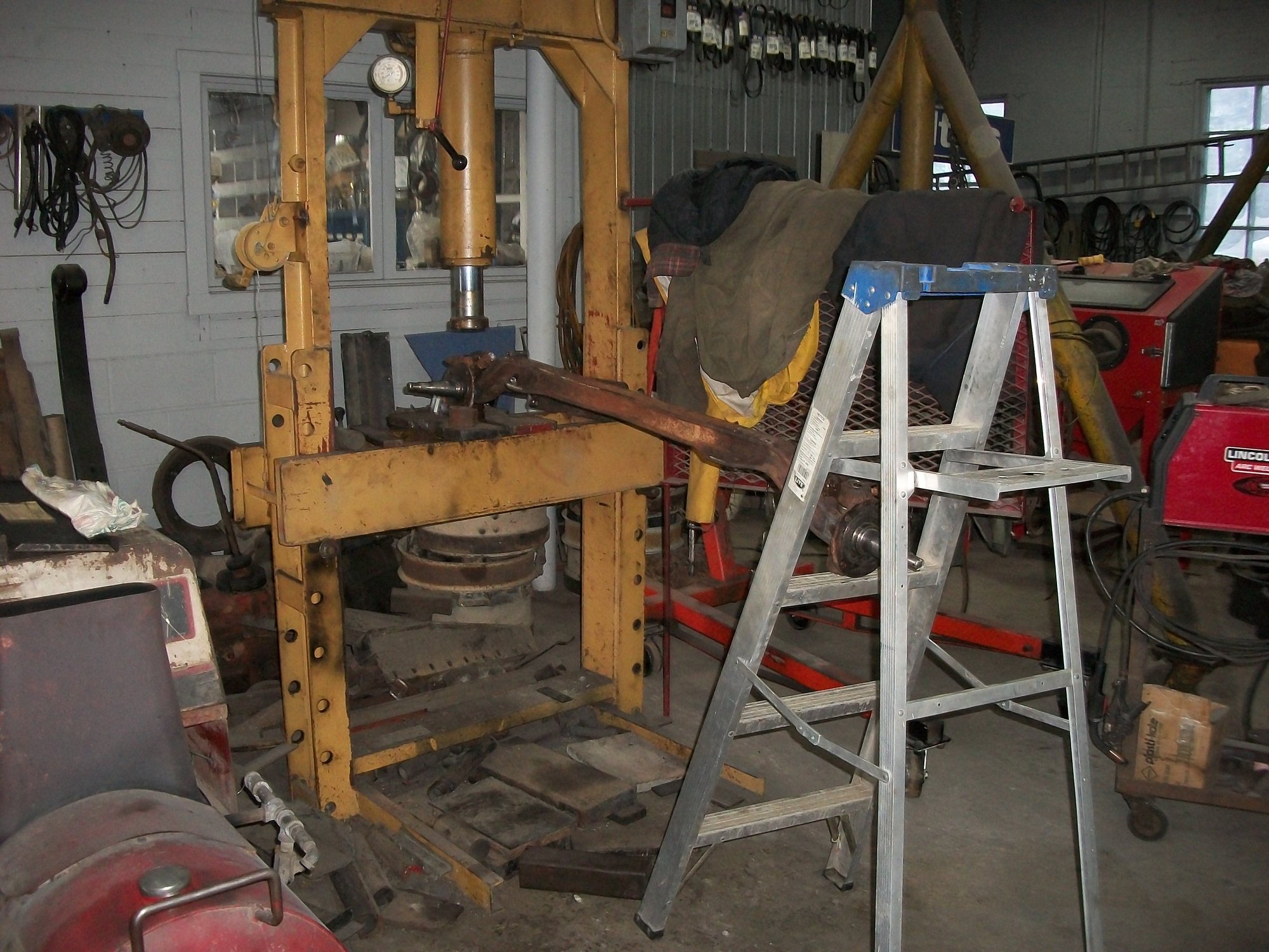

good news and bad news! parts come in friday so i decided to start working on front spring bushings,the 4 spring bushing fit fine. but the 2 front hanger bushing are to small. so i decide to rebuilt my steering box wrong sector shaft bushing and seals. i started checking my parts and the 2 front wheel bearing oil seals are to small! so i go ahead on the kingpins and they fit so heres a few pictures of my afternoon
wrong parts
hell of a job getting king pins out,had to drill and heat the wedge bolts that hold the kingpin. and one came out with a BFH. the other one didn,t even move with a sledge hammer had to use the press.
used our old rimmer. made in canada.
part numbers i got for kingpin someone had ask for this the kit was NOS.

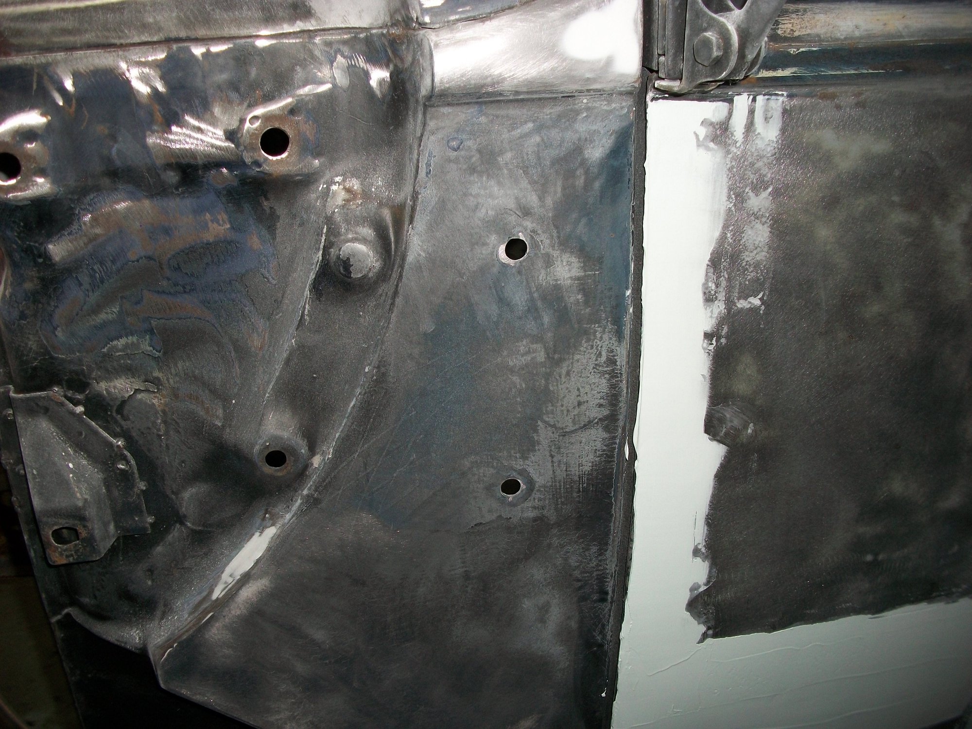

got another question! what are the 2 holes for on the driver side cowl. looks like holes for a radio antenna,there know sign of a radio in this truck. i don,t have a plan for one. just wondering if i should weld them up!
edit. well after looking at the picture! starting from the door theres the 2 holes i,m taking about. then theres 2 holes that were plugged ,but as you can see only one still has a plug. then theres the 2 holes for the hood.

  #179
newold46's Avatar
newold46
Joined: Sep 2010
Posts: 1,587
Likes: 36
From: South Carolina
I have no idea about your 2 extra holes, but the next 2 (one filled one not) are for rubber hood stops to keep that end of the hood from vibrating on the cowl. Like these:

Yes, those two holes next to the door should be filled in. FYI, your advice to hand pack the rear axle wheel bearings was spot on. I got a rear axle service manual and that is the recommended procedure.
