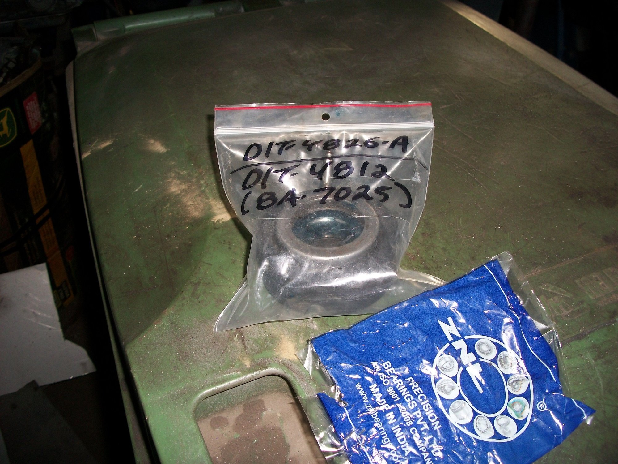

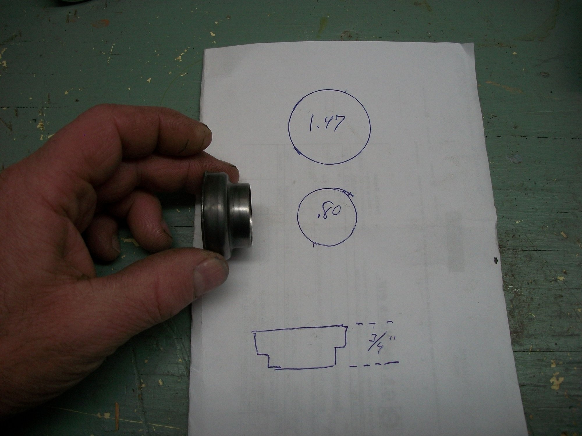

still waiting for the pto ,i might of found a seal! i got a few things done today finished and painted transmission cover,assembled the fan hub. got a new firewall padding installed and started assembling trottle and choke lever. and assembled my hanger bearing new bearing and rubber isolator.
i got 3 questions.
what was inbetween the trottle and choke buttons
where does the speedometer cable pass
would somebody know what lenght the alternator belt would be. i think i got the wrong pulley on alternator its narrow.
well maybe 4 questions ,is there different belt widths. is it possible a truck and big truck had different belts.

I always convert to 12 v alternator. I always buy the wide belt pulley (5/8) from speedway. Everything about the conversion is bulletproof. Just remember the Bosch 12 v super coil and the runtz gauge reducers. Golden.

You could make your own gasket for the pto with some gasket material and a ball peen hammer: hold the material on the trans case and tap out the shape of the mount on the gasket material. This action will cut through the material and you have made a gasket. The middle hole is for the last hole of 3 on the dash is for the light switch. The speedo cable goes out through the firewall and around back to the tranny. Your project is looking good, by the way!
The three ***** in the middle: from left to right T, L, C

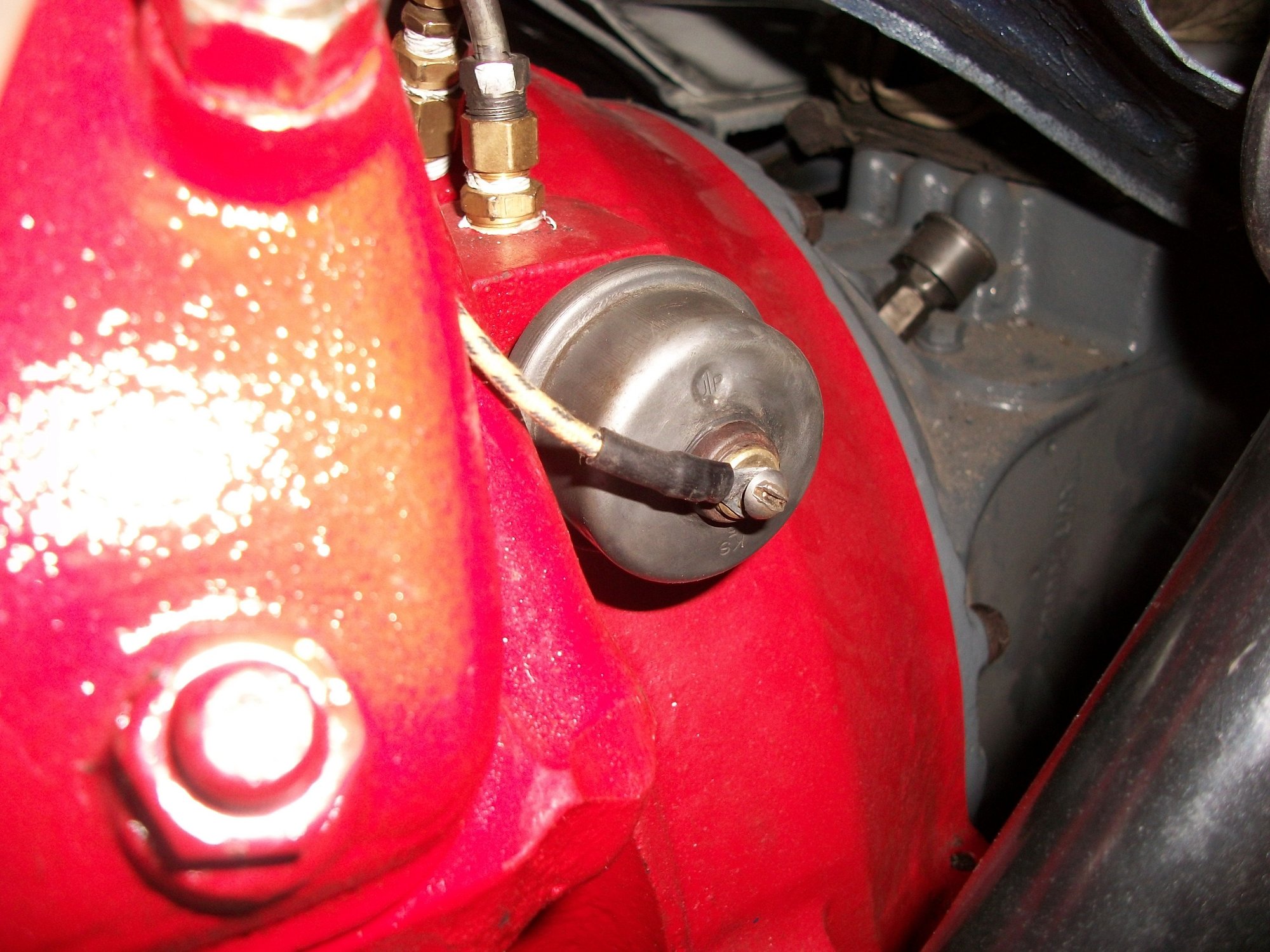

stayed a bit longer ,got the choke button installed headlight switch. put bernette.s dash back in its a old cod box. got the wiring sorted out and started installing. noticed the oïl pressure switch got a up position!

Looking great as usual! I have done that alternator 4 times over 10 years and I never get the belt right the first time. A well organized person would keep a log book of such items, but I save the sleeve from the belt and then lose it, or it gets mixed up with a bunch of junk unmarked. Sorry.
