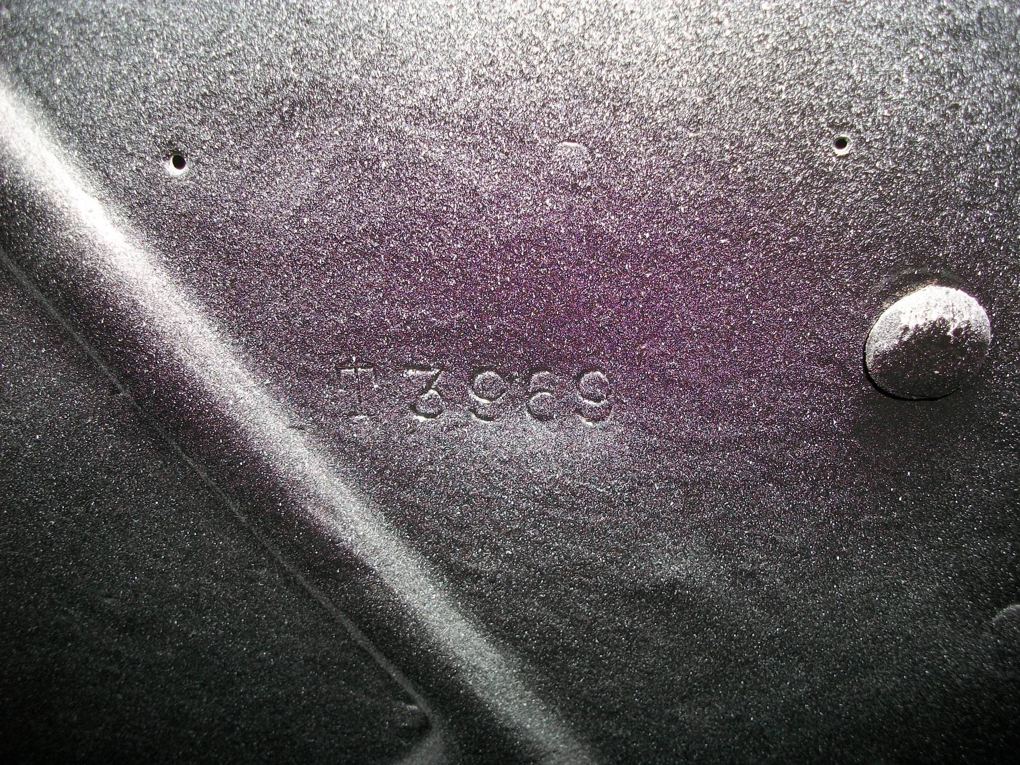

little update done alot of small bits. welded alot of different cracks on the cab . cab supports were done and rockers broken,cab was slowly cracking in half! wire brush the dash with a fancy tool my brother has ,forgot to take a picture of it works pretty good. then made a mixture of all metal and fibre glass resin,and brushed it on my dash to patch the pin holes. started applying bondo on the cab.

numbers on dash?
I noticed the numbers on the dash, don't think I have seen them there before. Had 2 with some numbers on the firewall behind the air cleaner and one with no numbers. Always interesting to see those odd *****. Nice work finishing up the cracks.

thanks ! i had noticed the number! i don,t no exactly what year cab i have ,truck,s a 42 hood and crab distributor kind of right. i order side door window felts,and i think i should have a metal frame on my windows but i don,t! the tag with serial number was added i think,i will try and take a few pictures of the screw holes. done a bit of work 2 evening and this afternoon,got the helper side door almost ready for bondo. when i done driver side i never thought about sealing the 2 halves of the door bottoms. i think i did better on this one!
