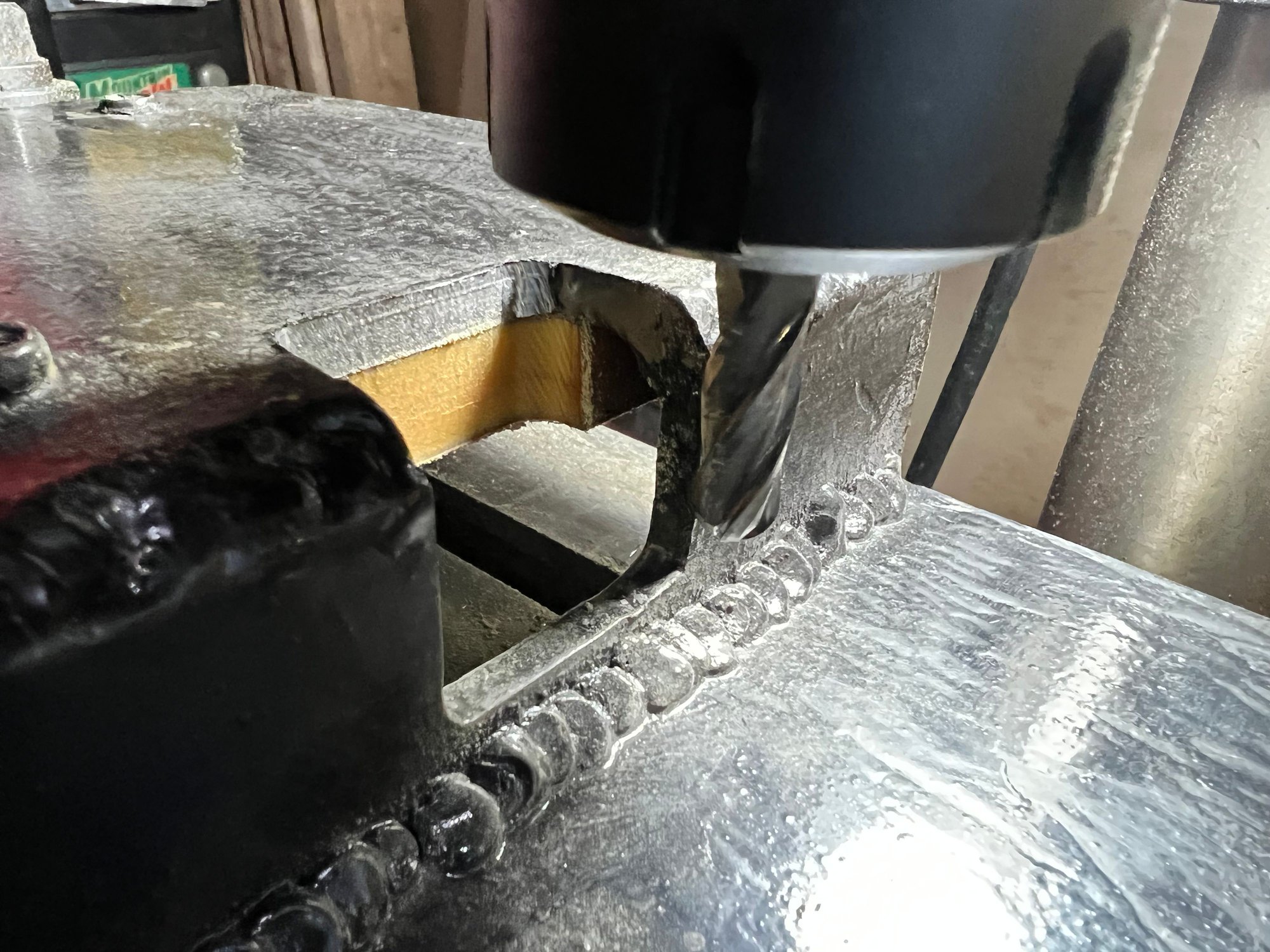

You mean like this? Not quite conical but spherical should work with a little milling of the injector clamp.
That looks good. Milling the injector clamp doesn't sound practical though unless it's like a one off thing a person is doing themselves.
Could use flat head countersunk bolts for the lower bolt. The upper one needs a shoulder.

Downward milling with a ball nose end mill in drill press is quite doable. Lateral loads on a drill press spindle are not so great.
Not saying it can't be done, rather that, unless an injector builder supports this idea, starts milling their hold downs, and supplies the bolts to use with their injectors, it's not going to happen past a one off thing a person does for themselves. CNCed conical washers would be easier to implement.
