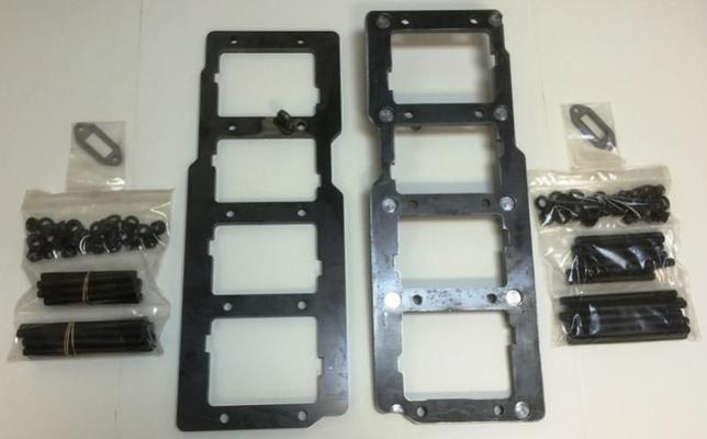

ARP says June at the soonest for main studs. Ford shows the oil pickup stud bolt as being discontinued. I'm disinclined to re-use the stock bolts because the specified "special" torque is 95ftlb which is higher than the International manual's "standard torque" for grade 10.9 bolt of the same size.
Machinist needs the fasteners so pulled the trigger on CNCFab girdle, which will come with ARP studs and play nice with the oil pan. Overkill but at least I'll have some fasteners and extra prevention against walking cant hurt!

The late Brian Gray (may he and his son rest in peace) also had a lower profile girdle that worked with the stock pan.
Is Brian's girdle the same as Corey's girdle? Are they in fact the same flat plate girdle, or if they are of a different design? Can someone shed some light on this?
I also don't know if anyone took over or is continuing on with Gray's Diesel business. The website is still up, but it isn't possible to determine from the website what the actual status of the business is.

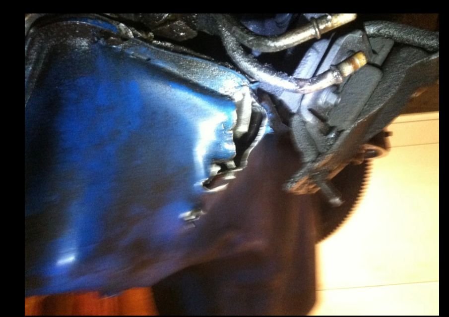

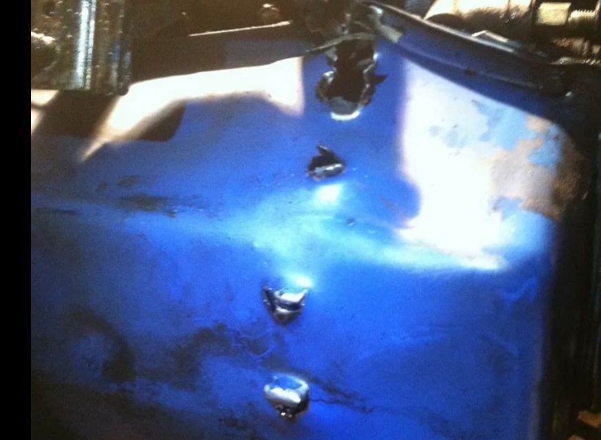

I do know that the 7.3L main cap design has been found to exhibit crank walk when the engine is pushed to higher than stock power outputs, and the load being pulled doesn't want to move easily.
If I were to tear down a 7.3L and build it back up again with the goal of it producing almost double the stock horsepower rating, I would absolutely consider a bedplate of some type.
I think the design that CNCFab (and Irate it seems) sell is originally a "Wide Open Performance" design by "Zane". Or at least, per the pictures, it looks that way:
I may have experienced exactly this failure mode...
