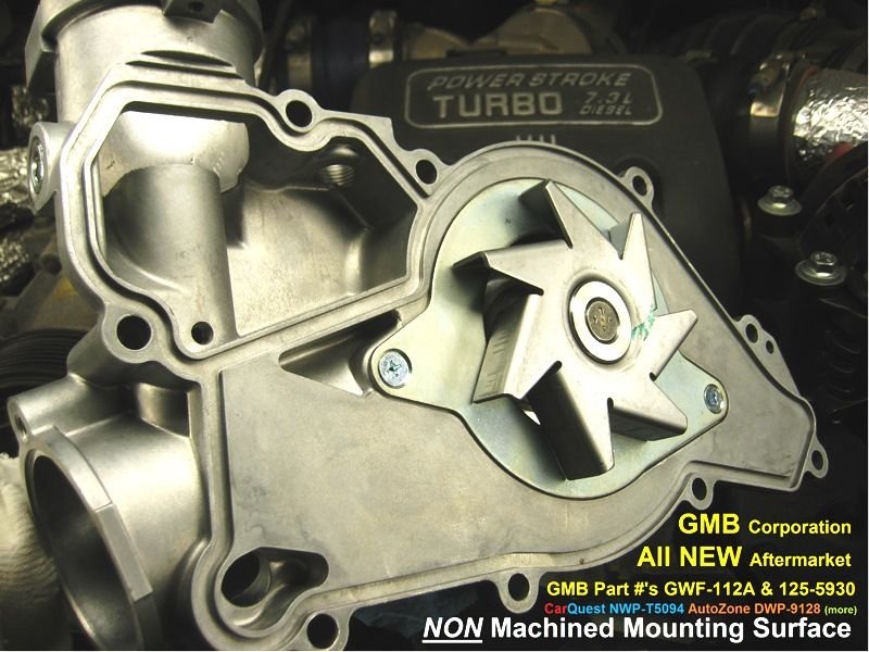

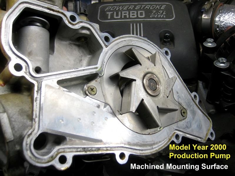

I noted a difference in flatness between a popular wax and oil parts chain store water pump, versus a Motorcraft water pump.
The Motorcraft water pump was machined flat.
The wax and oil parts chain store water pump was delivered as cast, and was not flat.

How long ago was this? About 3yrs ago I was doing (2) water pumps back to back and one customer wanted ‘Motorcraft’. The Motorcraft was stamped made in china and looked just like the Duralast pump - except for the gasket/o-ring. The Motorcraft had a round conventional looking o-ring and the aftermarket had the little tabs on it that hold it in place during install.
Ive installed dozens of aftermarket pumps and not experienced any failures yet.
I will say that the lack of machining absolutely is obvious when using a billet t-stat housing. They often need RTV in addition to the o-ring/gasket to seal.

Interestingly enough... my experience was just the opposite of yours with respect to the gasket included with my tale of two water pumps. The GMB pump (purchased at CarQuest, an adjunct of Advanced Auto, and likewise sold at AutoZone and several other auto parts chain stores under different brand names, all with GMB as the manufacturer) had a conventional gasket ring, whereas the Motorcraft had the self retaining "bumpy" gasket oring with the retention tabs.
In fact, this was one of the reasons I cited to the CarQuest counter as justification for returning the never installed pump to them for a refund. The lack of a self retaining gasket, and, the lack of flatness at the mating surface.
I'm not sure when exactly I changed the water pump, but if I had to guess, it was late 2017 or early 2018.
The factory service manual states that every time the T-Stat is replaced, the T-Stat housing is to be replaced. The housing is a non- reusable part. It expands and contracts and conforms in place with the T-Stat gasket, without the use of any RTV that might "squeeze inside" ... potentially separating into swimming globules carried by the force of flowing hot water. These little globules of RTV can potentially interfere with the thermostat opening/closure, or work their way into the oil cooler, plugging the coolant passages, as you have shown us before with your photos of your customer's trucks.
The ductility of the stamped steel thermostat housing is by design. That design intent is undermined when re-using an old stamped steel t stat housing that has weakened from fatigue cycling. Still, many have reused the old original thermostat housing without issue, just like a lot of people re-use their old U bolts when replacing springs, since the reasons not to are not visually apparent. But in following the guidance of International and Ford, the thermostat housing is considered to be a consumable part, just like the thermostat itself.
The aftermarket billet aluminum thermostat housing, invented from scratch by Bob Riley, owner of Dieselsite, where no previous product like it existed in 7.3L PSD aftermarket that is now flooded with copy cat billet thermostat housings, both domestic and import, resolved an unsightly visual issue (rust), while at the same time causing a new sealing issue (leaks). As I recall, even Riley had to redesign the billet housing from it's introductory iteration, due to leaks. I don't think the inaugural housing had a separate groove for an inset O ring, instead relying on the rim seal that ships with the thermostat. But the flange of the billet housing is stiff, not ductile, and lacking a high modulus of elasticity like the OEM thermostat housing.
The leaking of the aftermarket billet aluminum thermostat housings has been addressed by the addition of a second sealing ring incorporated into the design, but that still has not been enough in some cases, where folks have resorted to using a dab of RTV on the T-stat housing to pump sealing face.
When I did my water pump, I installed a NEW stamped steel OEM thermostat housing, exactly as the factory service manual calls for, and no application of RTV was necessary. In the 4 or 5 years since, I have not had ANY leaks.
