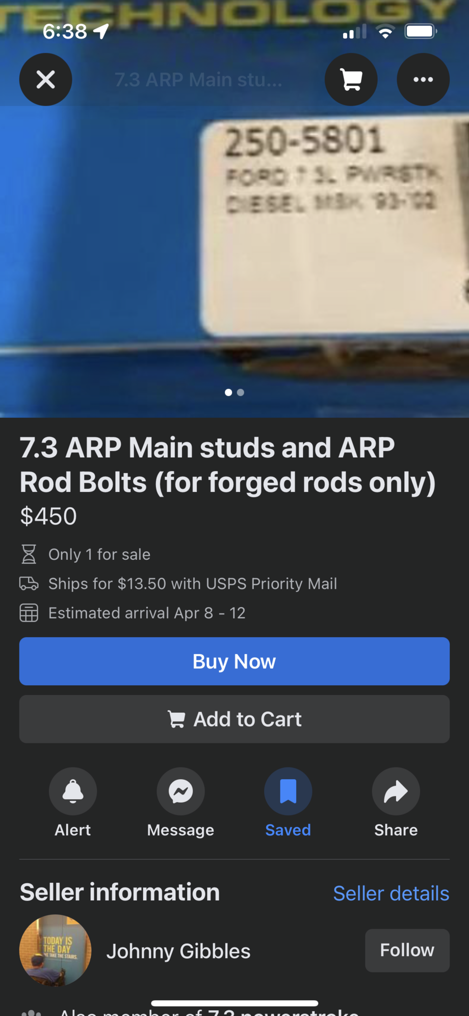

Didn’t know if you found rod bolts, seen these on market place just can’t figure out how to make it a link

@Jamon Norton , you see that button on the right that looks like an arrow? That is the "share" button. It should copy the link to your clipboard and/or prompt you to decide on what method to share it based on your device operating system. If there is a "copy to clipboard" option, do that. Then, come back here and long press in the reply text block and press "paste".

If that is FB Marketplace then it only allows you to share to other FB users or pages I think. FB is dumb that way. Also, beware of the plethora of scam artists on FB Marketplace.
Thanks a bunch for the heads up! I was a bit slow in getting to it so I currently am second in line if the other buyer flakes out tomorrow.
