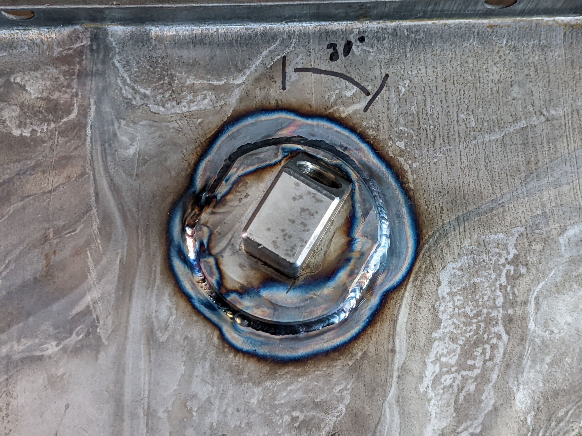

This is going to sound really stupid, but how do I clock the weld-in dipstick adapter? I sold off the "golden nugget" one I had, and the strip tank removed the marking I'd put on the oil-pan.

Pointed towards the front of the engine at about 2 o’clock.

What he said. And definitely not a stupid question, I had the same one when I took mine to have the adapter welded in and realized there were 2 notches in the factory piece.

The more vertical orientation (counterclockwise) is for the 95-97 pickups whereas the more forward orientation (clockwise) is for 99-03.
You sure it's 60 degrees (two o'clock)? That looks farther forward than I remember:
60 deg
One o'clock lines up more with what I remember n see online:
30 deg

I can grab pics of my pan in the morning with the adapter. I had the shop use the factory piece to figure out the clocking for the weld in.

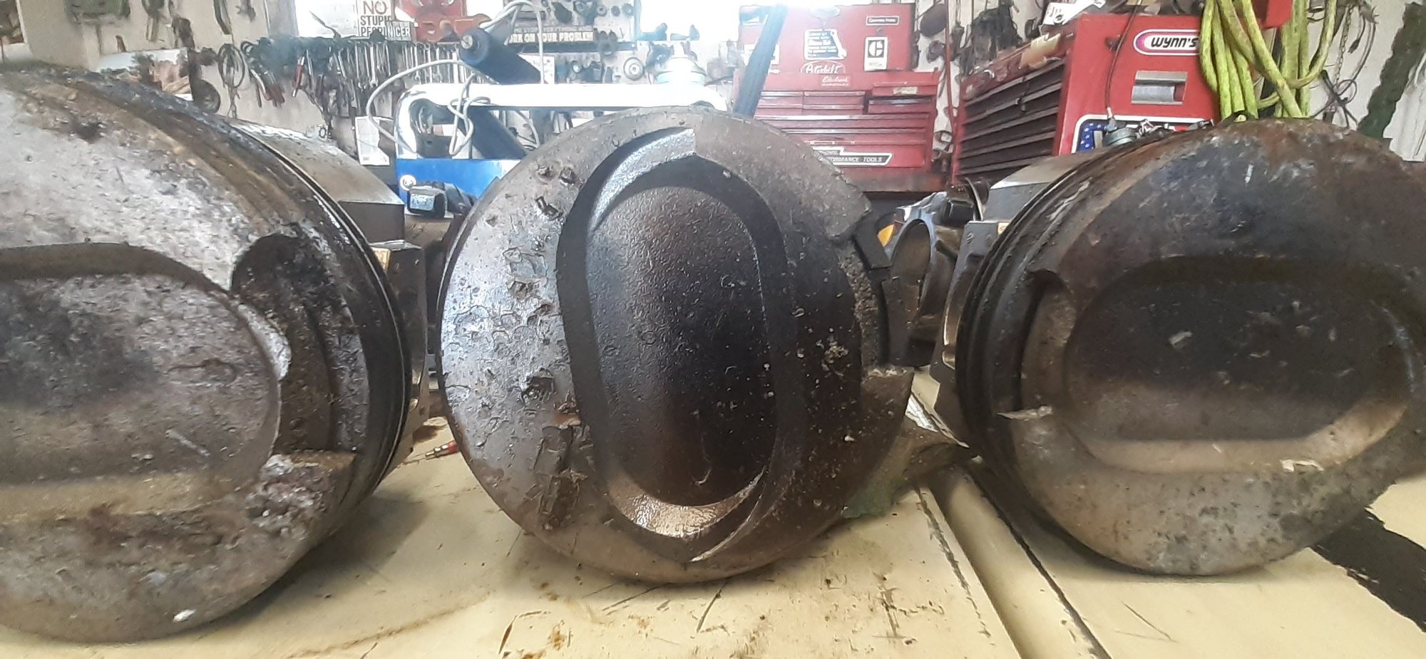

You don't want to take it back apart again because your pistons look like this before the first oil change:
These are from a 460 that didn't make it to the first oil change. It came from a big remanufacturer out of Spokane, WA. Mistakes happen but these rings were too tight by 0.010".
The ring end gap has less to do with the pistons themselves than it does with how far overbore the machine shop went for piston-to-wall clearance. It's easy to check while everything's apart and if they do need to be filed, the tools are readily available (ring file and feeler gauge). You don't need any special bore depth gauges...a piston with an oil ring in it works just fine to push the compression rings down.
That picture is definitely persuasive. I'll put the gap check on the to-do list. Will have to call total seal and see what specs they have for their 2nd ring.
Welder I went to primarily works on food grade stuff so he TIG'd it up all nice like.
Also had him put in a NPT flange for the Racor CCV drain. That port should be well above the oil line.
