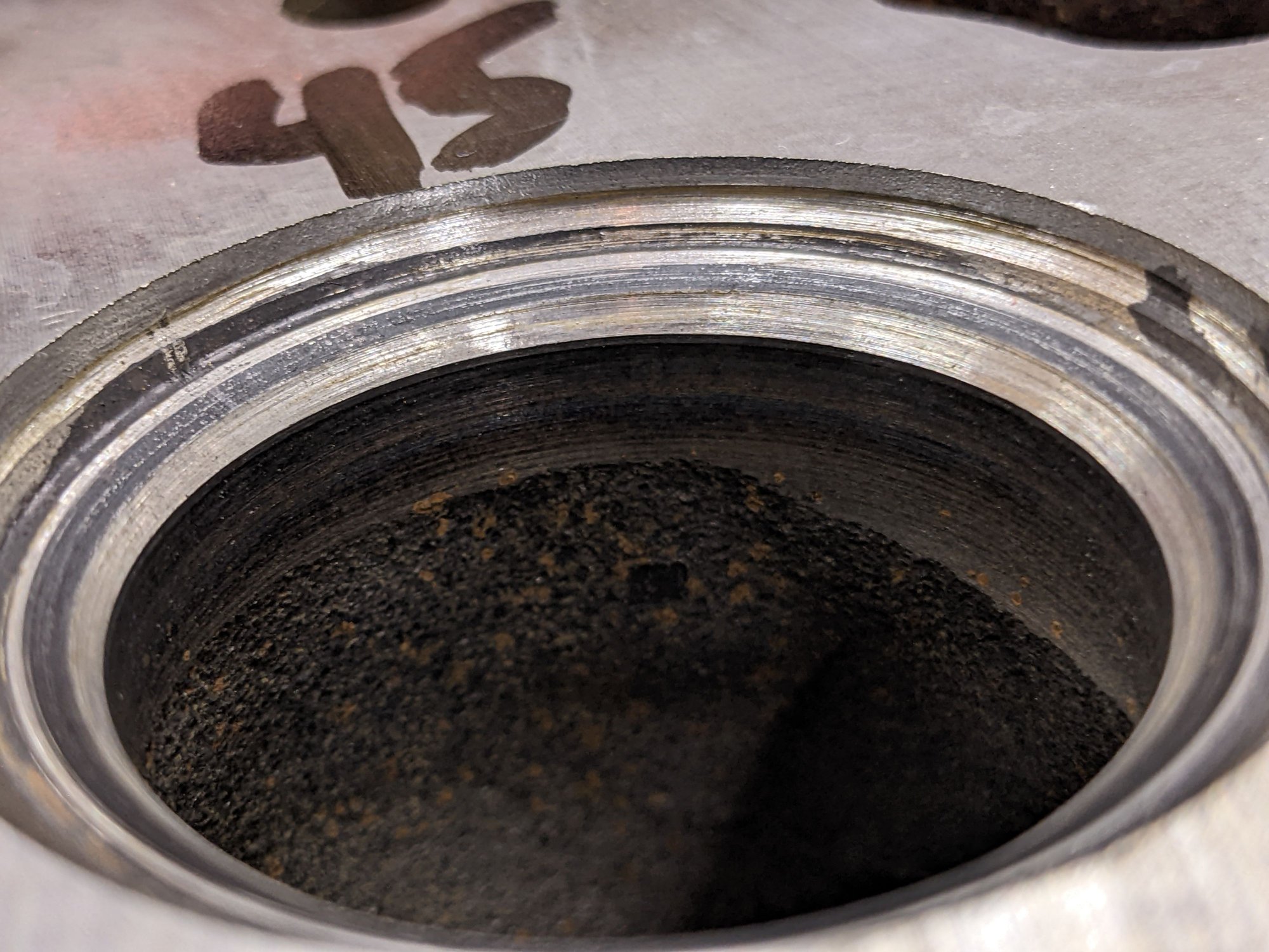

Assume this small scratch on the head shouldn't be an issue?
I bought valve seats for them to press in but I honestly cannot tell whether that was actually done.

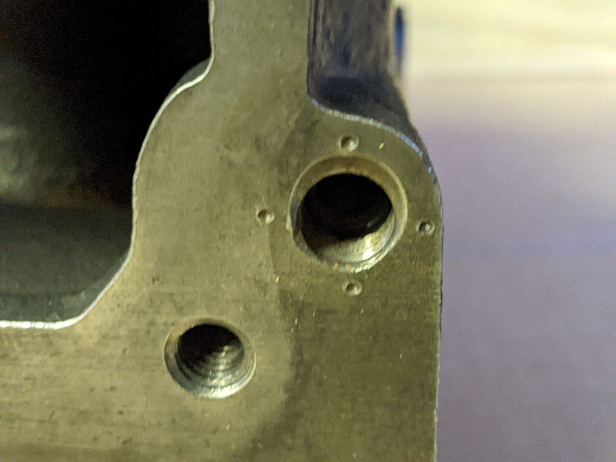

Anyone seen these markings before? They are on most of the high pressure oil rail ports, the fuel rail ports, the banjo bolt ports...

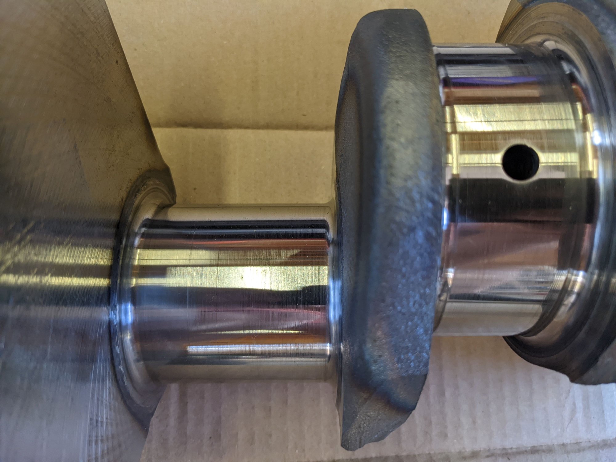

Am a bit concerned that the mallory weights were added radially instead of in to the side, if that's indeed what they are
Oh noes. You definitely have to do this and then face mill now.
I keed I keed.

That honestly looks horrible if you were supposed to get the heads completely redone, but I dont know what you exactly paid for, so take my comment with a grain of salt. That is absolutely NOT the way to balance a crank when adding weight. The mallory (heavy metal) is supposed to be installed the way you said and pressed in with along with a small tig weld stitch for safe measure. The journals on the crank dont even look like they polished them.

Head w/valves
Example of surface finish
Exhaust manifold surface not touched it looks like

Better view of the weights (these are the only two)
Better shot of journals

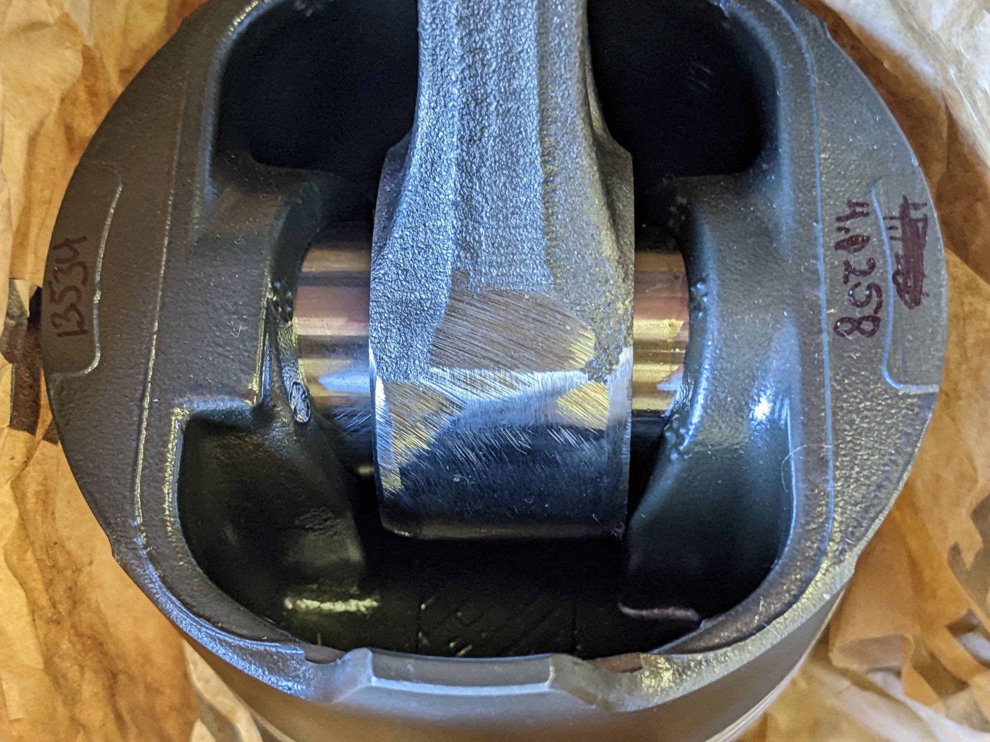

Rod balance on top
On bottom
What the journals looked like when the crank came out, for comparison
