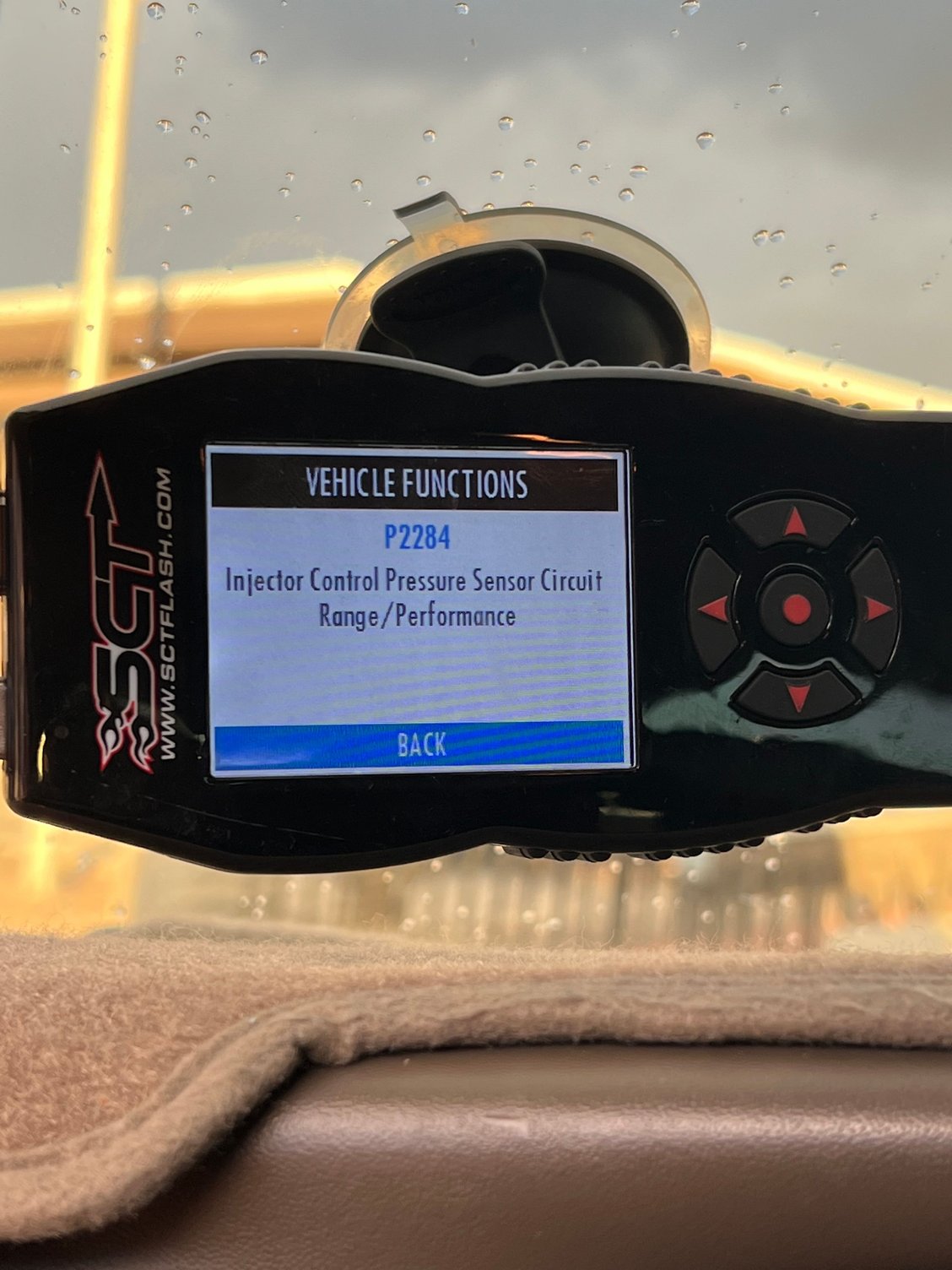

Does anyone have guidance on troubleshooting the P2284 code? I’m imaging at some point the PCM compared the desired PSI and the actual PSi and there was a discrepancy. Probably when the truck was acting up over my last road trip.
IPR sticking when hot?
ICP giving bogus data?

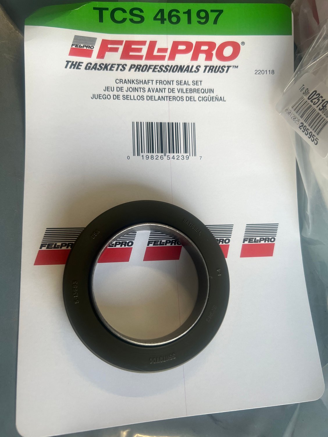

New front main seal going in to stop the leak. BIG THANKS to toomanytoys for letting me borrow his seal Installation tool. What’s interesting is this ‘felpro’ seal says National on it.

Both National and Fel-Pro (and my old division) were part of the Federal-Mogul group, now Tenneco. I was not sure that Fel-Pro privately labeled National's product. National was the factory supplier to International.
Glad it helped!

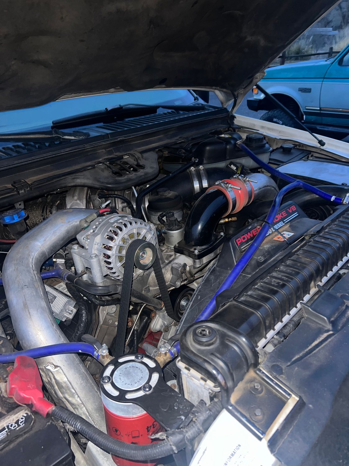

6.0 humming along pretty good since the overhaul. Could use a good cleaning along with a new fan shroud

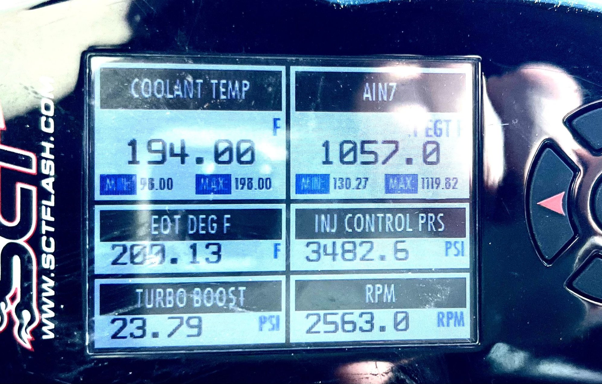

Pulling about 6,000lbs up a steep climb. EGTs are very happy when you keep the RPMs and boost up. Had a pretty nice ECT/EOT split of 6-10 degrees the entire 500 mile trip.
