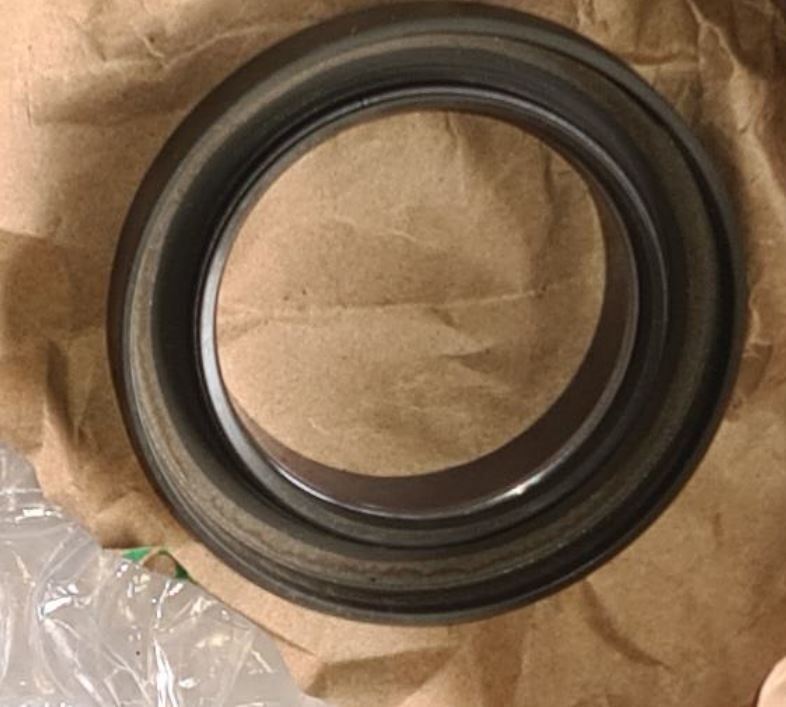

I was just wondering. Is it only the rear main seal sleeve that needs the addition of the Loctite compound to the crankshaft?
The newer sleeves have a red coating on the inside. I have never added an additional sealant.

Rear seal do not, they have the sealer on the ID. The front wear sleeves need Loctite as a sealing agent, and all the instructions I’ve seen say to not separate the seal and sleeve, put them on as a pair.

The Ford front main seal sleeves I install, have a (brown) coating, too.
coating on the rear main seal "sleeve" is red (one the ones I have)

I knew that you were not to separate the seal from the sleeve. It's nice to see that they have added compound to both of the seal-savers.
Maybe the OP might want to clean the crank end and use the Loctite compound on it, if after inspection he does not find any sealant.
On second thought, I wonder if adding Loctite to it on top of the coating will cause any issues.
