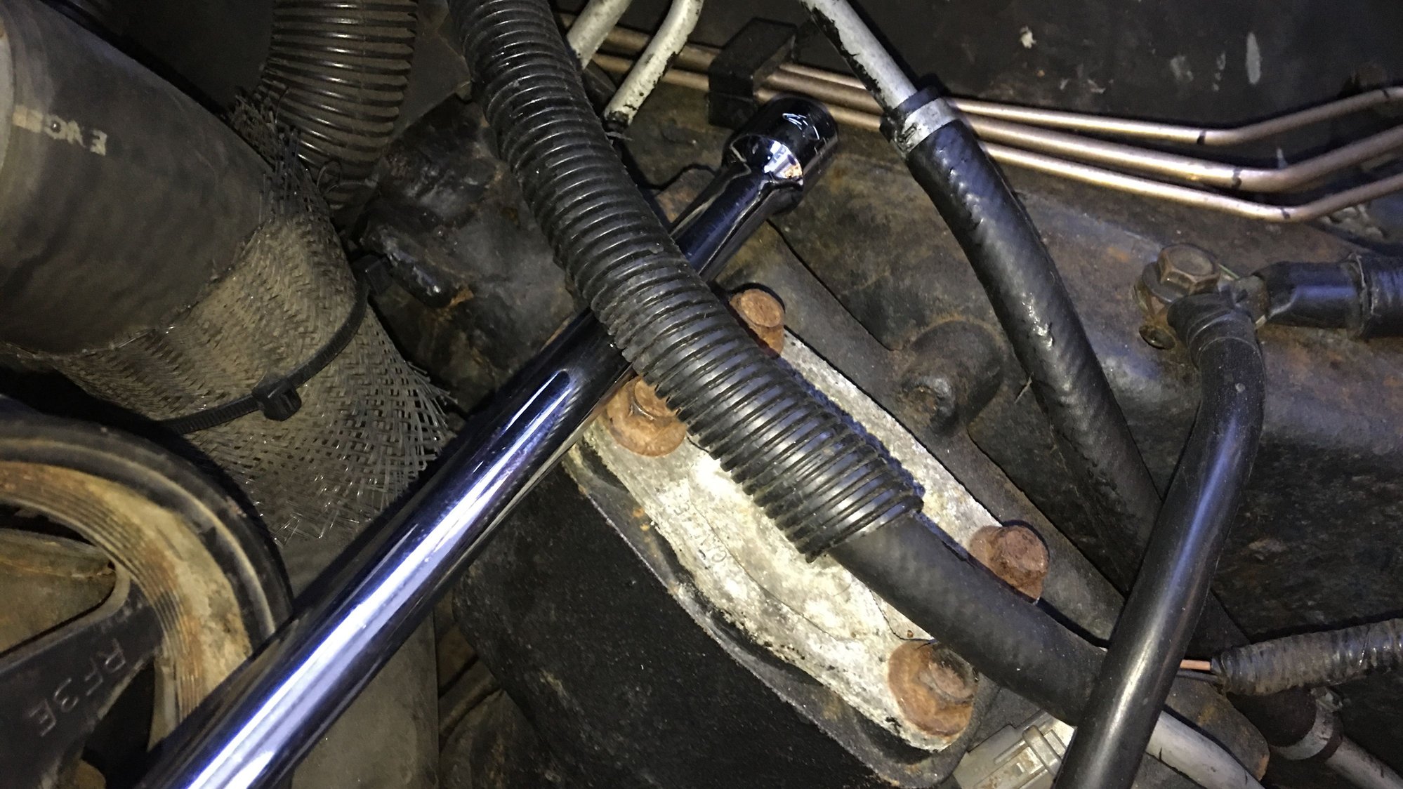

The manual says 50lb-ft then 90º.
You could do the 50lb-ft, mark the bolt heads, then slow walk the bolts to 90º with an impact. The 90º rotation makes it hard to keep the crank from rotating. Even at the 90lb-ft of the ARP bolts the crank walks.
Yeah I would need to somehow keep the engine from rotating. Maybe pull the inspection cover on the transmission and try to get something to lock up the flex plate? I’m not too worried but it would be good to torque these to spec. Hopefully I didn’t over stretch them

There are tools for those work. KS tools 1503152 for example.
This is the tool I use. If you search for it on Google, you will certainly find a tool that is available in the US.

Man, I'm surprised there's a strap wrench that would hold up for that, but German ones must be strong. Typically, I think of strap wrenches for filters.
SRMastertech has a video where he states you can wedge the flywheel to the bell housing or use a 15 deep socket to jam the torque converter nut against the bell housing, maybe the lower opening. I've used two of the 10mm threaded holes and run a pry bar across them to hold the pulley; I was worried about the rubber bond of the dampener.
Over here, we have two strap wrenches that might work, but I've never heard of them being used for this on a 6.0.

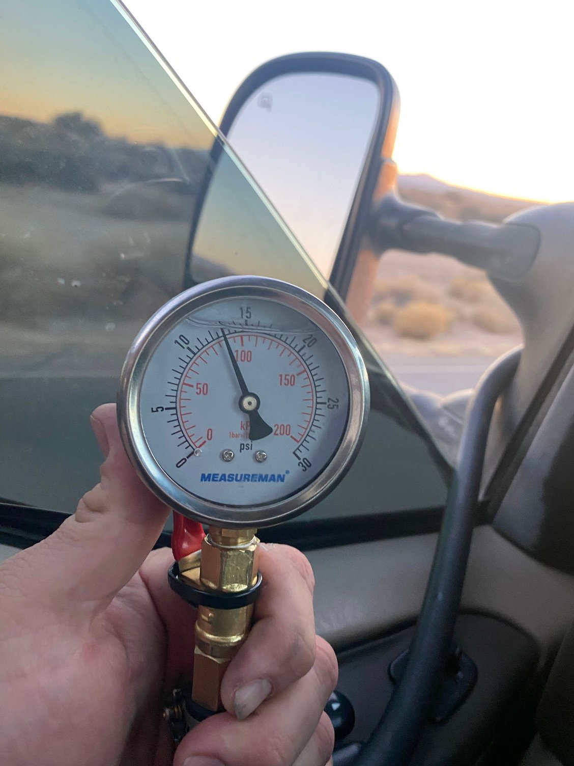

Jack you and bismic had suspicions that are right! I got to thinking about the combustion gas theory and did some testing. My head gaskets are compromised. I don’t see the issue unless under heavy load and throttle but it’s there. I can literally see the needle more with the torque curve which probably correlates to peak pressures. There’s a spot around 1500-1900 where I pay into the throttle and the needle creeps up. I couldn’t hit 16 psi but I bet on a steep grade I could. Bummer. guess it’s O ring heads and studs time.
I had coolant from 192-196f nowhere near close enough to cause thermal expansion to the level off building excessive pressure.
Crap! 250,000 mile on stock head bolts. She’s throwing in the towel. Crazy how you can drive around on bad gaskets and not know it around town
https://www.amazon.com/GearWrench-25...00RH4HK0&psc=1
https://www.amazon.com/OTC-7206-Mult...ustomerReviews
I change from TTY to the ARP bolts for in-frame, as they only require 90lb-ft.
Wedgies, but never used them.
https://www.amazon.com/OTC-6665-Timi.../dp/B07ZRNXF9T
I've not seen anyone recommend a tool like this for the 6.0, but I've got a cost request to my steel supplier to see what he would charge me to laser cut flat stock specifically for the 6.0. I mentioned making a spanner wrench to hold the damper in my not published video for the front cover install.
Jack, if I may give you some advice, make a tool that you can use for other HD applications. I built this tool many years ago and have been able to use it many times for different applications.

I will just say that although I didn't have a "leak" like you initially did, I do have a somewhat similar issue going on when boost increases in my 2005 6.0.
You can read more about my issue by following the link below but basically, if I'm towing something and I'm in a lower gear where I'm not needing to let boost get above 17 or 18 PSI, my coolant is fine and I don't have any issues with coolant loss. But, if I just try to give it a little too much accelerator pedal in a higher gear and create too much boost (over 17 or 18 PSI), I'll have coolant puked all over the battery area. (Not good obviously)
I'm trying to learn more about the 6.0 and getting help here myself so you can disregard what I'm about to suggest or take it for what it's worth but I'll just say that if you're going to even bother to do a head and/or head gasket repair, I don't think I would recommend doing one while reusing the old heads or getting remanufactured heads.
To me, taking a chance on using the old heads is probably just a big waste of time and money and also just asking for problems ahead.

I'm not sure if your truck is having an issue with coolant puking out at a lower PSI or not but you can adjust the alarms or warnings in the Torque Pro app however you want so they will go off at certain readings.
