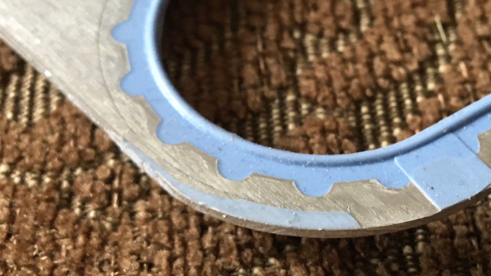

That angle gives a better view of what there is. I thought the port had more erosion, into the gasket seal, which compromised the sealing surface more than I what I see there.
A very good RTV might seal and bond that, and maybe that's all you need. I would prefer filling the pits of corrosion, and letting the sealant on the front cover gasket be in full compression. That would mean taking some epoxy and with a straight edge of steel, wipe the epoxy across the pits. When dry, do some light sanding backed with something flat to level the epoxy.

That might be the really good RTV. Now we're kicking in my old career work. I'll try to explain better.
First, I find this situation unique and interesting. When you look at the surface closely, it corroded at the juncture of the silicone of the gasket in contact with the block - almost as though the silicone was corrosive, but that wasn't the reason. You have block areas inside the silicone contact that did not erode (mostly).
There are two areas where corrosion has developed channels, opening up the space under the actual seal of the gasket, compromising the seal, and where the leak was occurring. And it's at the top where combustions gasses would travel, although going along with the flow of coolant. Shut down; gases would collect there.
The erosion you mostly see is on the outside of the actual seal, in the area of the silicone that is recessed from silicone shrinkage when the gasket is made. These areas would have collected the leaking coolant and corroded secondarily, the initial primary loss of the seal was elsewhere.
As the erosion occurred, the compressive force under the silicone would diminish. And that is why I worry about using a compressive RTV to fill the pits. You are taking more of a chance due to the lower compressive force because the added flowable silicone would be displaced to some degree. It also won't bond well to the existing silicone of the gasket.
Now, you could still use the silicone and draw a blade over the surface to level it, then let it dry, so when the silicone-faced gasket is laid over it and compressed, the hardened silicone would create more resistance and obtain a higher compressive force. But silicone still gives; it's still compressible, it shrinks when drying, unlike the iron surface it normally interfaces against. You can see the srinking of the silicone in the images of the gasket, matching the interlock pattern cut into the aluminum to hold the silicone. I used to work with silicone often when I worked in the carbon fiber industry, using the silicone in molds.
For me, I'd rather spend the extra time and use epoxy to restore the surface to its expected height, and the silicone of the gasket has higher compression, where the arrows are is my main concern.
But that's me. And I've been known to overthink problems.
