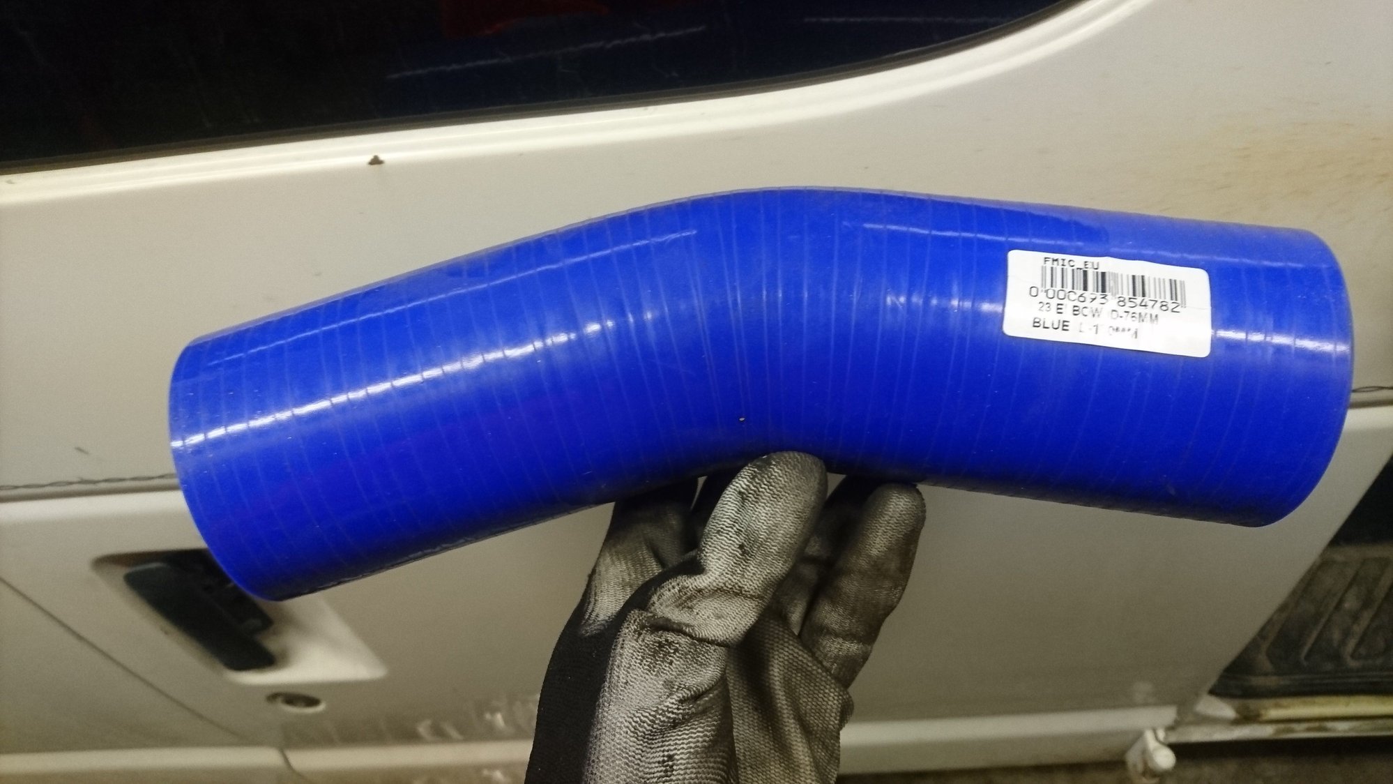

Should I perform the modification with a connector as shown? Or should I cut a proper plug, weld it in, sand it smooth and make it look like the pipe was made that way all along?

I'm with Dan on this one. If you have the tools and skill to make it look like it was made that way, do it.

Okay. It looks like I have to get me a 60° elbow.
