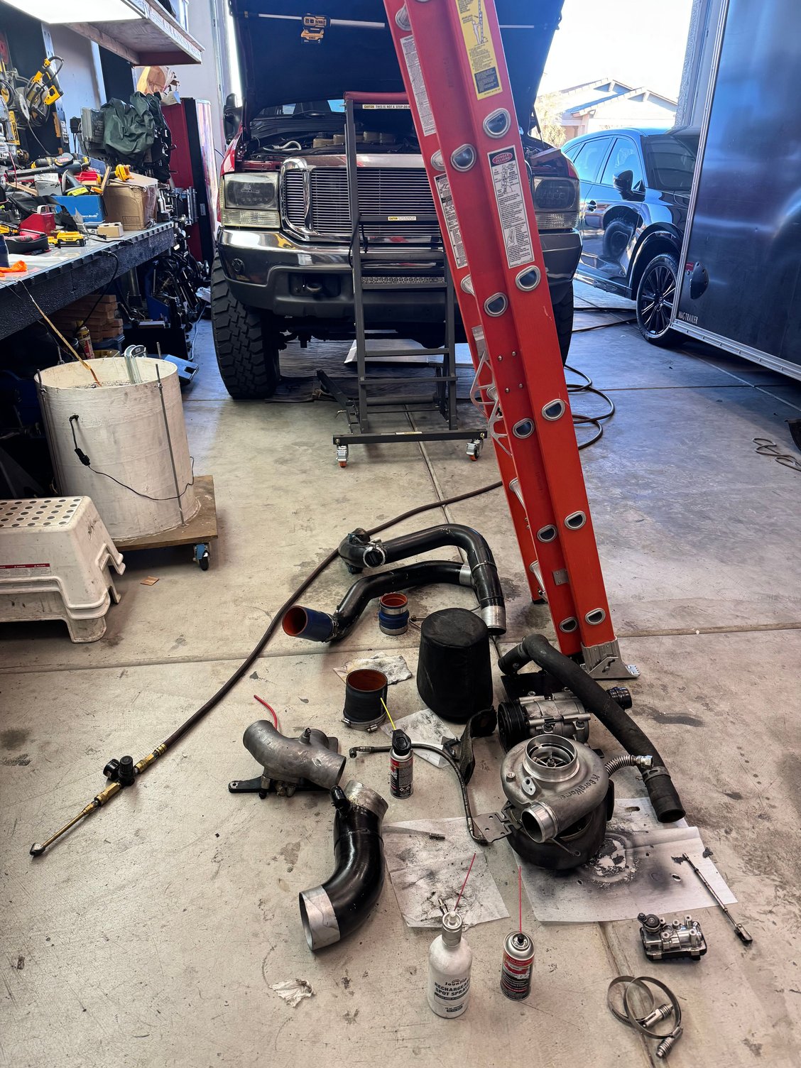

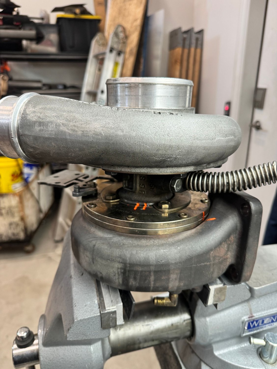

The turbocharger is relubricated and back together.

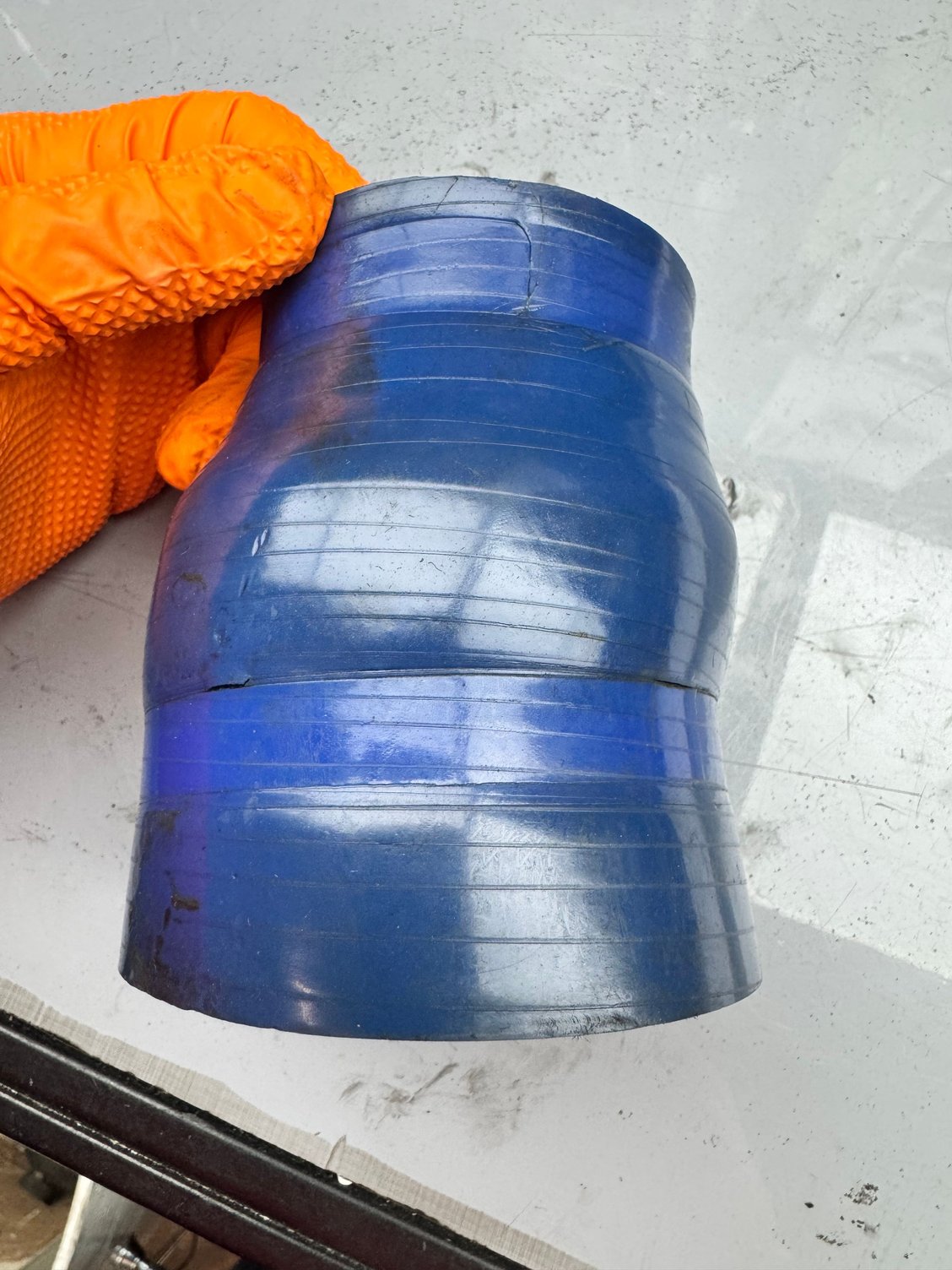

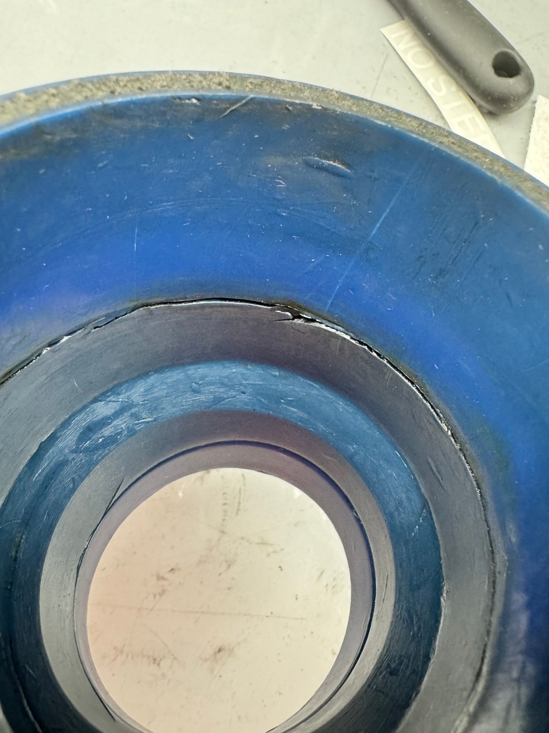

It’s a good thing I took things apart when I did. My transition boot from the turbo to the CAC tube is on the verge of catastrophic failure.
Outside
Outside
Inside
Inside

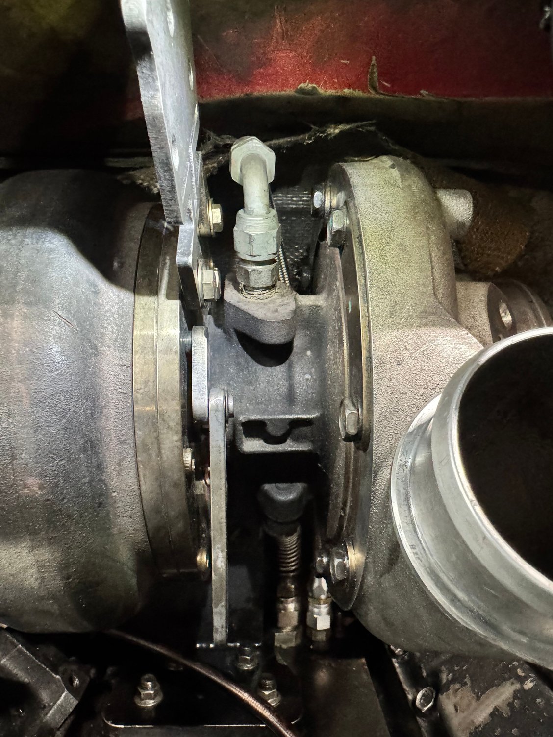

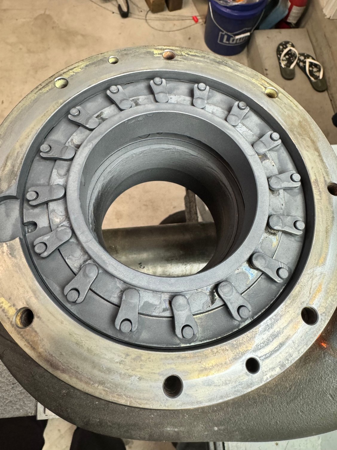

Well, the truck is mostly put back together. Now waiting on turbo to CAC pipe transition boot. Giving Wehrli a try.
https://www.wcfab.com/i-30589930-2-5-x-3-silicone-boot.html?q=WCF203-26
Wehrli steel-reinforced 2.5" to 3" silicone boot.
All the bits and pieces cleaned up and ready to go back in at the start of Saturday morning.
Replacement pedestal quad/x-seals in place.

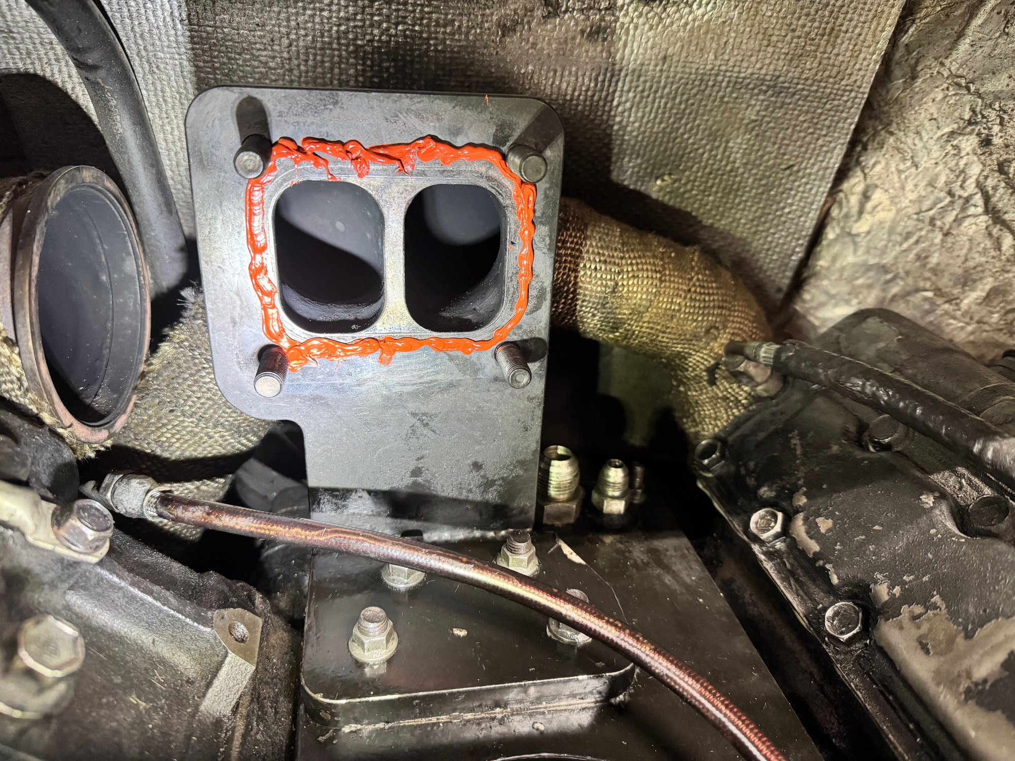

The high-temperature gasket maker worked so well in the race car, I decided to use it on the truck too.
The high-temperature gasket maker worked so well in the race car, I decided to use it on the truck too. This is the bead on the T4 flange before the steel gasket went on. There was another bead after the gasket went on too.

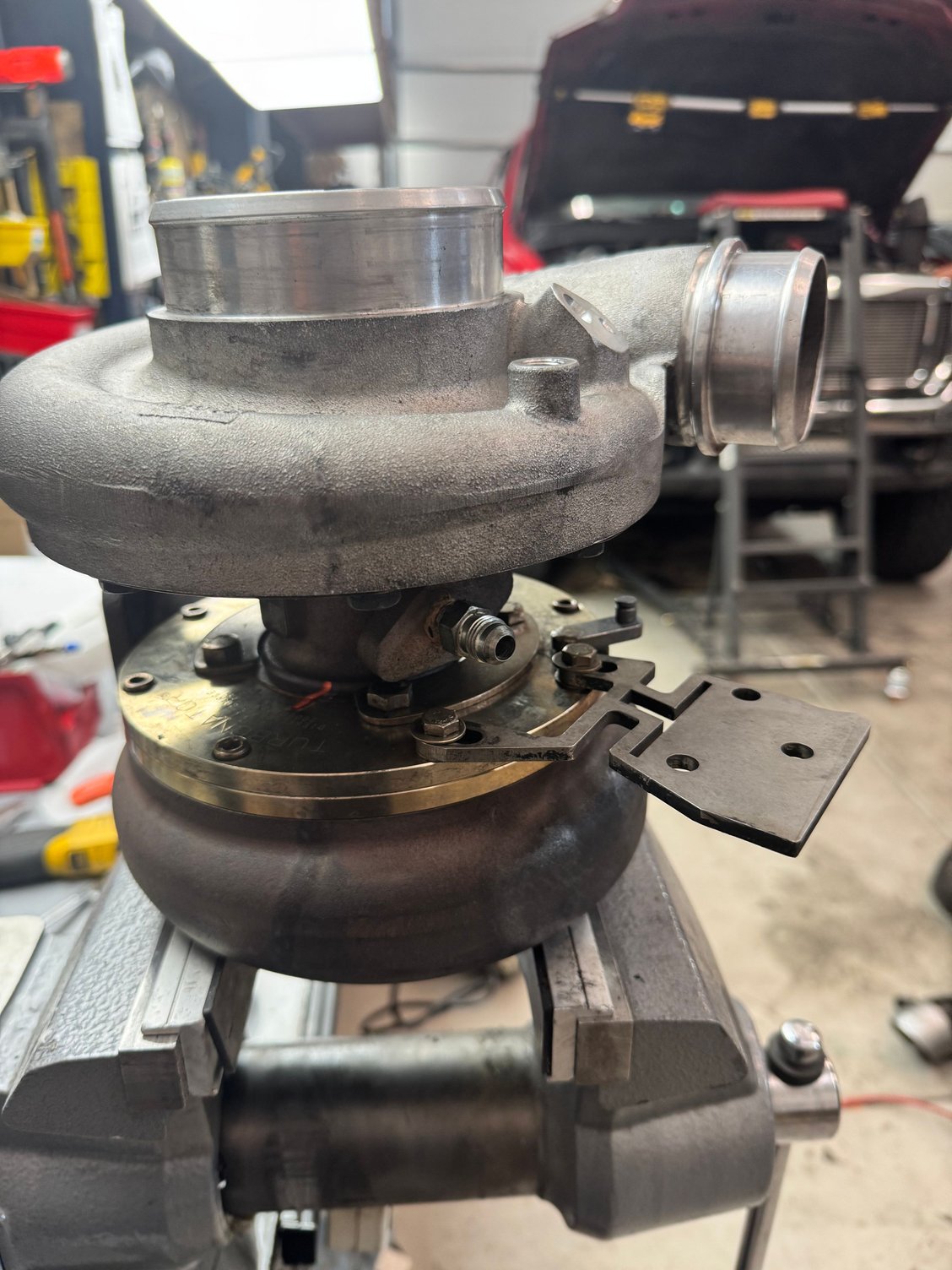

Fabricated a new, slightly shorter turbo oil supply line so I can route it behind the turbo.
New line installed. In case you are wondering why that 90 degree fitting looks used, that is because it is. It was previously situated at the outlet of the OBA compressor. Thats the beauty of resuable fittings.
New line installed. In case you are wondering why that 90 degree fitting looks used, that is because it is. It was previously situated at the outlet of the OBA compressor. That's the beauty of resuable fittings.

What did you use to clean that. Came out pretty good. Ultrasonic id imagine would work well.
Old Feb 22, 2026 | 11:52 AM
  #1251
FordTruckNoob's Avatar
FordTruckNoob
Joined: Jan 2005
Posts: 13,135
Likes: 4,732
From: Henderson, NV
A 5-gal pail ( @Wes444 ) full of 1:4 Simple Green. Parts left to soak in it overnight.

The transition boot, which was the last part I needed to complete the job, finally showed up and the truck is back in action.
Old boot on the left, new on the right.

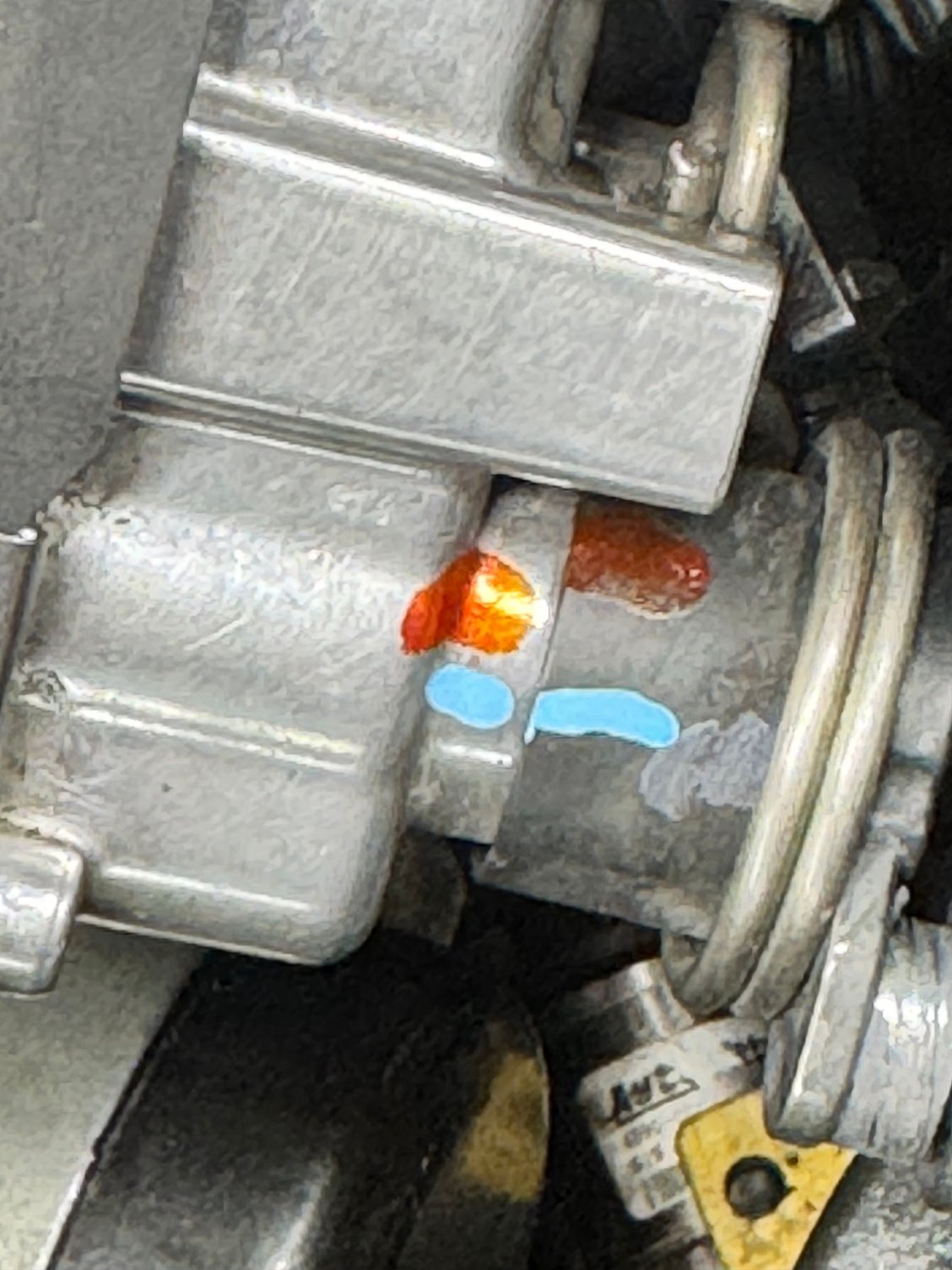

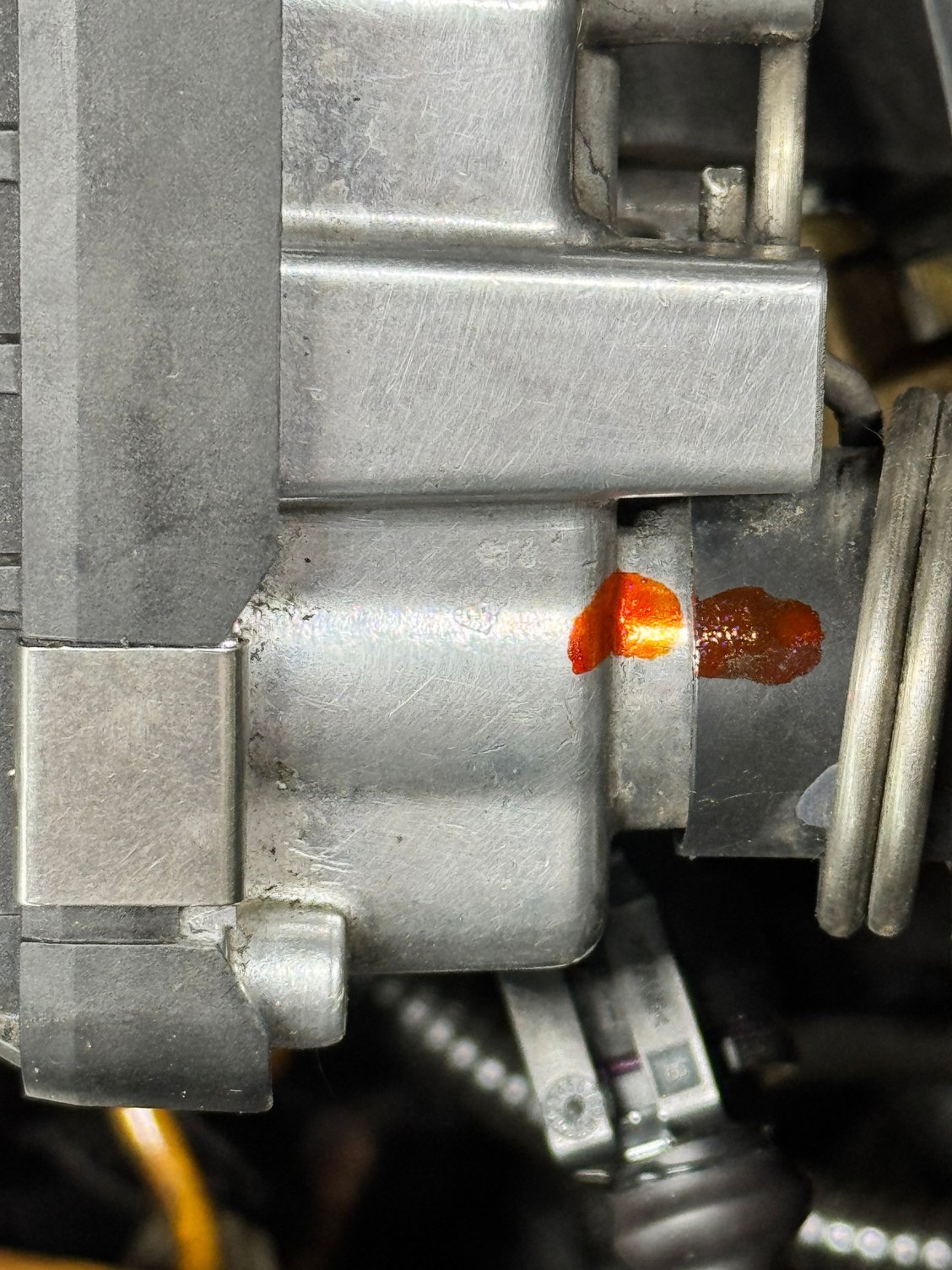

Had lingering excess EBP issue at boundary condition. Turns out I had to recalibrate the VGT REA position.
Orange = pre power-up
Blue = post power-up
Green = exhaust brake
