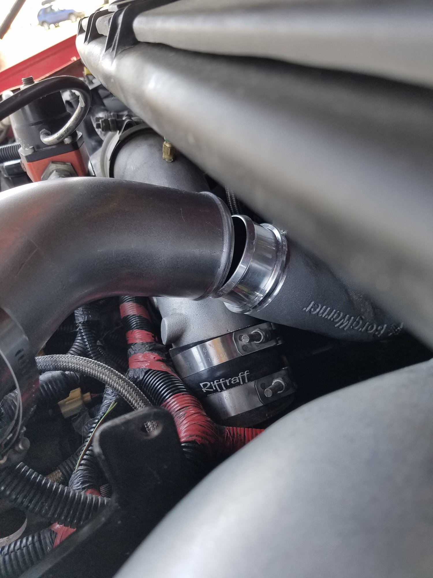

I had the opportunity to work on the CAC tube on my CSD T4 install. I did not like the angle at which the CAC tube entered the turbo outlet....and I have had trouble keeping the boot on. This was one of those "Why did I cut that?" But, I prevailed.
Before
Initial install of the CSD pipe.
After
After a little time with a cut-off wheel and a MIG.

Good work!

@Sous ..you encounter same angle?
Dan..I know nothing of these turbos, but can't they be "clocked"
You can only "clock" it down until the turbo outlet touches the Y-pipe.

What process and what filler did you use?
I used a 110volt Hobart 140 Handler MIG....024 solid wire with C25 shielding gas.
Well then I would say you did pretty good. Hard to mig that thin stuff and make it pretty. Is that just mild steel?
It appears to be aluminized tubing...like exhaust tubing. I had to fill some 1/4" gaps on one side....worked fine. The little Hobart does a nice job at low amperage...better than my 250amp L-Tec...with .035 wire.
The stock CAC tubes are HEAVILY aluminized and there is really no way to make them look good when welding. Some trucks came with actual aluminum piping - I have a set of those things in the shed and another set on the '73 7.3 but obviously the aluminized steel is cheaper to manufacture so there are more of those floating around. The CAC pipes I made for the '95 were really fun. I joined that aluminized tubing to stainless steel sections of stock downpipe! That was a real treat.
Yours, being "like exhaust tubing" shouldn't have been too bad to cut and splice.
