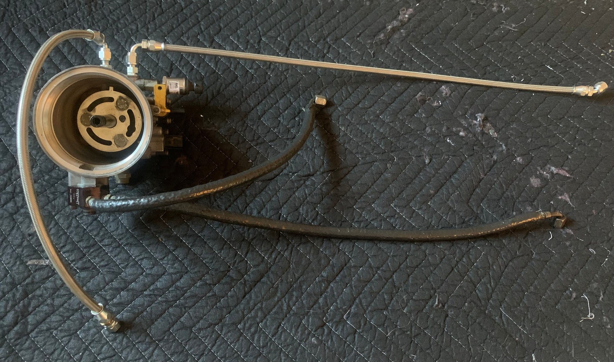

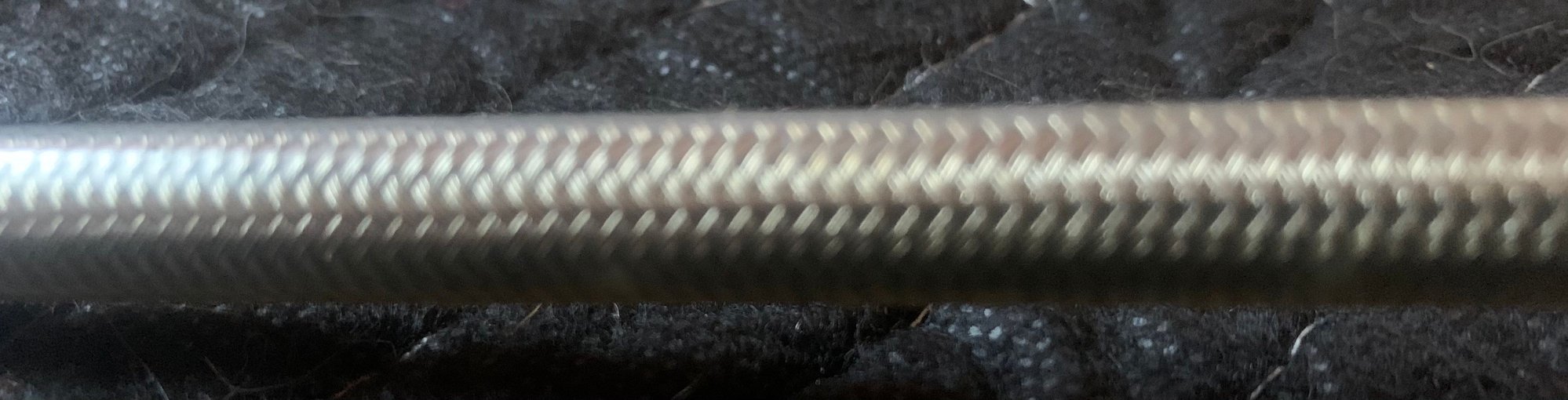

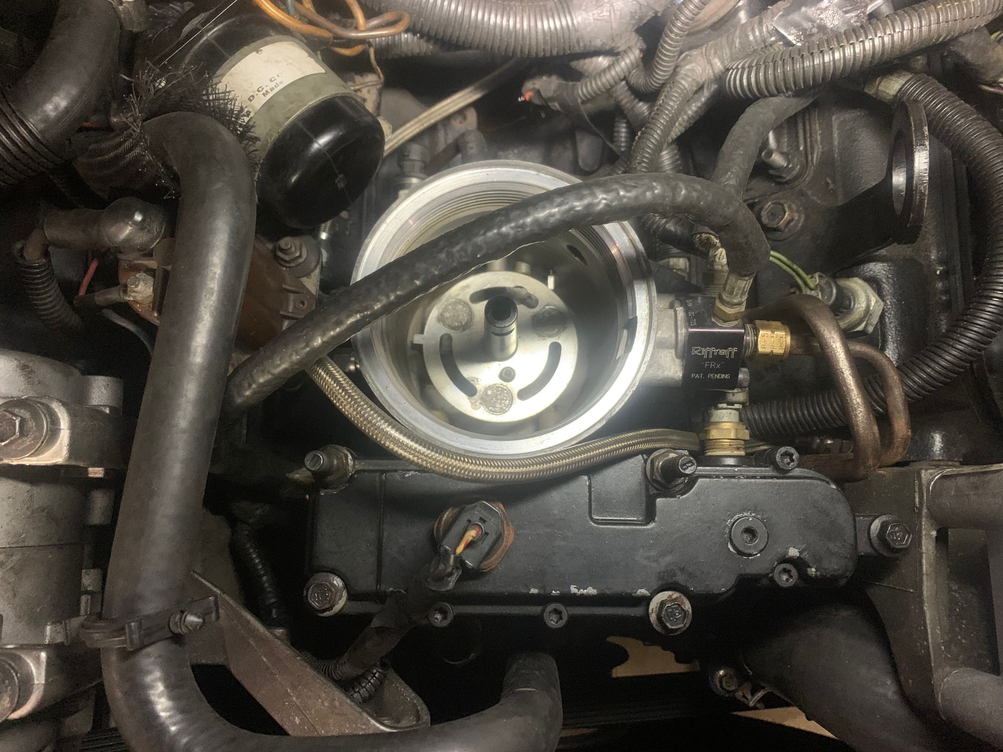

I decided to modify the fuel bowl to use JIC fittings instead of the Parker Vibra Loks and SS braided teflon lline in place of the factory hardlines.
Newly configured fuel bowl.
Closeup of 1/8 NPT to -04 JIC adapters with hoses attached.
SS Braided teflon hose covered in clear vinyl for abrasion protection.

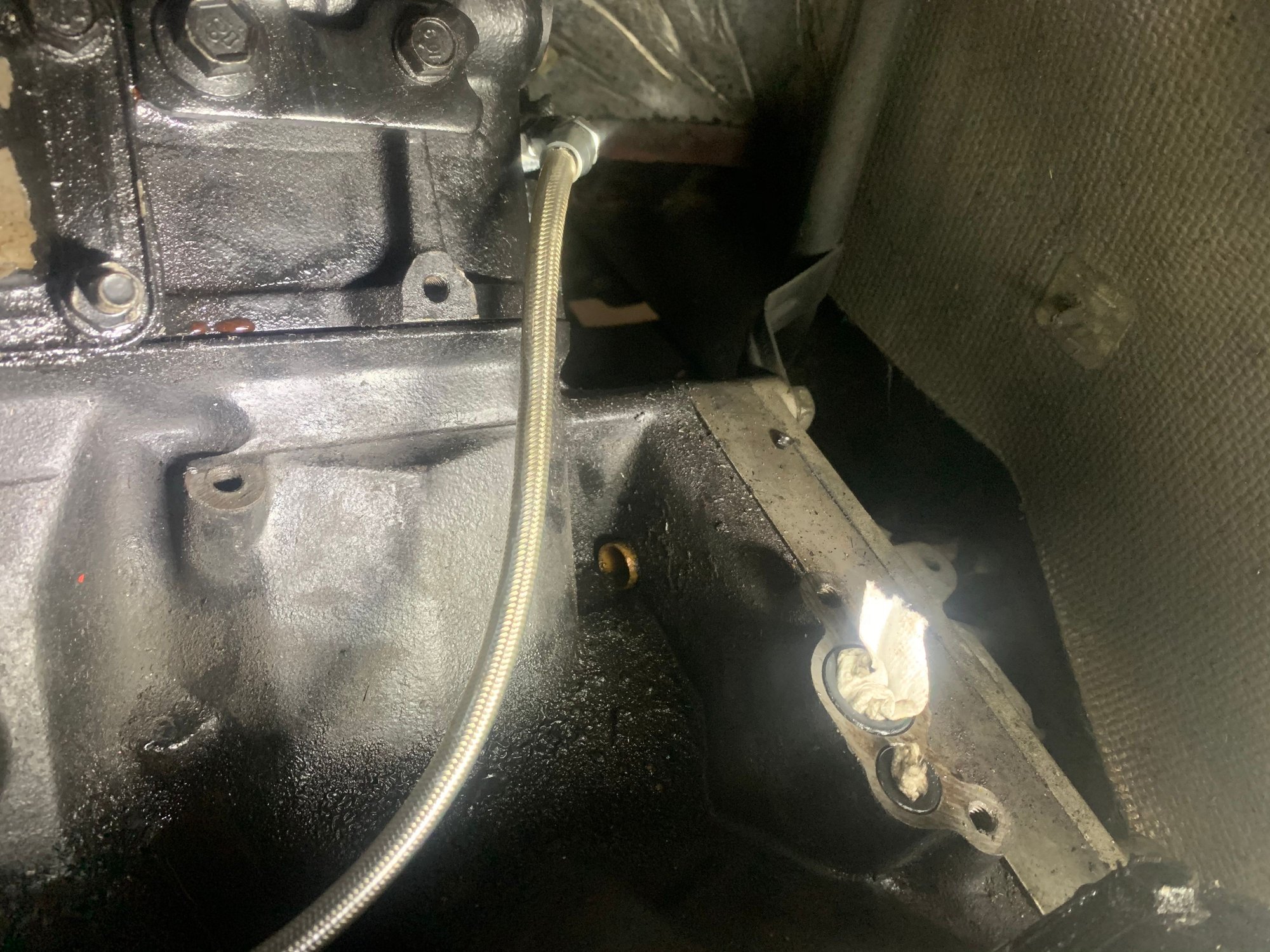

Passenger side fuel line
Passenger fuel line on the left, FRx return on the right.

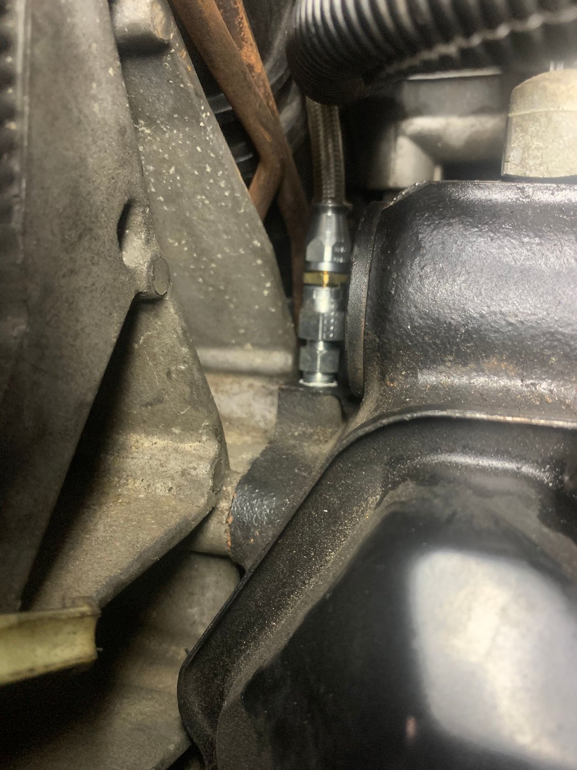

Closeup of adapter and hose end on driver side head.
Fuel bowl reinstalled.
Closeup of adapters and hose ends where factory hard lines used to connect. The other FRx return in foreground.

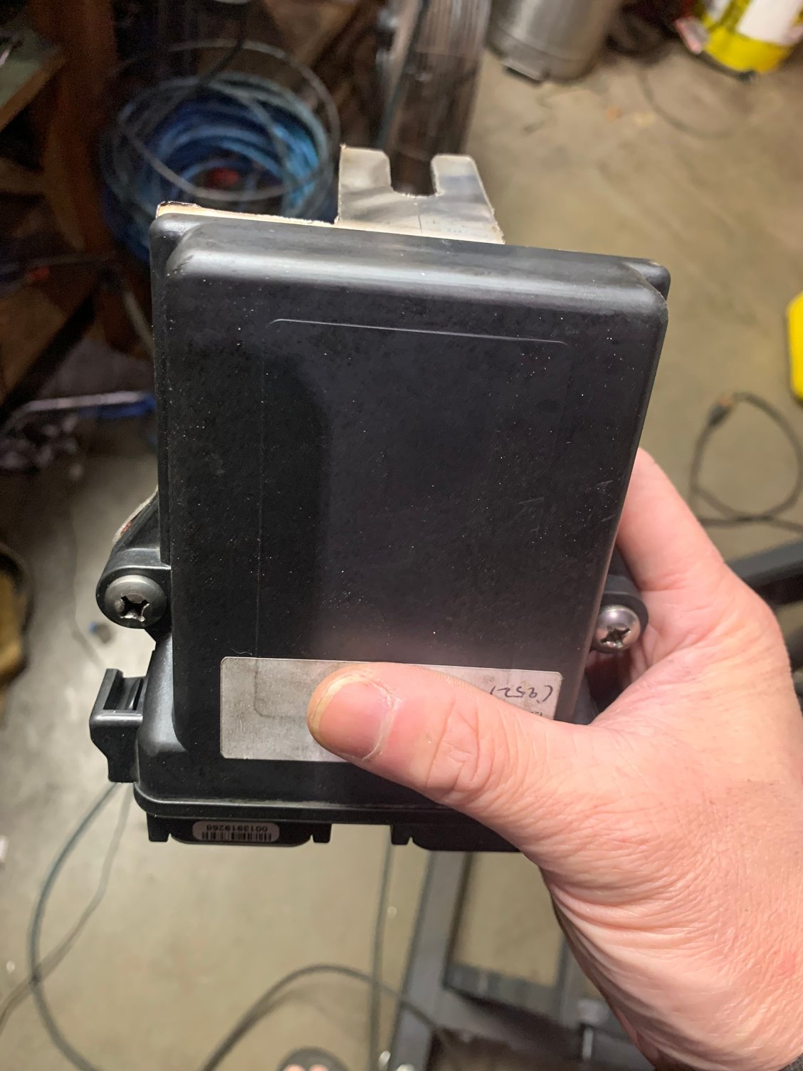

Okay I decided to mount the control module inside the cab instead.
I had to enlarge the hole where the wires pass through th firewall.
Turbonator power relay now mounted where the Control Module used to be.
I have to find some way to stow all of this cable neatly.
The cable for the Turbonator exhaust housing to the control module is relatively short. I have to mount the Control Module close to the steering column. This is the mounting bracket I fabricated to get the job done.
Control Module mounted to bracket.

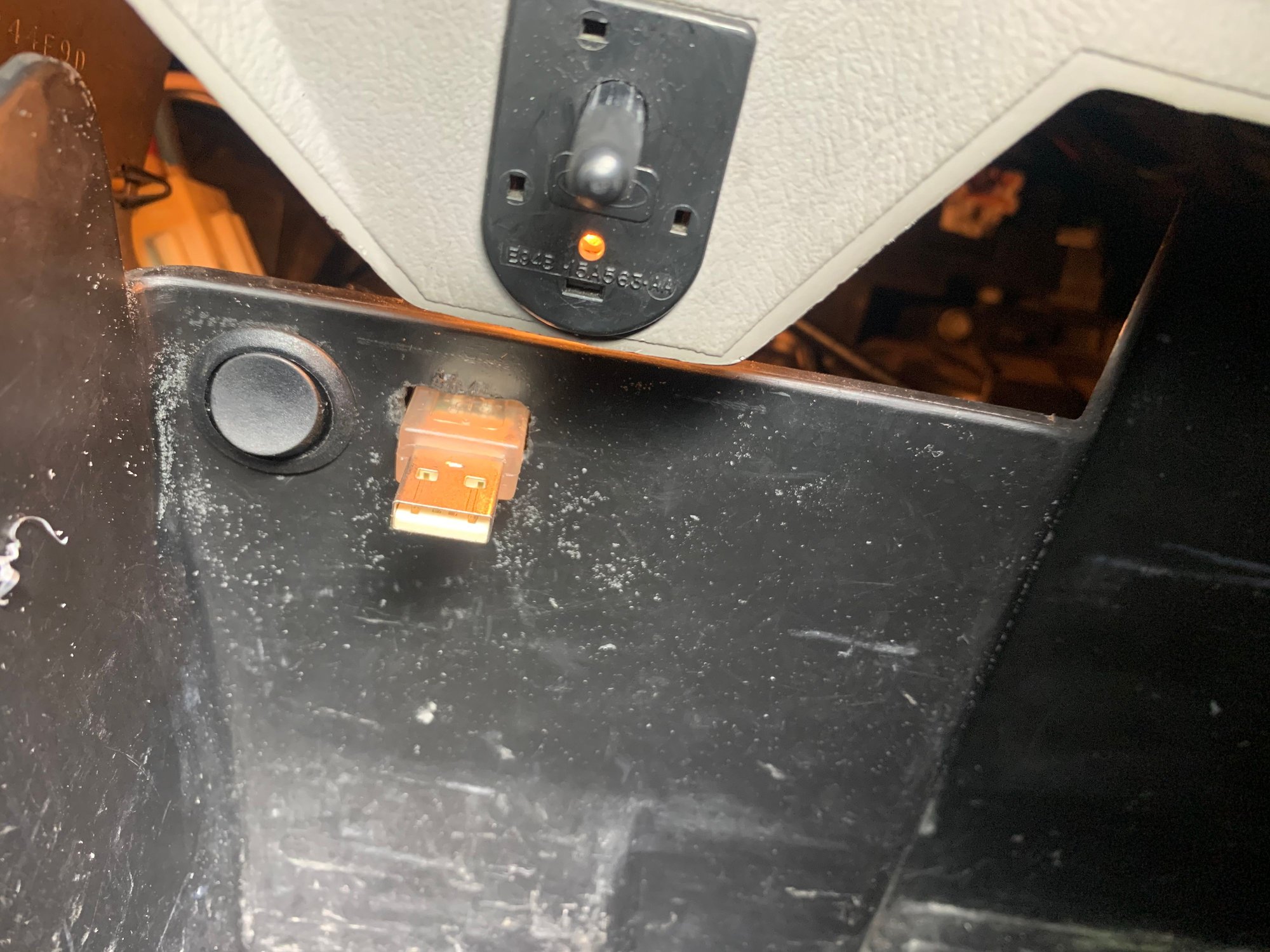

Turbonator electronics are installed.
EBPV signal to Turbonator exhaust brake trigger.
Turbonator exhaust brake defeat switch and data port in glove compartment.
Turbonator control module mounted next to steering column. Cables are still loose and will stay that way until the mechanical components are installed and plugged in, i.e. the vane actuator, and boost & drive pressure sensors.

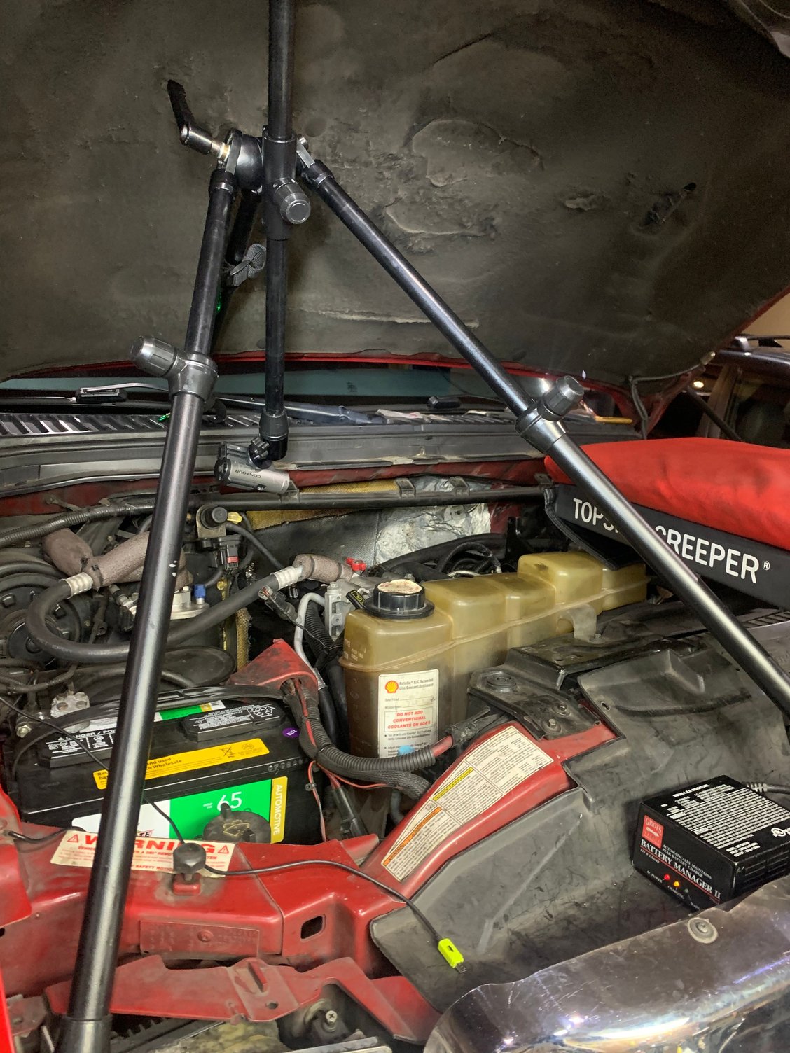

Slow but steady progress.

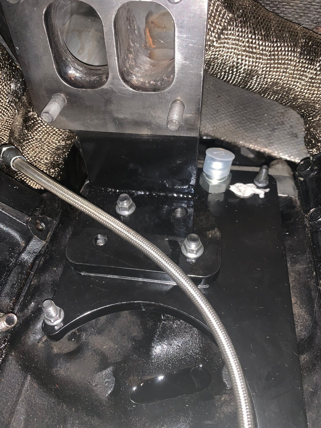

CSD bits with stud conversions went in easily enough.
Downpipe mockup per RacinJaonWV's instructions went well. No massaging of the downpipe needed.
Although it did fall short of reaching the rest of the exhaust.
The cowl will have to be massaged to accommodate the Turbonator's actuator though.
With the mockup complete, pedestal plate studs were red loctitited in place and quad seals were put in place.
Pedestal plate fastened in place.
