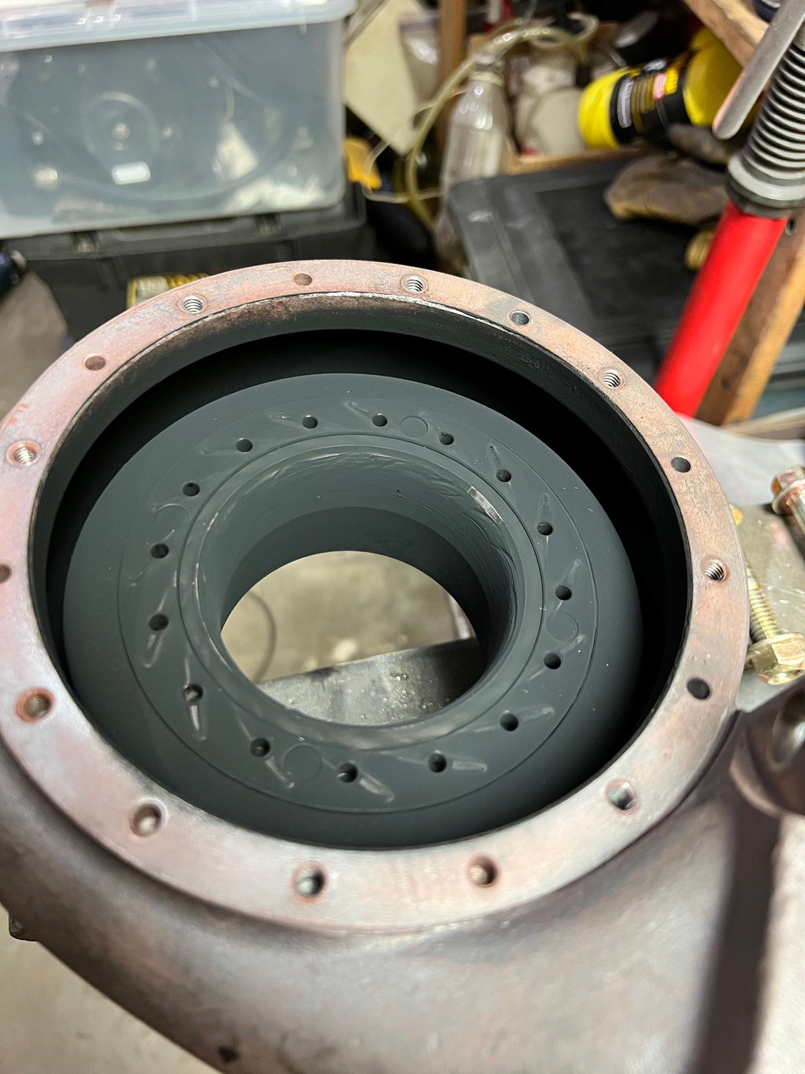

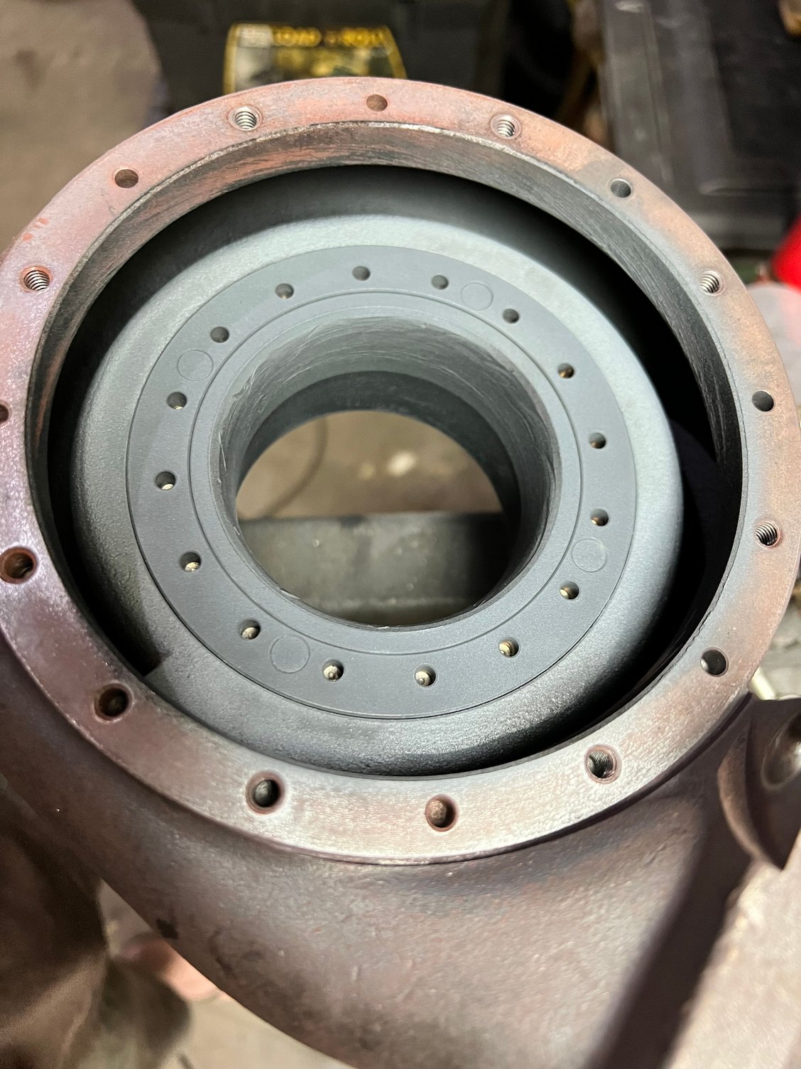

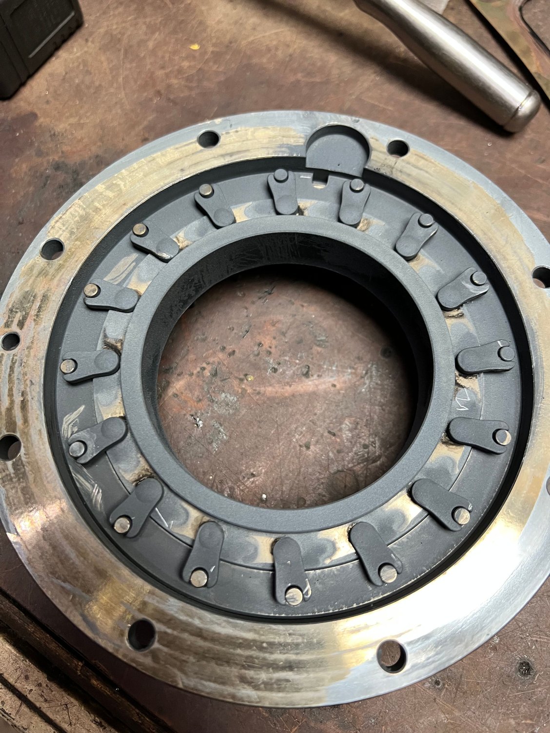

Took the Turbonator apart today for inspection after about 3 months of trouble-free (knock on wood) operation with the new unison ring. Soot contamination was about as expected but distributed in an unexpected fashion. I expected the groove that the unison ring sits in to be full of soot but it was not. Only the surface of the faceplate covering the unison ring chamber was covered in soot. I also discovered the holes that the vanes' axles rotate in on the other end is actually a donut of stainless steel set into the cast iron housing.
After cleaning all the soot off I sprayed any surfaces that see movement with the tungsten disulfide dry lube. It made all the parts look sooty again but with a much lighter gray.
Pictures before cleaning:
Pictures after cleaning and lubing:
